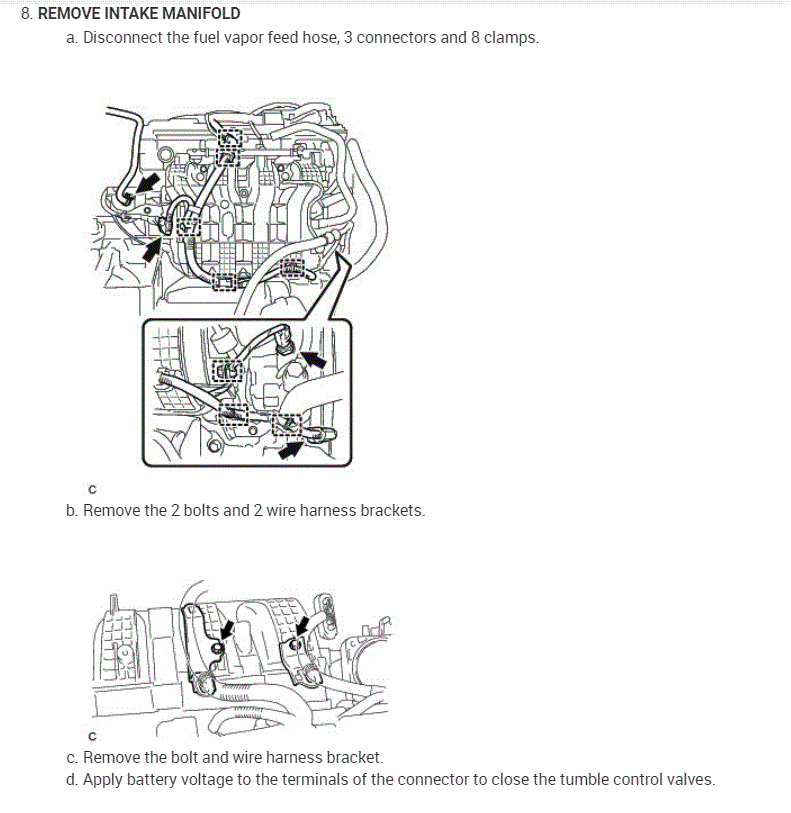

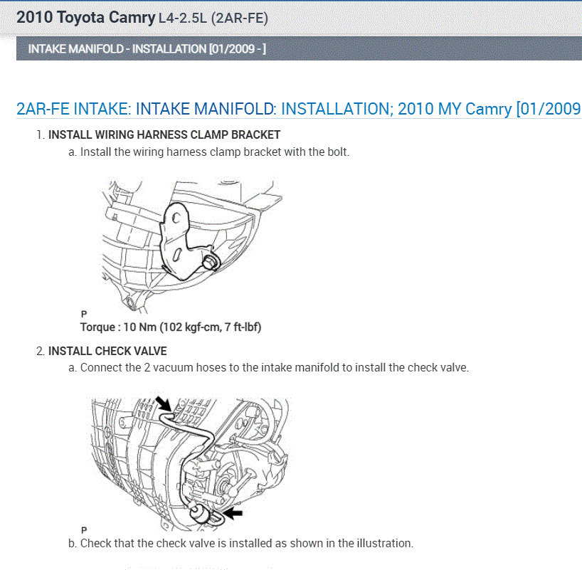

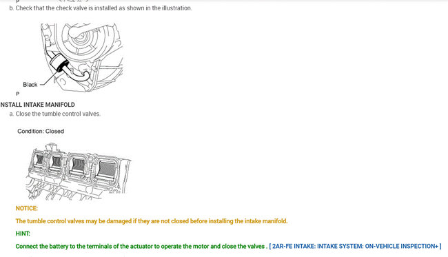

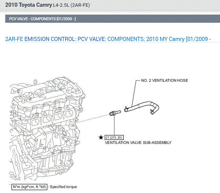

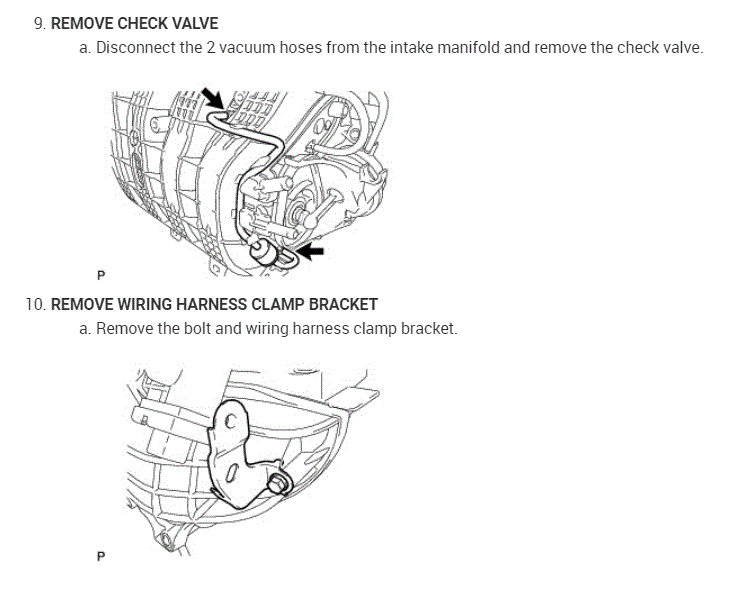

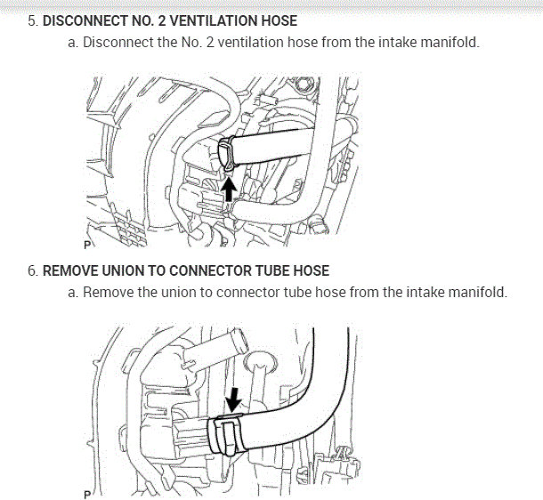

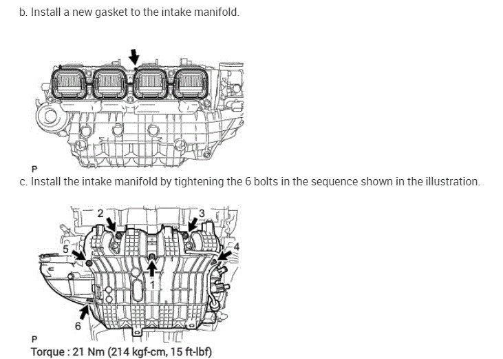

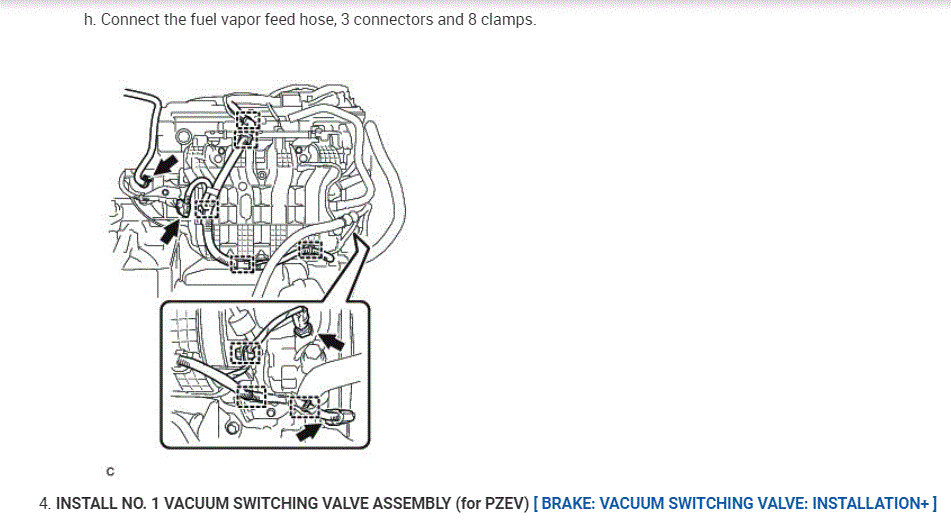

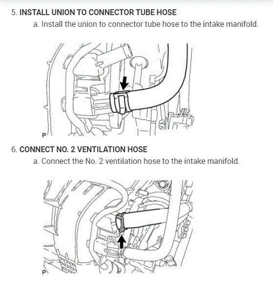

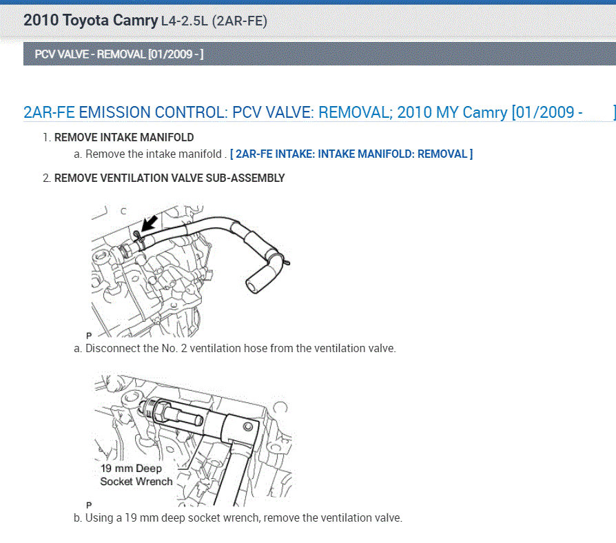

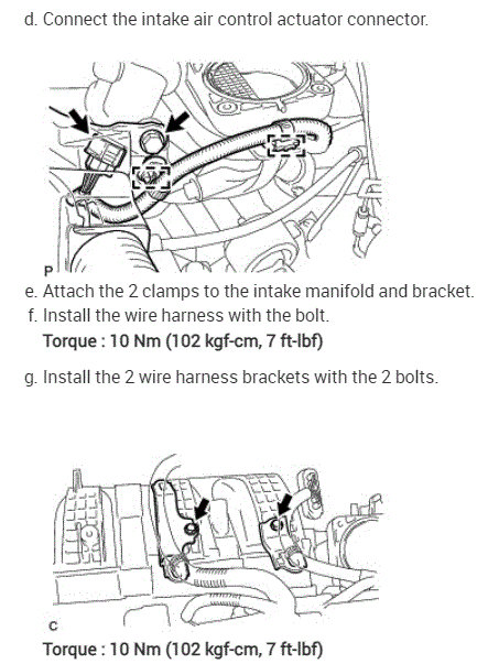

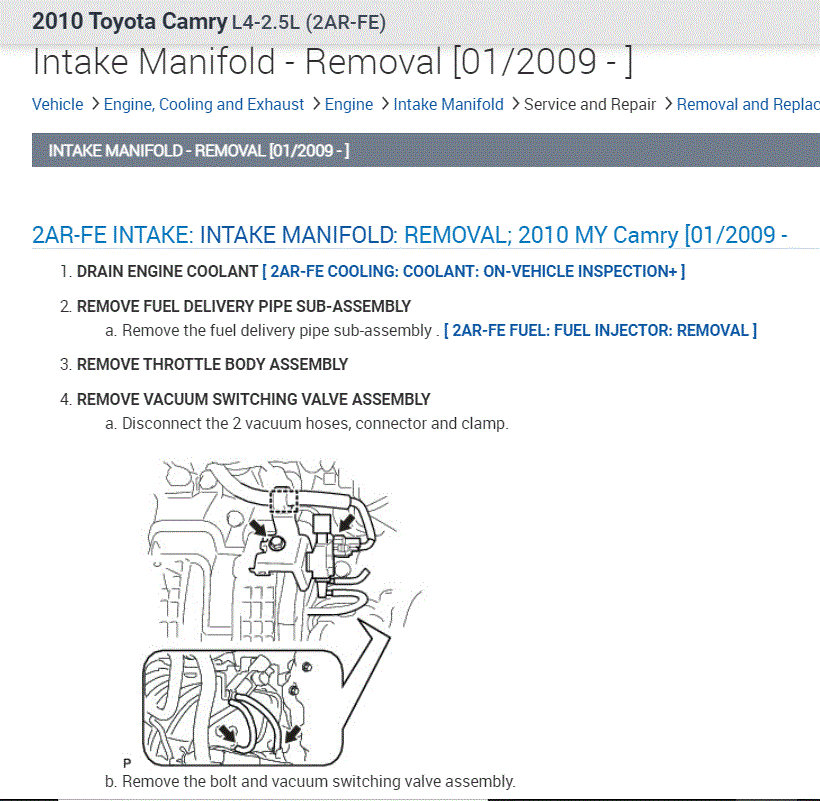

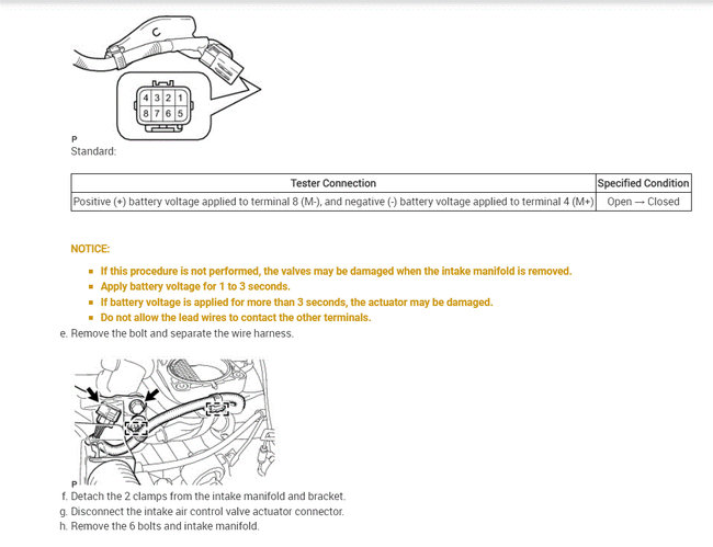

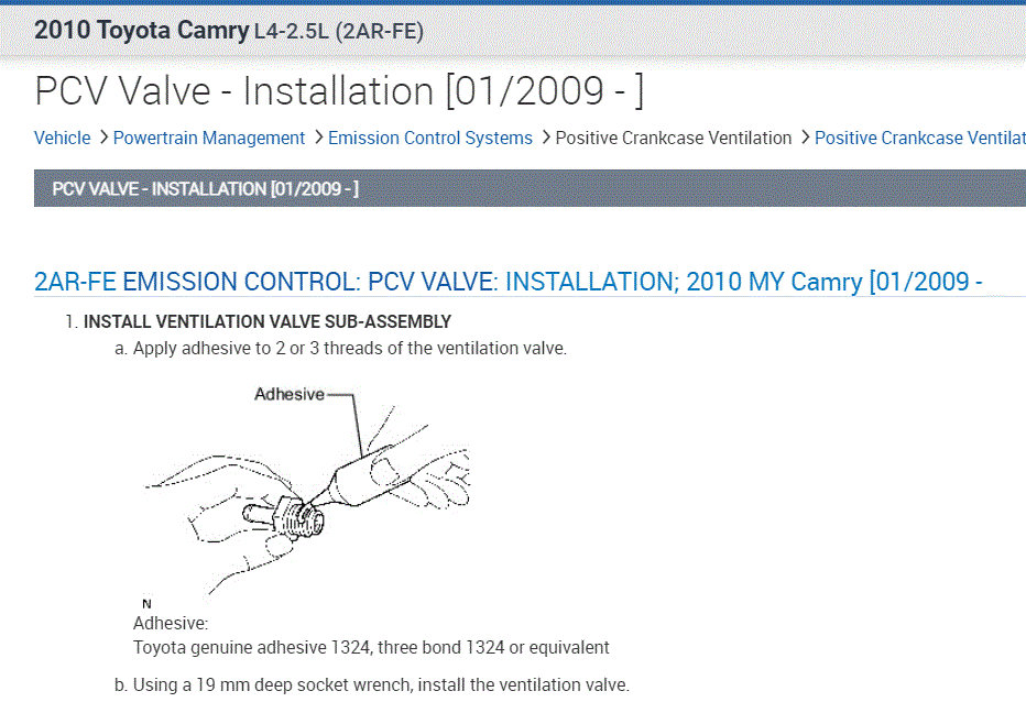

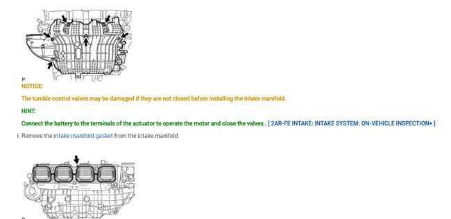

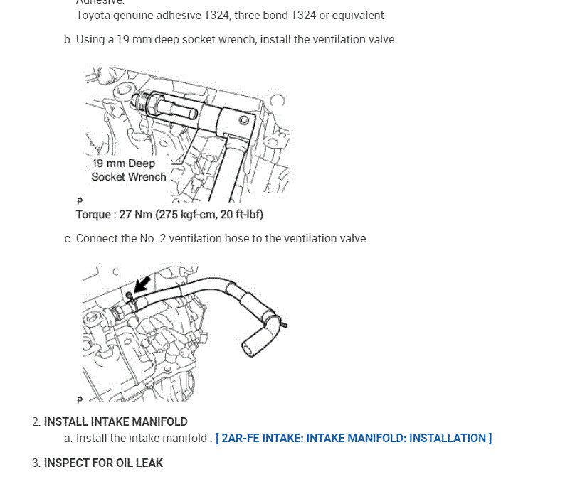

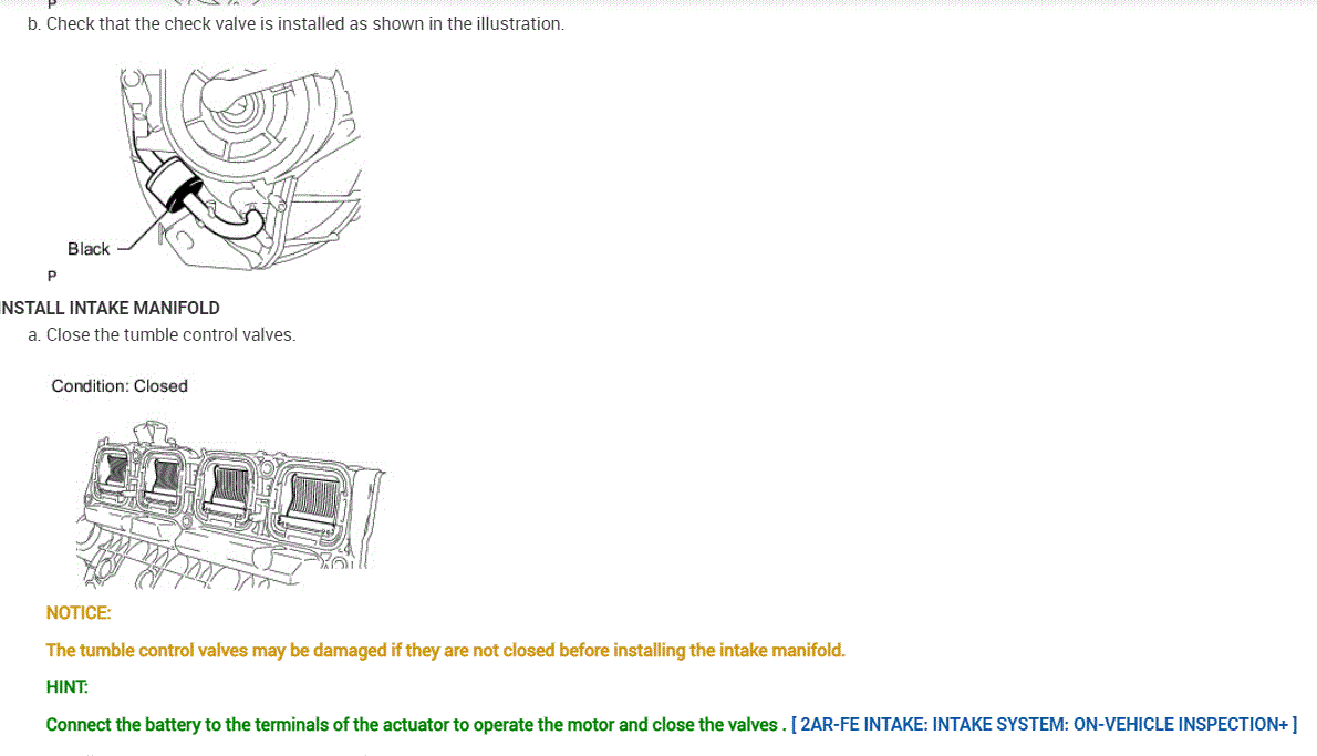

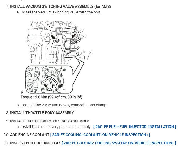

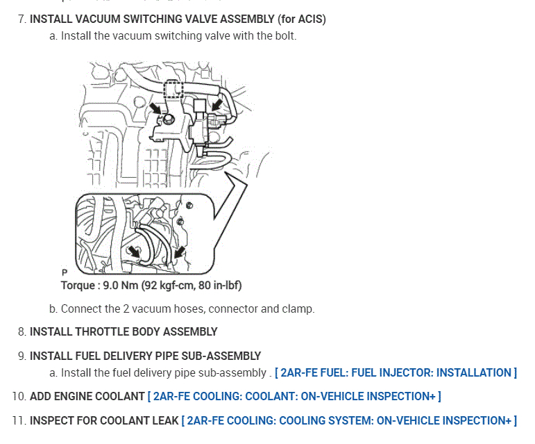

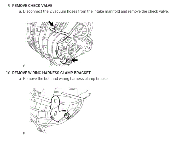

To replace the PCV valve on this vehicle, you need to first remove the intake manifold. Normally, it's a five-minute job, but not on this vehicle.
If you look at the first three pics below, they explain the actual removal and replacement of the valve. Pic 4 shows the location of the valve with the intake removed.
The remaining pics are the procedures for removing and replacing the intake.
