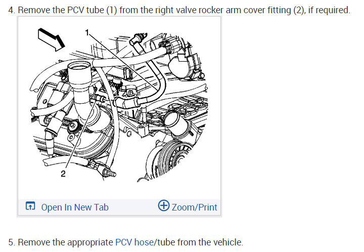

Where is the PCV valve located on my vehicle listed above?
Will I need a replacement PCV hose or a replacement PCV tube? Those are the two options from the parts store for my vehicle.

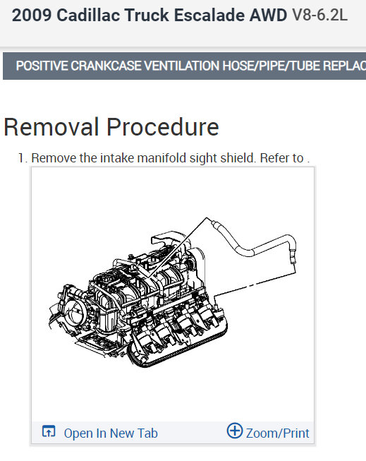

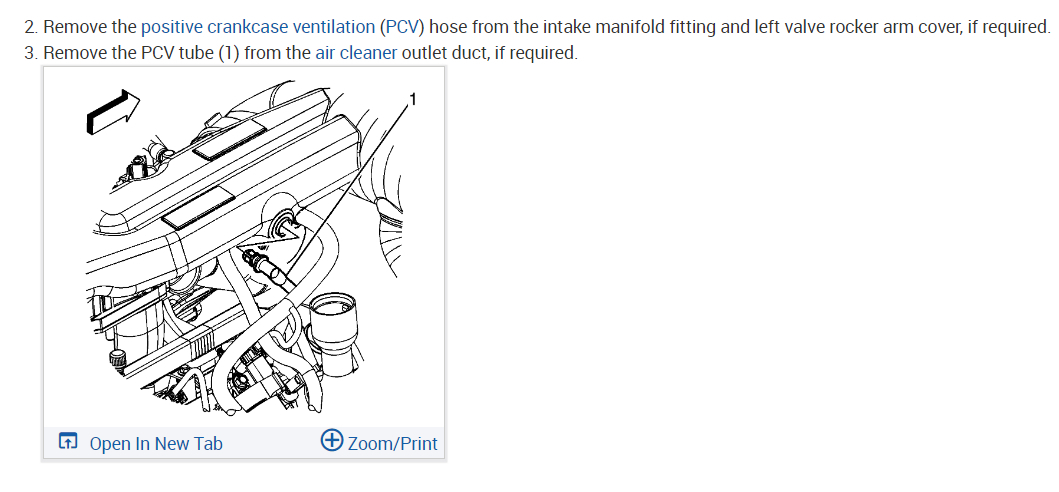

They are the same, here is the PCV hose and the valve location so you can change them out. Check out the images (below). Let us know if you need anything else.
