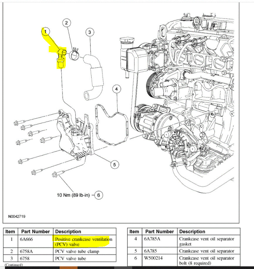

Hello, I am having trouble locating the PCV valve on my car listed above. Can anyone help me please and thanks?.
Nov 25, 2021 at 7:51 AM
  • 110,248 POSTS

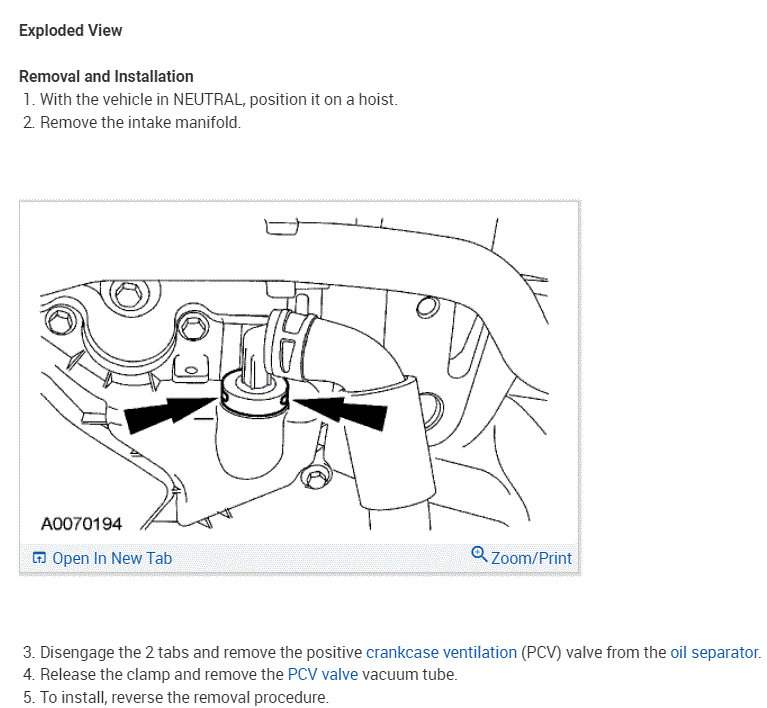

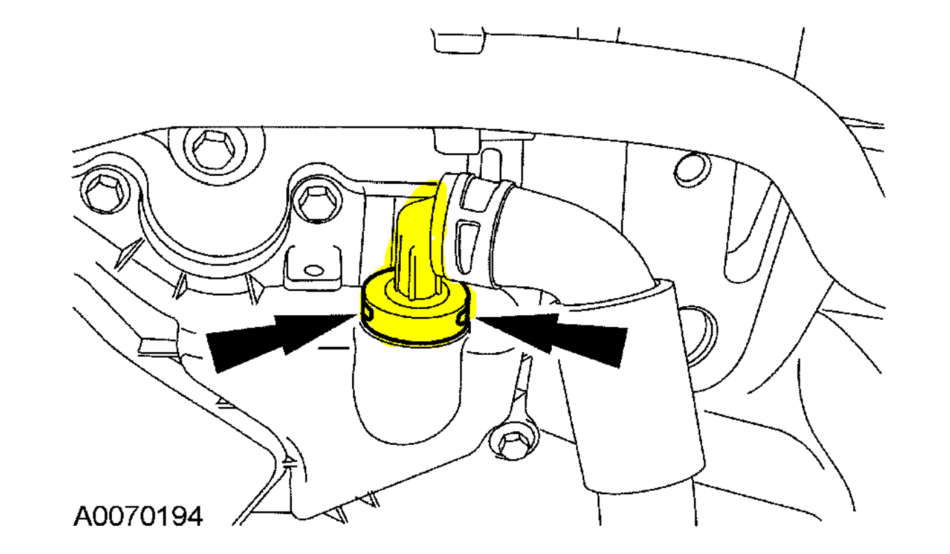

The PCV valve is on the side of the engine under the intake manifold rather than the traditional valve cover. To replace the PCV requires the removal of the intake manifold.
If you look at pic 1 and 2 below, they provide the location.
Pic 3 provided the directions for replacement.
