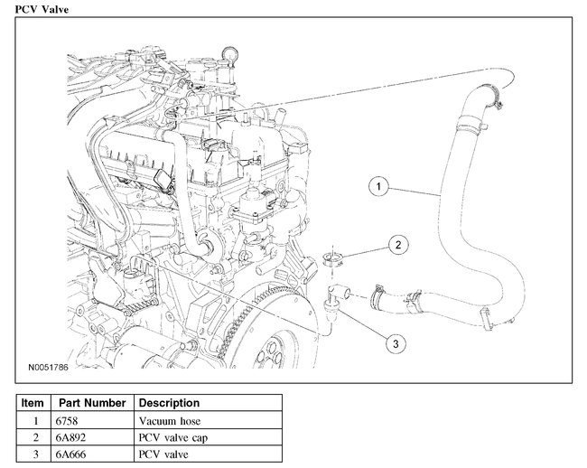

I do not know where it is located, so I can replace it. I have oil leaking into my air cleaner box, that leads me to believe the positive crankcase ventilator valve is clogged and needs to be replaced. Do you have a photo or tutorial, that can assist me?

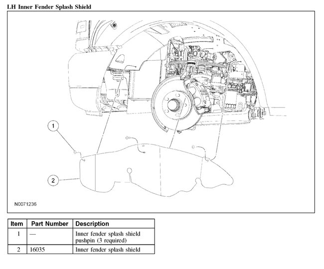

I've attached a picture of the location. The plastic housing that the pcv valve pops into can be troublesome at times also, it's called the oil separator assembly.

This illustration is not the same as my engine.

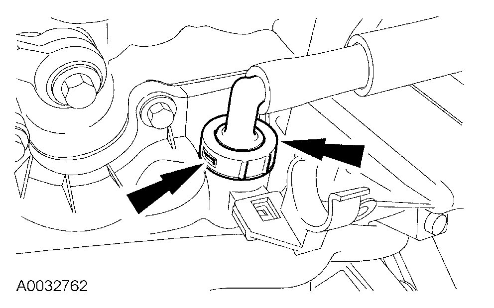

If your Ranger has a 2.3 engine, that was a picture from the official instructions. The first step is to remove the driver side fender liner to gain access to it. Removal and Installation
1. Remove the LH front wheel and tire.
2. Remove the left front inner fender splash shield.

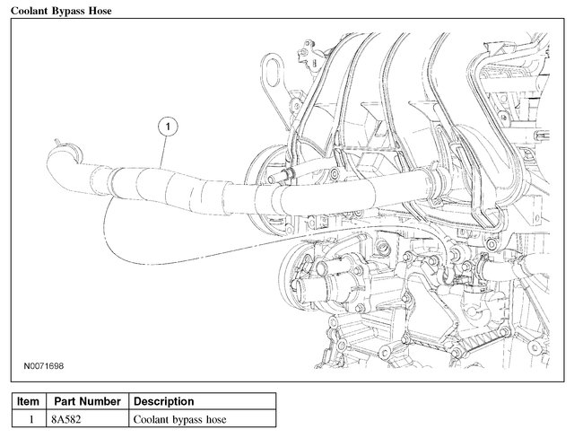

3. Disconnect the coolant bypass hose from the routing clip.
4. Gently pry the PCV valve cap off the 2 tabs.
5. Remove the PCV valve from the crankcase vent oil separator and disconnect the vacuum hose.
6. To install, reverse the removal procedure.
