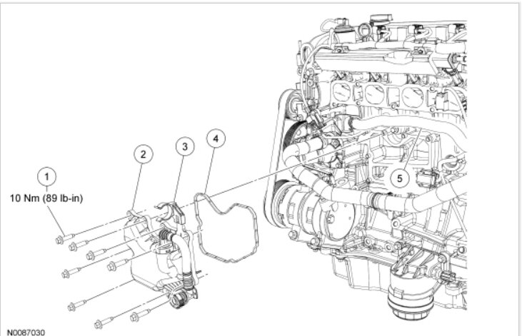

I am having trouble trying to find the PCV Valve on this car
Dec 2, 2025 at 9:47 PM
  • 55,433 POSTS
So this engine has an engine crankcase oil separator not a PCV valve per say which acts as the valve, here is the location so you can change it out, these leak and get clogged up all the time, check out the images (below). Please upload an image or a short video in your response, so I can see what's going on.
