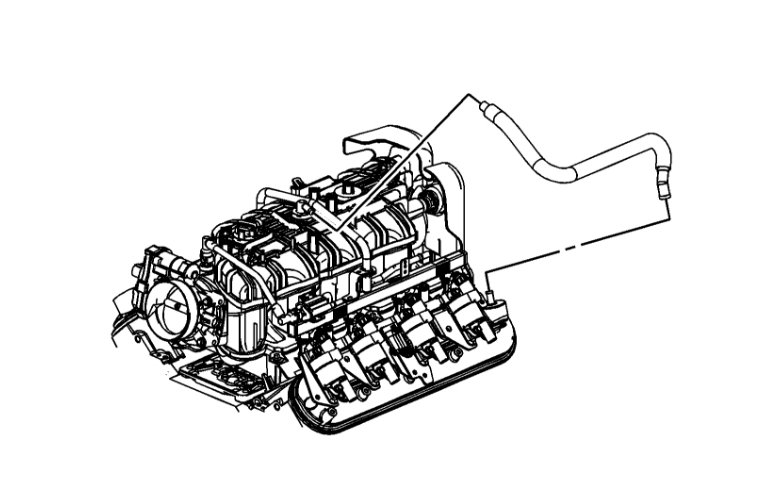

I understand that I do not have a PCV valve on my engine but a tube with an orifice in it on the back of the drivers side valve cover. The valve is not replaceable. Is it cleanable or do you have to replace the valve cover?
Feb 24, 2018 at 9:48 AM
Good evening.
the PCV valve is in the hose from the intake to the cover. it does remove from the cover.
picture attached.
