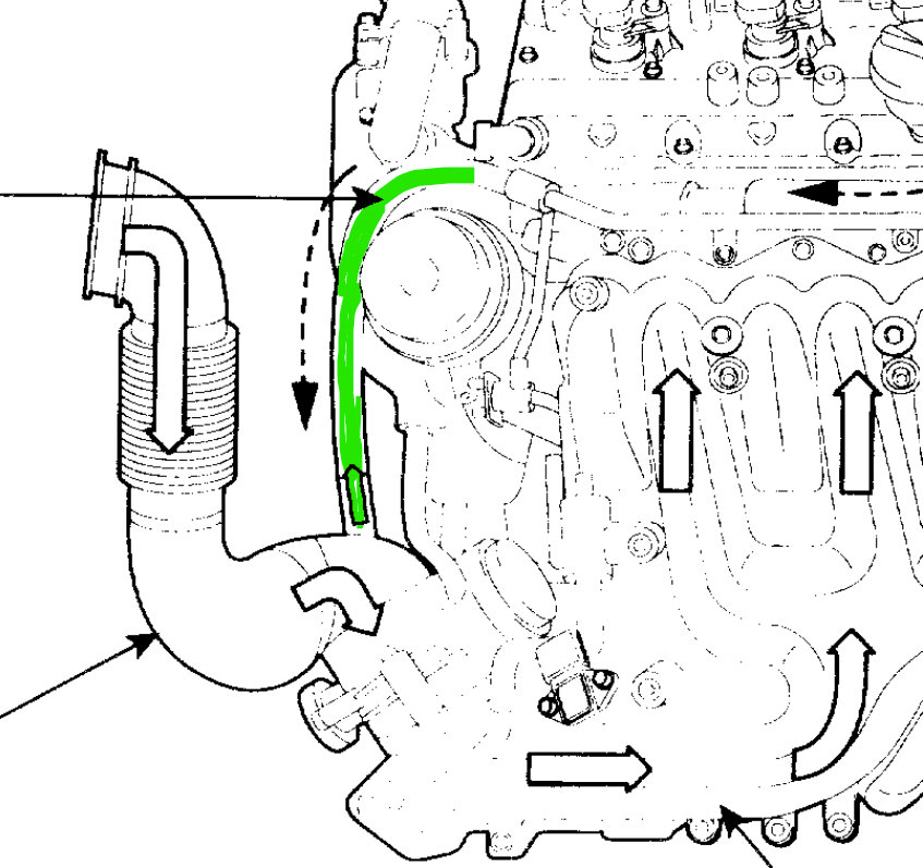

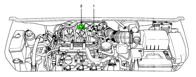

I’m trying to find the location of the PCV valve.
Jul 28, 2022 at 10:47 AM
AL514
  • 5,587 POSTS

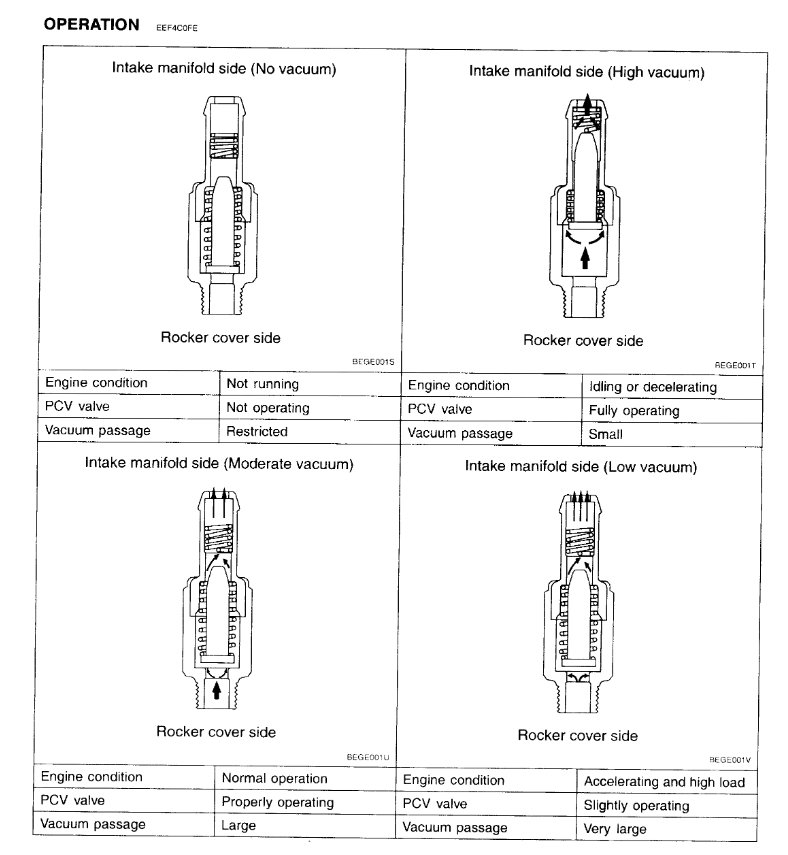

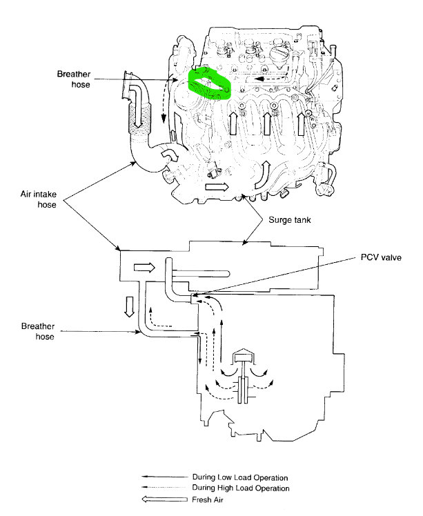

Hello, it is a little difficult to see in the diagrams here, you will need to remove the cover on top of the engine, it should only be (two) 10mm bolts. And the valve will be screwed into the Valve cover. You will have to remove the Air Intake Hose and it is on the back of the engine, under the Throttle Body. Sorry for the correction, it is very difficult to see. But it is in the back of the engine compartment.
This video is for a 2011 Sorento, but it looks to be in the same exact location.
https://www.youtube.com/watch?v=XPlNtinkX3M
