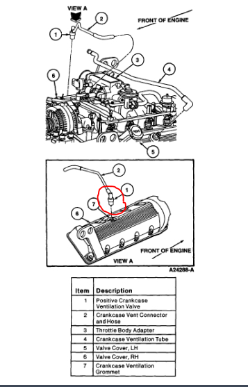

Need help locating my PCV valve, please.

The PCV valve should be located on the valve cover. I found a pic of it and attached it below.
Let me know if you are able to locate it or if you have other questions.
See pic below.
