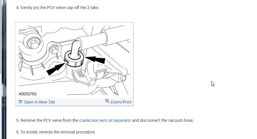

PCV location needed
2011 FORD EVEREST
50,000 MILES • 2.5L • 4 CYL • TURBO • 2WD • AUTOMATIC
EUGENE LOMONGO
excessive oil on cover.
Jun 8, 2021 at 7:30 AM

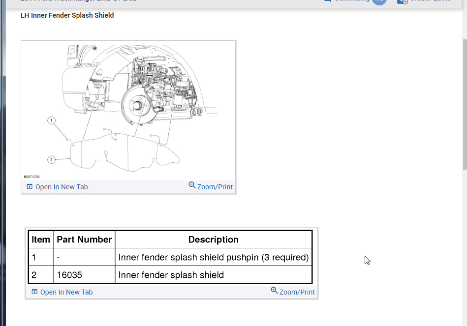

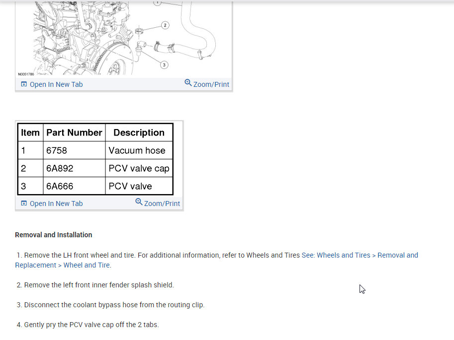

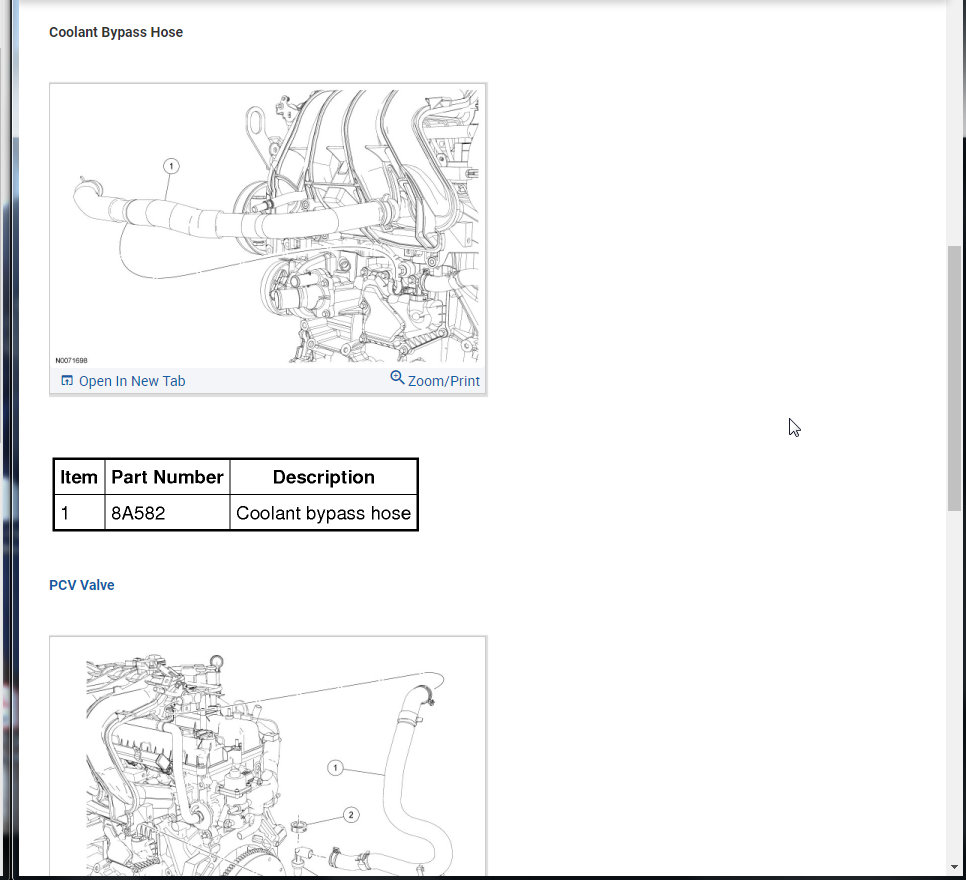

Unfortunately, we don't have a manual on this vehicle because it is not offered here in the USA. However, this vehicle was built on the Ford Ranger platform so it is similar.
I am attaching the process below on how to replace this on the Ranger.
I assume it will be close to this but no matter what the valve is going to be located in a valve cover. Keep in mind that the valve itself may be located at a different portion of the line but you should see a line/hose coming out of a valve cover and that is going to be the PCV system.
Please see the attached info. Hopefully this gives the detail that you need. Thanks
