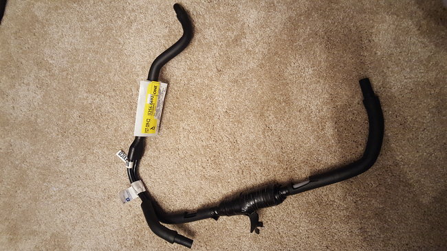

The PCV hose broke in three places, so I know on passenger side where it connects,then goes behind engine connects back right corner. My question is, is that the only two places it connects? The one I bought already has the PCV valve in it.

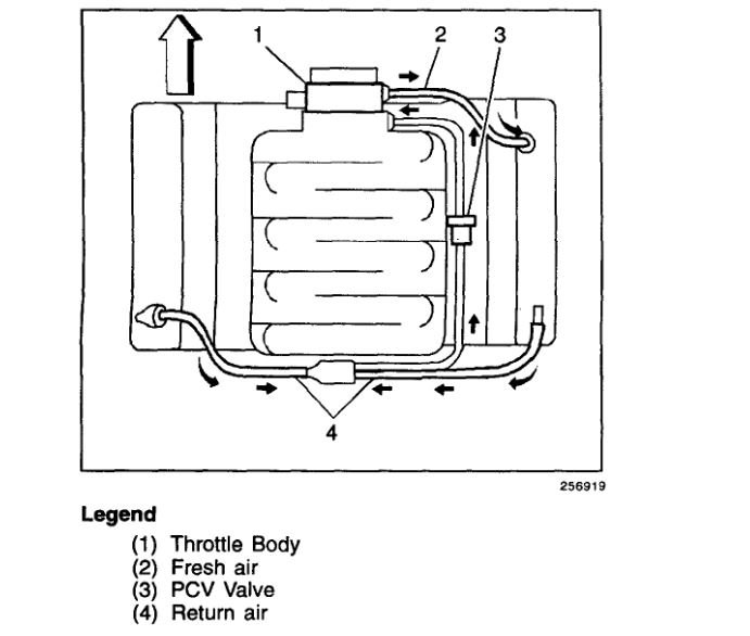

Okay, that makes better sense.
I attached a diagram for you to view on the PCV system.
See if this is what you have. It connects to both valve covers.

I think I understand now, I sent you a picture of new PCV hose so it hooks up in just two places that little short piece is for like a vent for fresh air? I was told the 1998 5.7 Camaro was different from the 1999 through 2002. Sorry, I am learning, I have repaired a few things on it by myself. Thanks again.

All three have a home. Two to the valve cover and one to the main vacuum line from the manifold.

Okay, I understand now. I will fix it up this weekend, suppose to be 100 degrees tomorrow. Thank you very much for your help.

I replaced the PCV hose today on my car. It took me about two hours, once I moved some other things out of the way I saw where that other hook up was in back corner on passenger side. I do not think I could have did it without your help so thanks again. Becky
