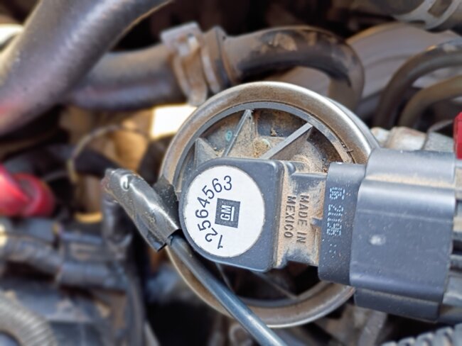

is this it because I can't find this part number online and it's the closest thing I see under my hood that looks like it

that doesn't connect to the pcv valve or it's hoses

What kind of phone do you have? Also, this is the EVAP purge solenoid (purge valve) so this is what the code is for. I see a vacuum line that looks like it is taped? This will be no good, I would get a small piece of windshield wiper washer tubing at the auto parts store for the repair.

that's what I did but I taped around the ends to keep it from coming off and it's a moto g I entered the parts numbers you gave me on Amazon and it keeps pulling up parts that are not for my car they say however it did lead me to a part that is compatible and claims it will fix this code so I ordered it il upload a pic in a min cus it's got a hose connected to it that idk how to remove but the round 1 you mentioned I can't find a specific 1 thats compatible

so I ordered both these parts I believe I know the all black 1 that I asked if there's a hose that goes on that end is the right replacement part not sure it's what you meant or not and the other round looking 1 idk if it's the right 1 or not at all but it was closest in emissions that matches somewhat and Amazon said goes to my cars emissions lmk what u think

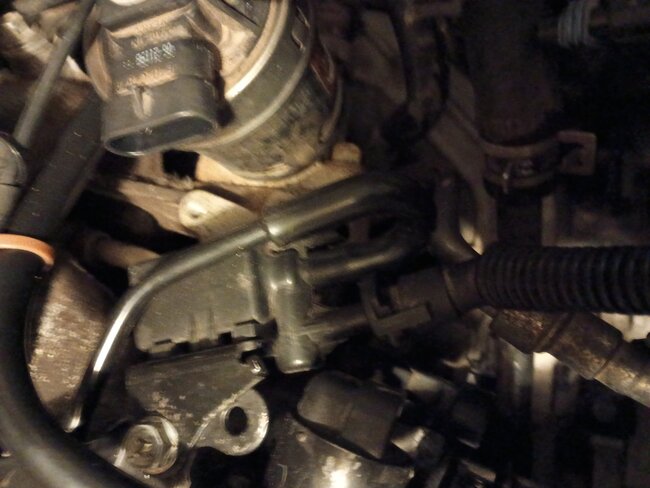

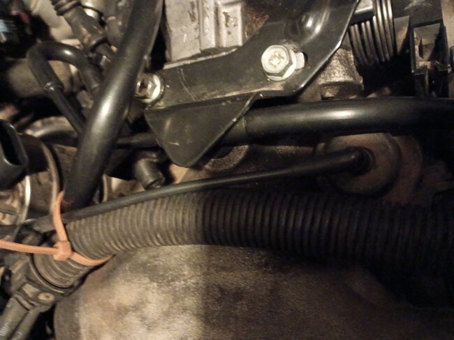

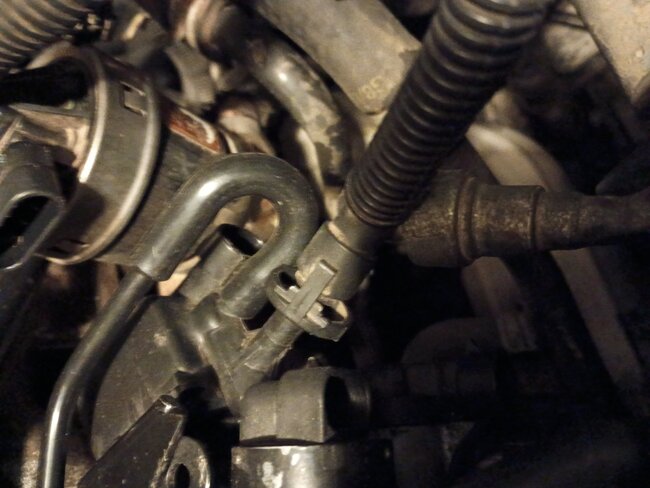

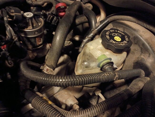

see this roundish plastic connector in pic #1 that connects to the pic #2 which is the part you said is likely the cause for code p0446 and then to pic #3with the green cap that has a black tag saying evap service port well Idk how to get this connector off and there's a open ended hole on the other end pic #4 is anything supposed to be there
Feb 1, 2026 at 9:03 AM
  • 55,433 POSTS
Yep, the lines look better. So the EVAP system needs to be 100 sealed, it cant have any leaks so please keep that in mind. Also, looks at the O ring seals inside the corrugated line on the solenoid. This video can show you how to check for leaks on the system.

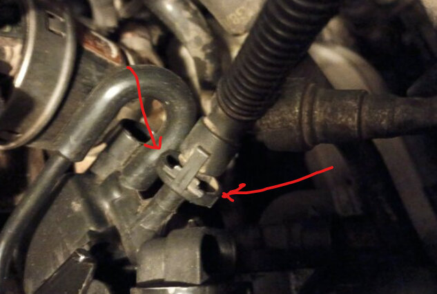

how do disconnect the hard plastic connector to it tho
Feb 2, 2026 at 4:11 AM
WIMMS77
  • 12 POSTS
I don't need to track down a leak I need to change this part and can't figure out how to. get the evap connector off of it to do so
Feb 2, 2026 at 4:12 AM
  • 55,433 POSTS
O sorry, yes you squeeze the connector at the "loop" part this will release the connector without breaking it. Check out the images (below). Please let us know what happens.

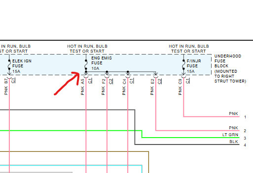

So you still have this code?
Code: P0446 - EVAP Vent System Performance / Vent Control Fault
Lets check the ENG EMIS fuse in the fuse panel under the hood. This guide can help
Feb 5, 2026 at 1:35 AM
WIMMS77
  • 12 POSTS
yes code came back after resetting it and driving it a lil bit but can a fuse go bad or fail and be bad even if it's not burnt inside
Feb 5, 2026 at 4:15 PM
  • 55,433 POSTS
Not really if the fuse is not burnt it is good. Can you check the gas cap seal, this is another point of failure for the sealed system. Keep in mind any leak in the gas EVAP system will cause this code as well.
