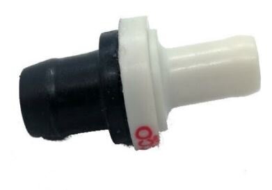

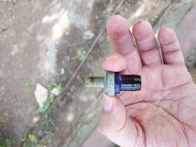

Install new PCV, the new one is a little bit slack. strange because seems the same product (see attached).

Yep, they seem the same, what do you mean by slack? Here is how to install a new PCV in the images below. Check out the images (below). Let us know what happens and please upload pictures or videos of the problem so we can see what's going on.

As you can see in the attached video, PCV does not look stable.

Thanks for the video, it does look like the grommet needs to replaced the valve has too much play causing a leak.
