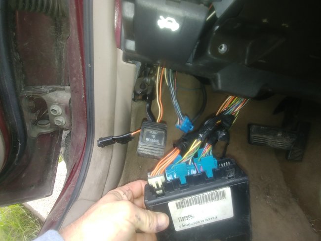

It started by blowing the fuse every time I tried starting it, but if I unplug the last plug from the black box under the steering column.
Apr 6, 2020 at 2:34 AM

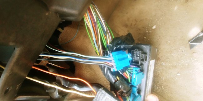

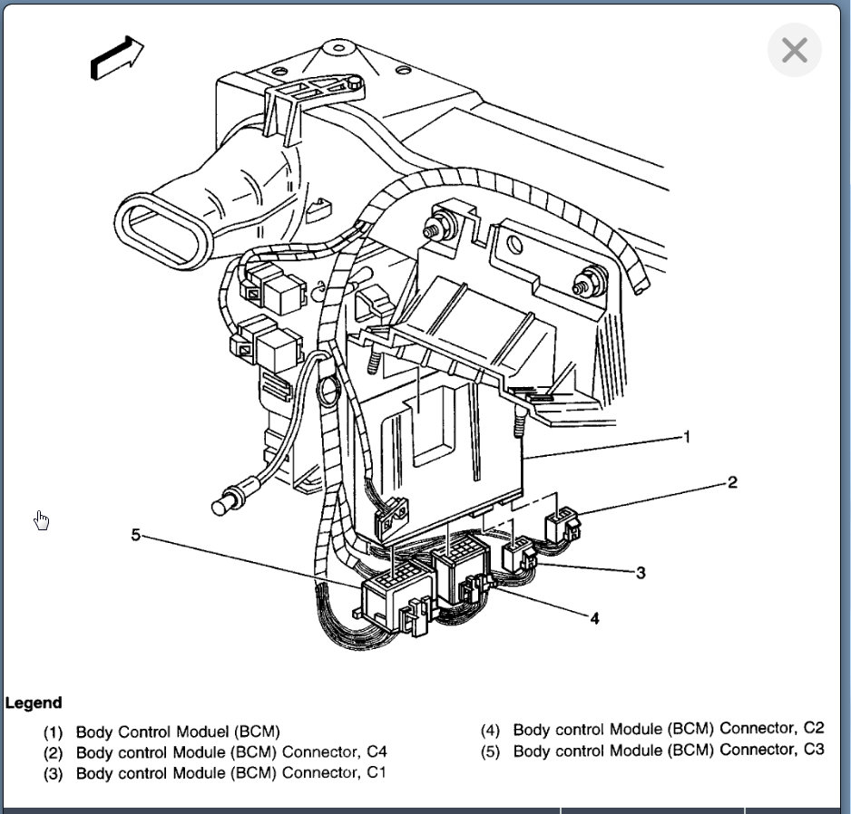

Okay. We need some more info to figure this out. Can you get a picture of the box under the steering column with the connector unplugged so we can try to narrow this down?
Clearly you have something drawing to much current but it would be great to narrow it to one circuit so let's start with this and go from there. Thanks

It's the PCM,BCM, U/H relay.
Apr 6, 2020 at 3:22 AM
Okay. I should have been a little more specific. Sorry. We are trying to find out what actual connector that is on the BCM so that we can narrow the issue down to one circuit to find out what is blowing the fuse. Basically just hold it in the position it mounts and tell me which connector it is. It looks like it is number 2 C4. Can you confirm this?
if that is the case, we will need to see what else is on that connector and then start unhooking those components one at a time with that BCM connector remaining connected until we find the component or wire that is blowing the fuse.
Apr 6, 2020 at 4:24 AM

Is this the picture of what y'all need?
Apr 6, 2020 at 6:38 AM
JYEARY91
  • 26 POSTS

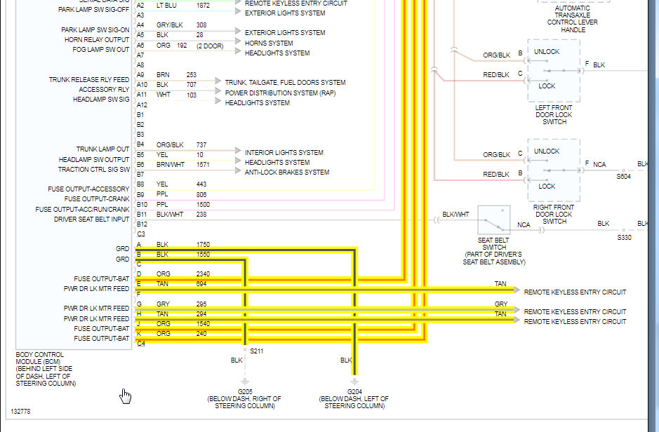

And yes I believe it's 2 c4.
Apr 6, 2020 at 6:40 AM

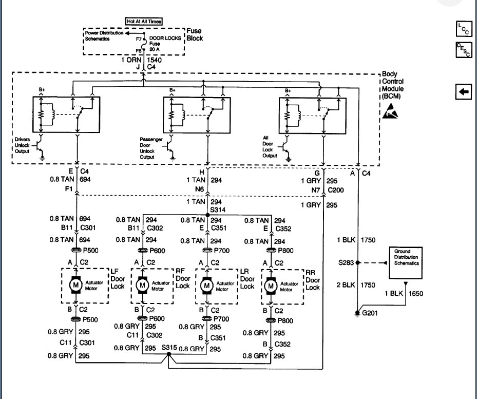

Okay. So this connector basically just runs the actuator motors for the door lock actuators. There is no easy way to do this other then, unhook all the actuators in all the doors and then install a new fuse, connect the BCM connector and start the vehicle to see if everything works and the fuse does not blow. Then go through and connect them one at a time until it blows again.
Clearly if it still blows with all these unhooked then it was not this. However, if you have that connector unhooked then and it starts and that fuse does not blow then I suspect one of these actuators is shorted.

I show the BCM and cluster/gauges communicate on one wire only which is in C2 so if you are unplugging this connector and the gauges go away must be something else where the BCM communicates with the PCM causing the gauges to shut off.
According to the wiring diagram this connector from the BCM only controls the door actuators. So can you clarify that when you unhooked the "door locks" that it was the actuator behind the door panels and not just the switch?

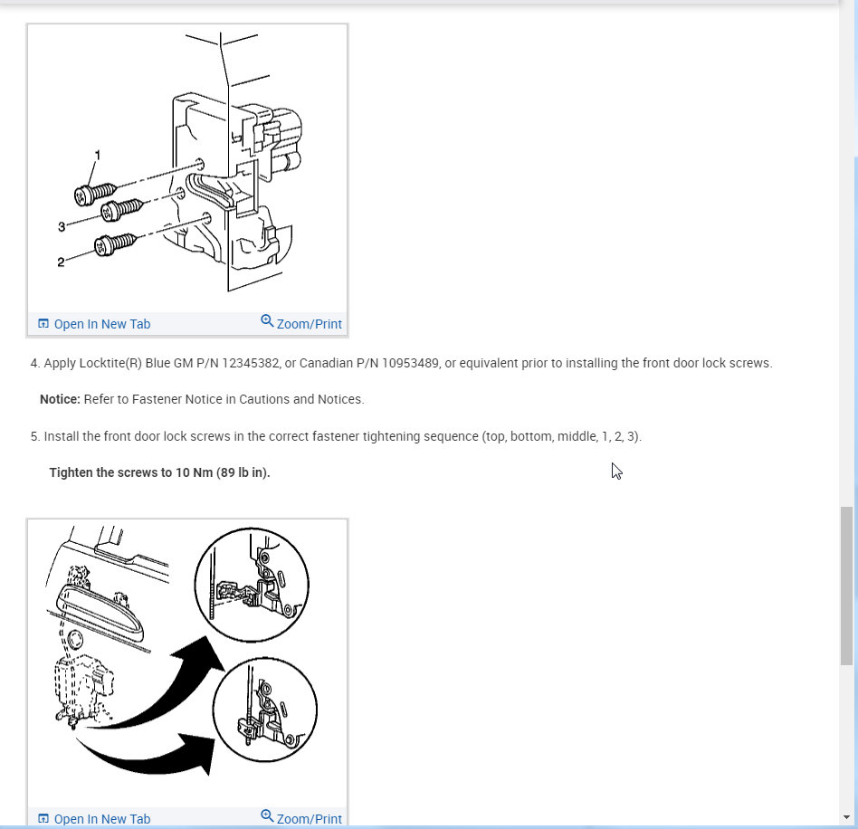

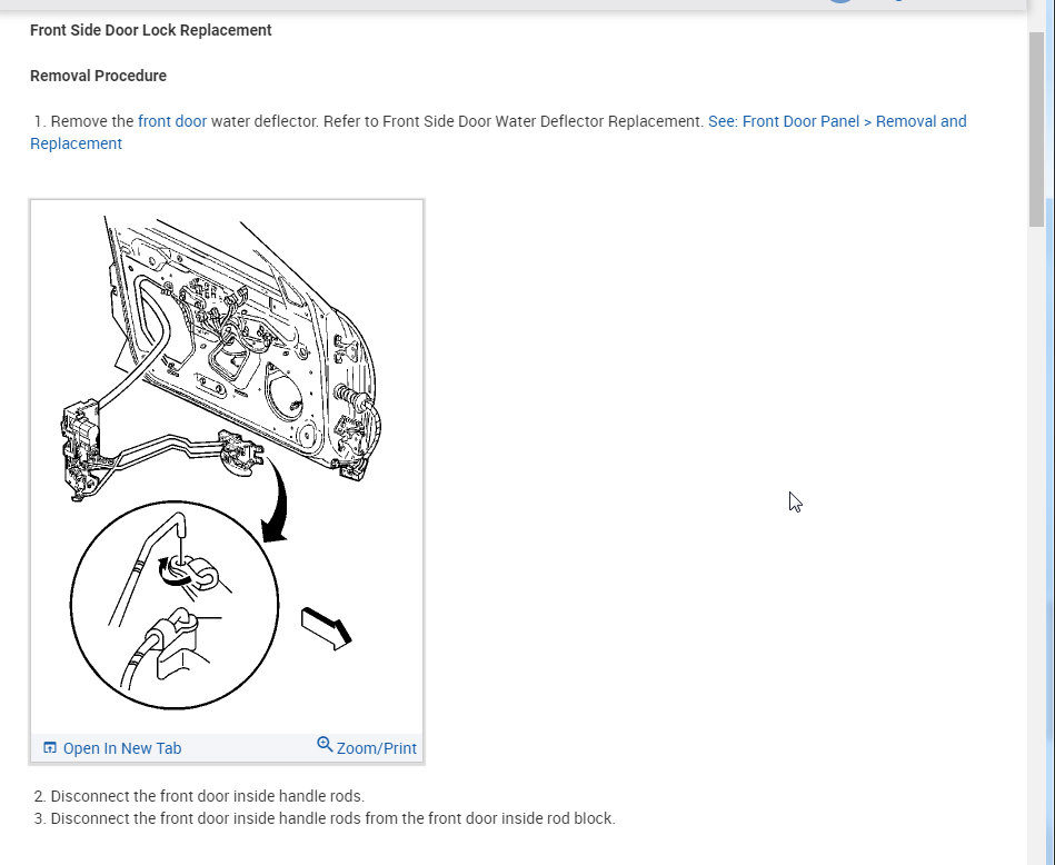

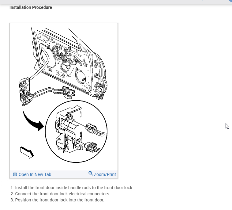

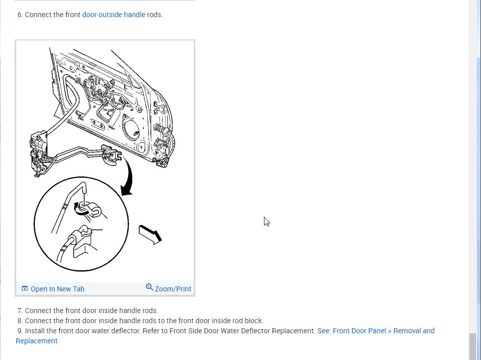

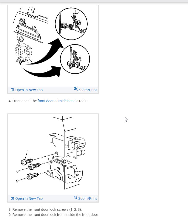

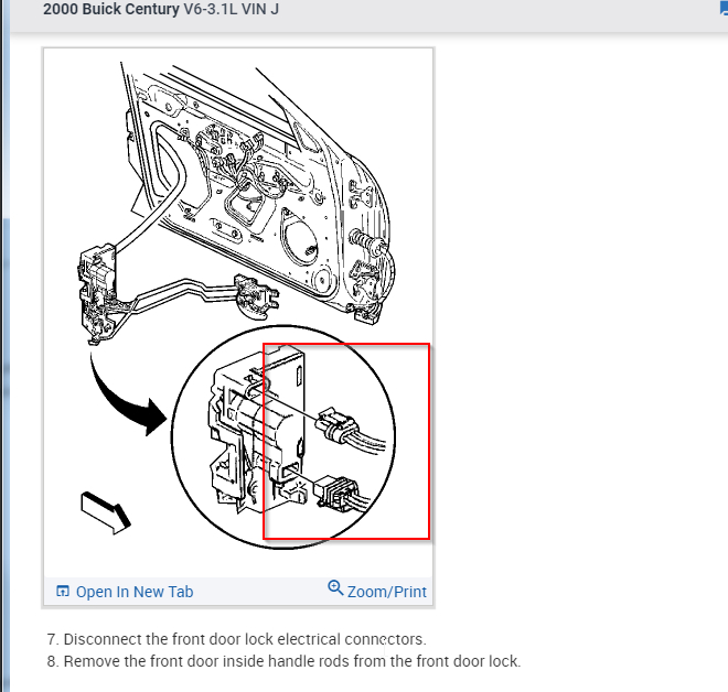

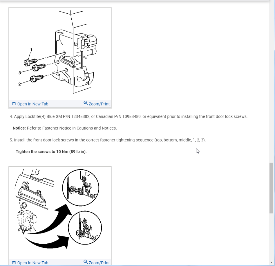

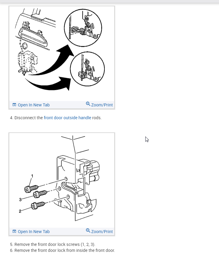

Okay. I should have been more specific. The lock actuator inside the door panel is what the connector from the BCM is feeding. See the attached process. I think you can just remove the door panels and unplug them. You don't need to remove them, just access them and unplug them.

Unplugged all the door connections just to make sure I was unplugging the right one and it still blows the fuse.
Apr 10, 2020 at 11:43 AM
Sorry for the delay. 2+2 is not equaling 4 on this. I suspect we have the wrong connector on the wiring diagram. The connector that you unplug to cause the the fuse not to blow, is not C4.
Let's try to confirm that. Can you put a new fuse in, unplug that connector so it doesn't blow and then operate the door switches (with the connector of the doors all plugged back in, obviously)? If everything on the door, specifically the locks, work then the connector that we are looking at on the wiring diagram is not correct.

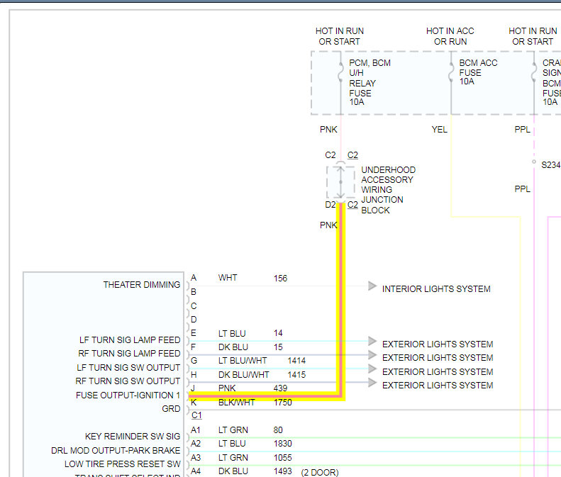

Okay, it's this pink wire causing all the problems.

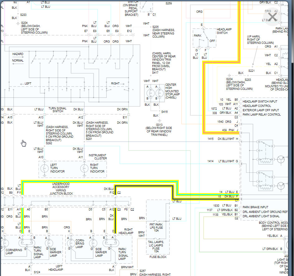

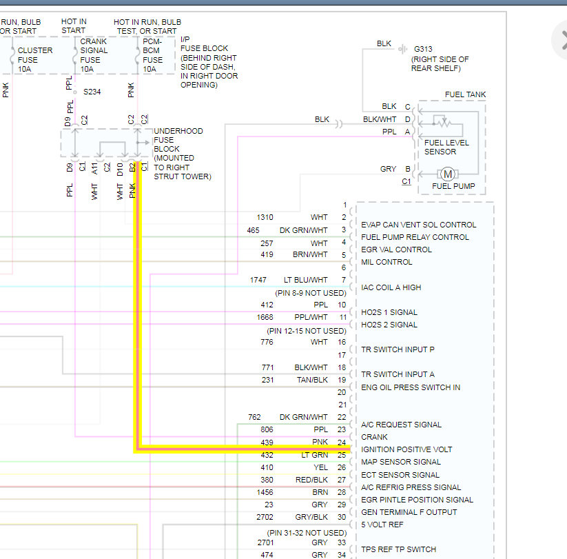

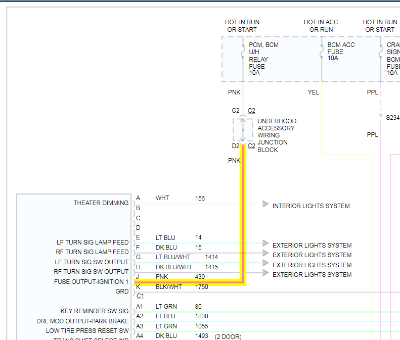

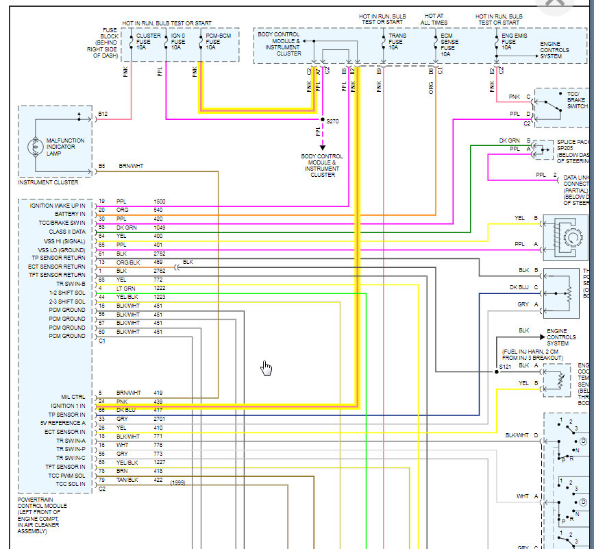

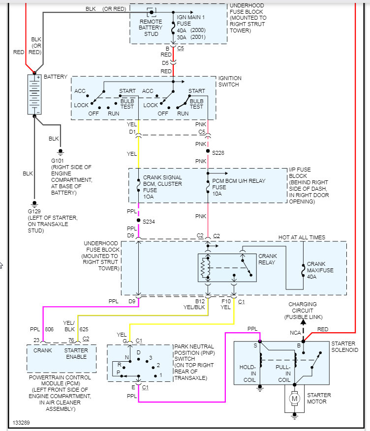

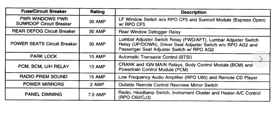

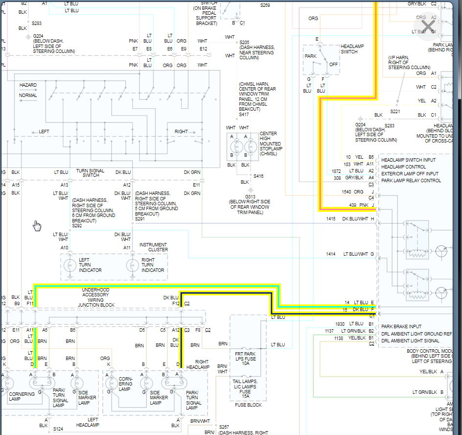

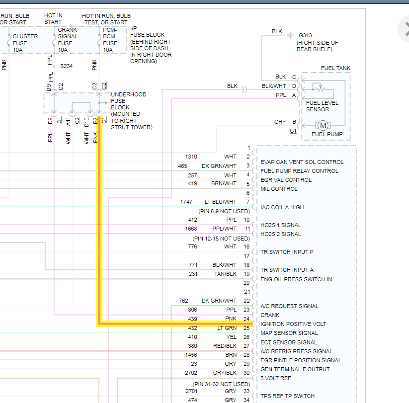

That figures. That is the direct feed from the fuse that is blowing. The second diagram is of the PCM which feeds the ignition positive voltage for the PCM.
However, as you can see the first two diagrams show this circuit running through the under hood fuse block. The third and fifth diagram shows more detail on this circuit breakdown.

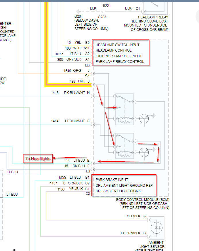

As you can see from the different diagrams, the crank relay is fed off this circuit and I think you said this blows when cranking? If so that could be a faulty relay or the starter, coils, or injectors drawing too much. However, what is odd is that if you unhook the BCM connector (C1) it doesn't blow. This tells me there is something on the BCM side that is causing it. This is why I attached the last diagram. This is the feed for the headlamp assemblies through the BCM. Try unhooking the headlamps and see if it blows.
Apr 11, 2020 at 12:15 PM

That is pointing me towards the BCM. At this point if it were me, I would get a BCM for it. Looks like you can get one for less then $100.00 if you can program it. If not, it will be about $100.00 after core return.
Clearly it is still a guess but looking at this wiring diagram the BCM is what will become a pass through when you turn the headlights on. When the lights are off, the BCM is what is determining what comes on and not. If the control side of the BCM is is shorted then it will overload that fuse. You turn the lights on and it is a straight pass through and the fuse doesn't blow.

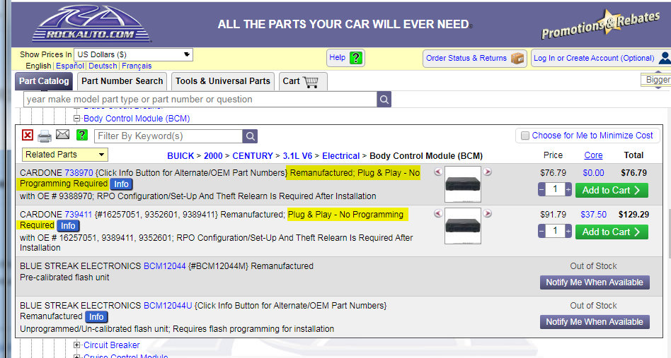

So when I buy it from the parts store and have them program the VIN into it do I have to do something else or can i just plug it in?
Apr 15, 2020 at 2:37 PM
Yes. That is how I understand it but I have not purchased one of these from an actual parts stores. I always get them off online stores as they normally have better prices. I attached the options from the most common online site and they show both their options are already programmed.
