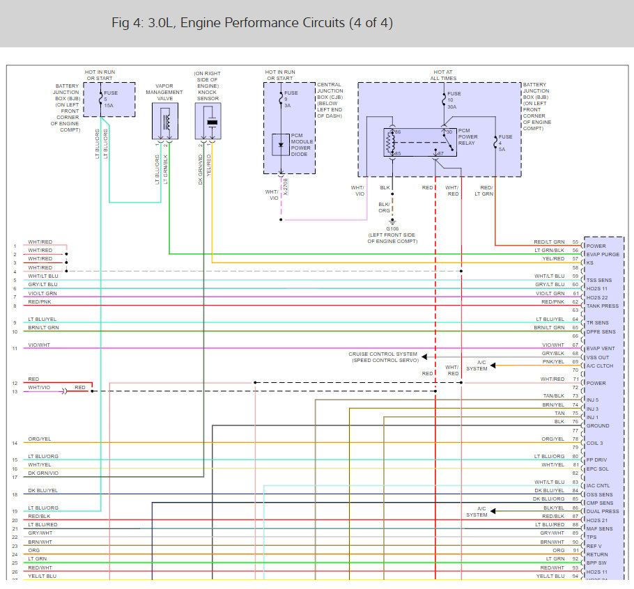

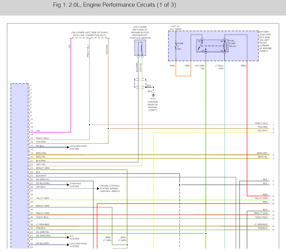

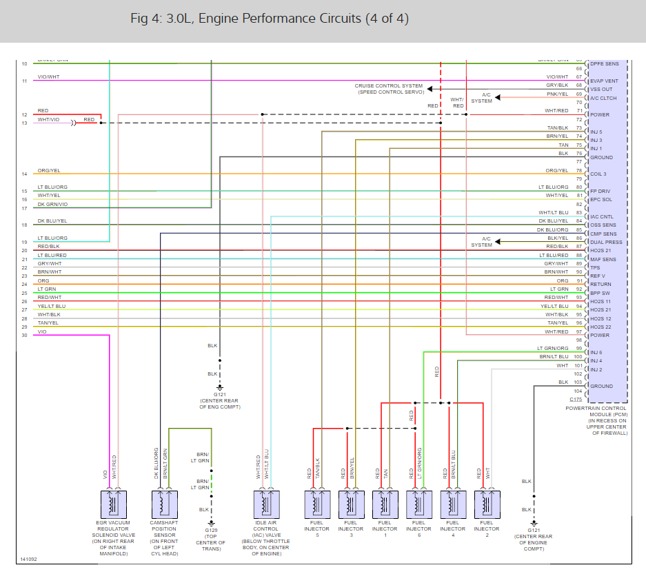

Just swapped engine and it will not start. I am suspecting harness damage during swap but no visible damage. I am looking to get wiring schematic to test continuity from sensors and related engine wiring.
Thanks for your help.

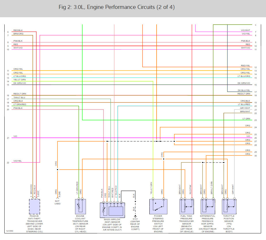

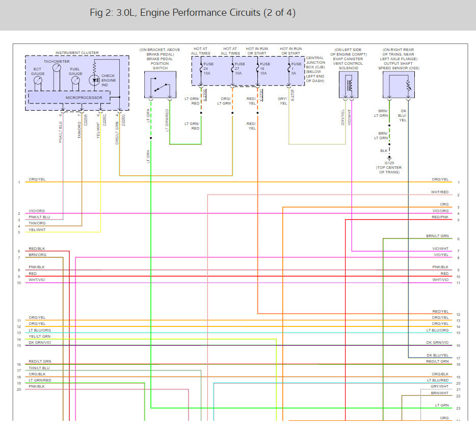

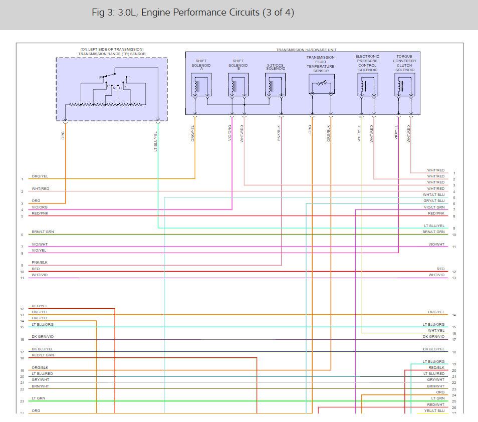

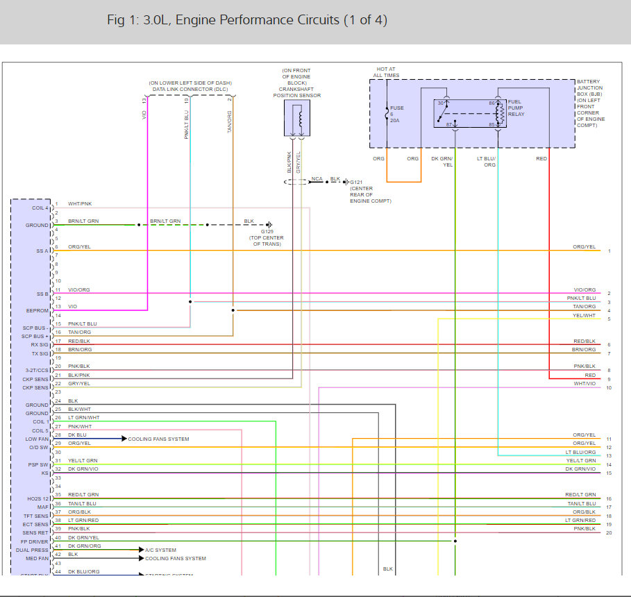

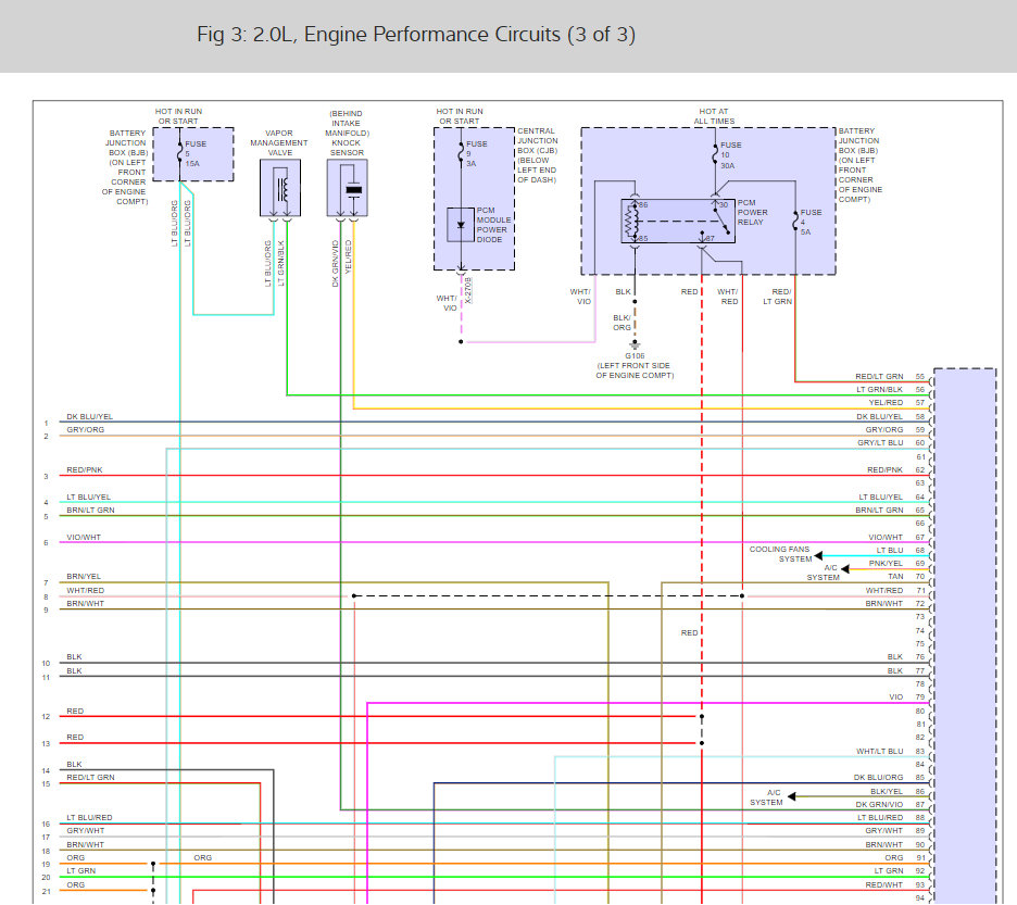

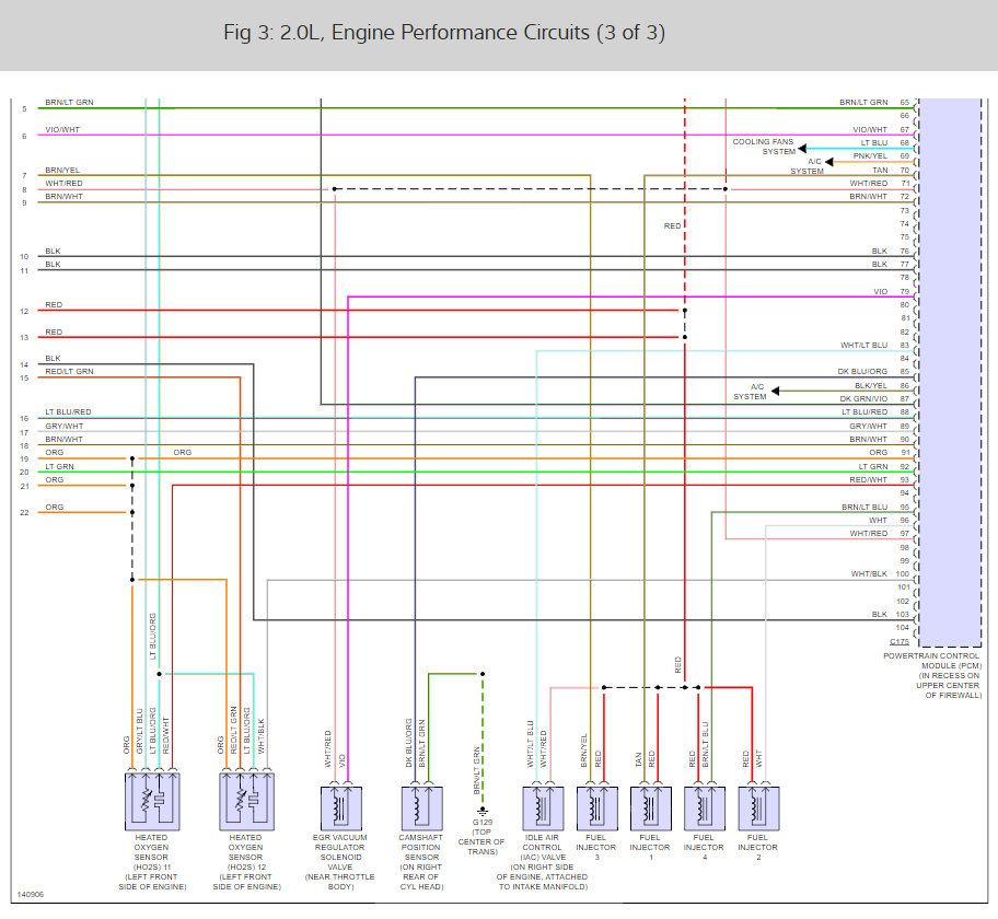

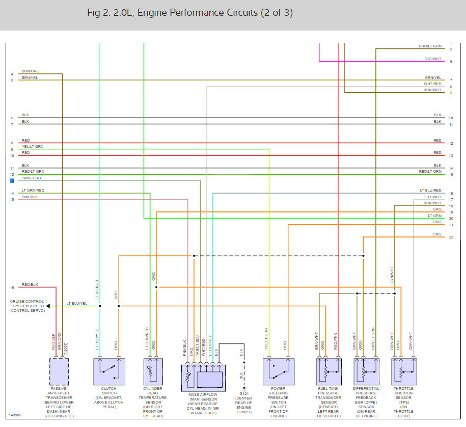

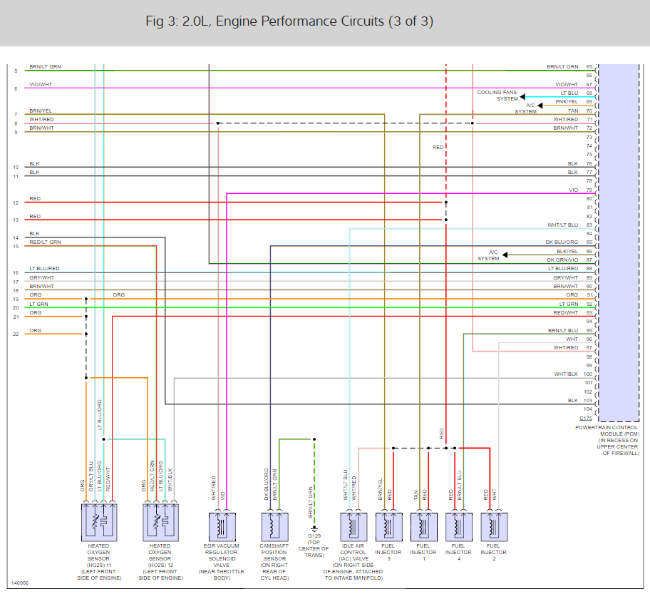

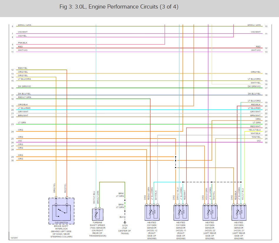

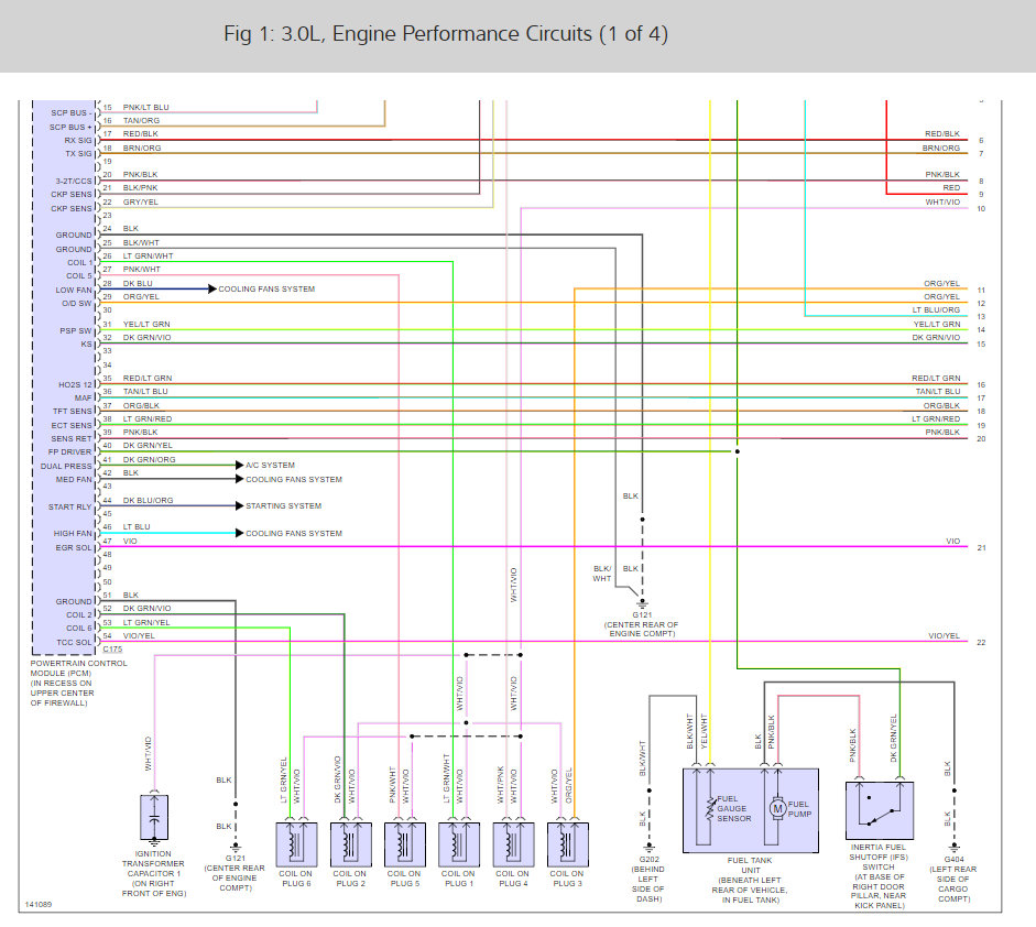

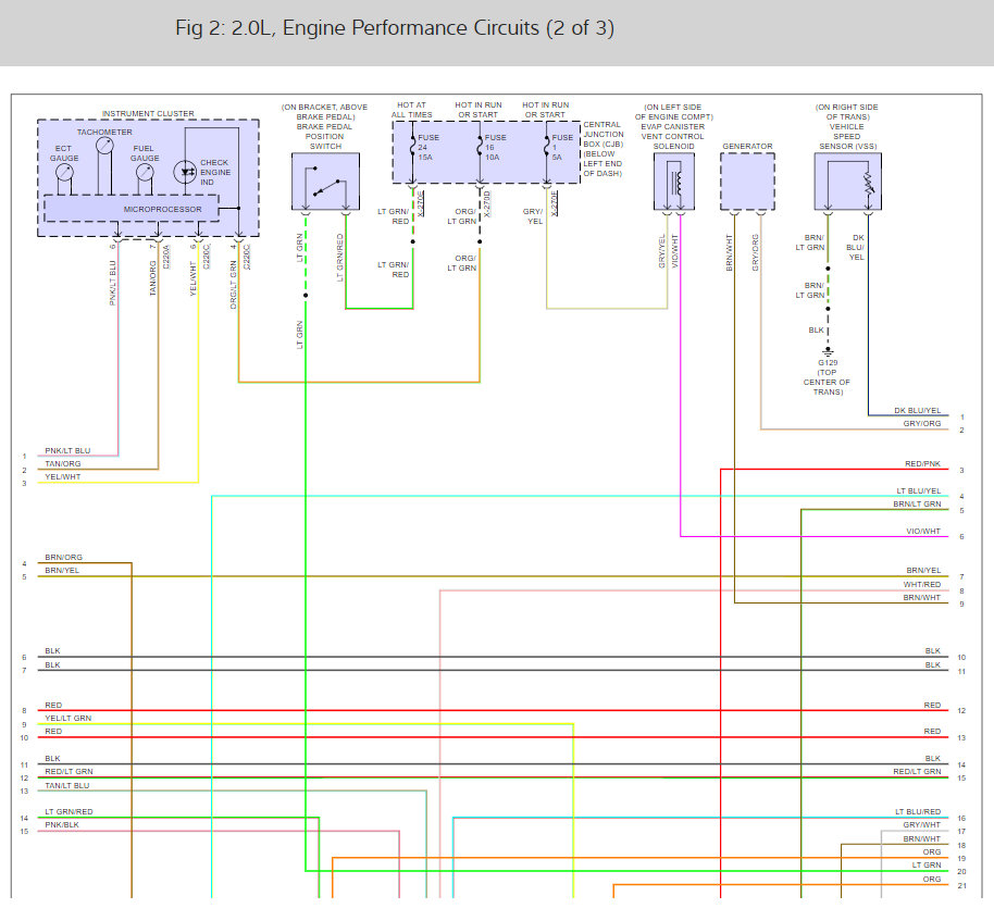

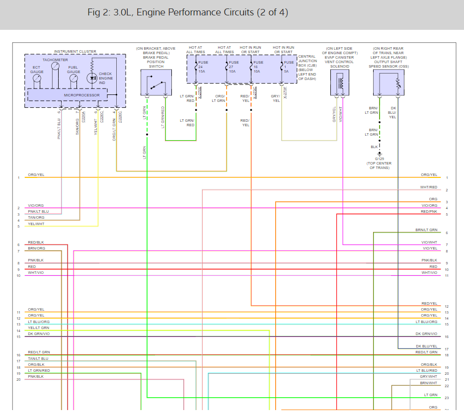

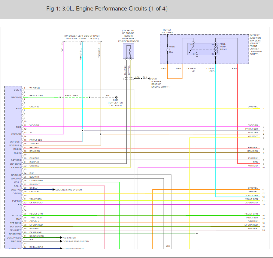

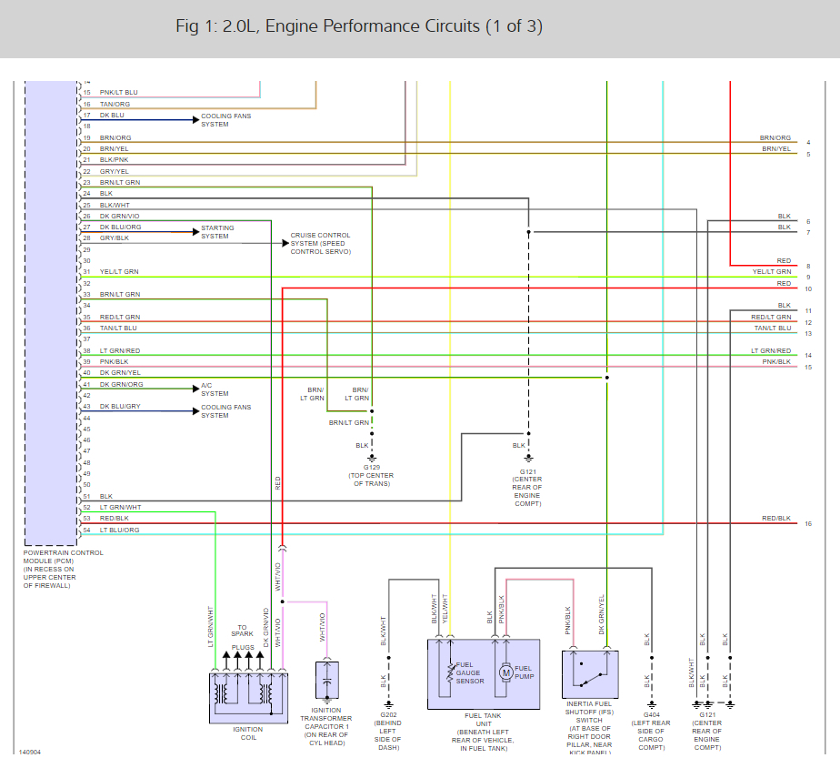

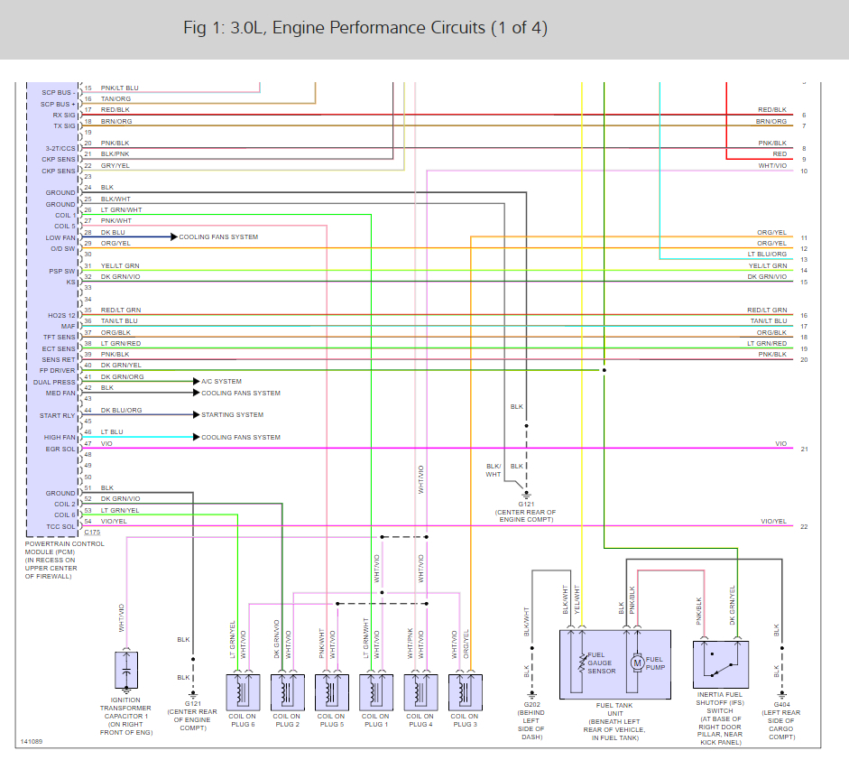

Here is a guide on how to check the engine wiring diagrams in a guide and the engine wiring diagrams (below):
These diagrams include the PCM and all related sensors to run the engine including the fuel pump and for both the four and six cylinders in case anyone needs them.

First thing you must do is scan for fault codes. I would not recommend just randomly performing resistance checks on circuits, that would be an extremely inefficient way of diagnosing.
Sometimes during swaps connectors are plugged into the wrong location, ground wires are left loose, etc. To help isolate which circuit is faulty you must scan the vehicle.
Does the vehicle crank?
