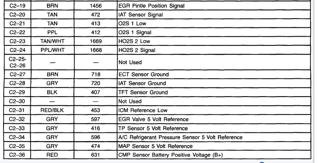

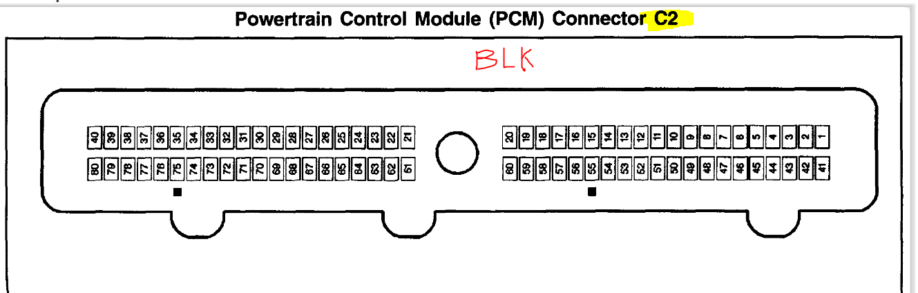

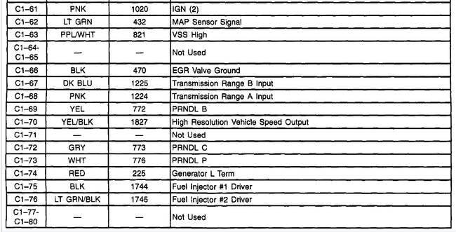

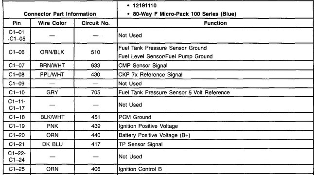

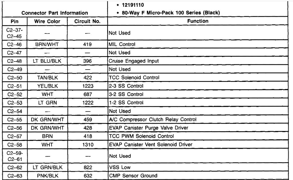

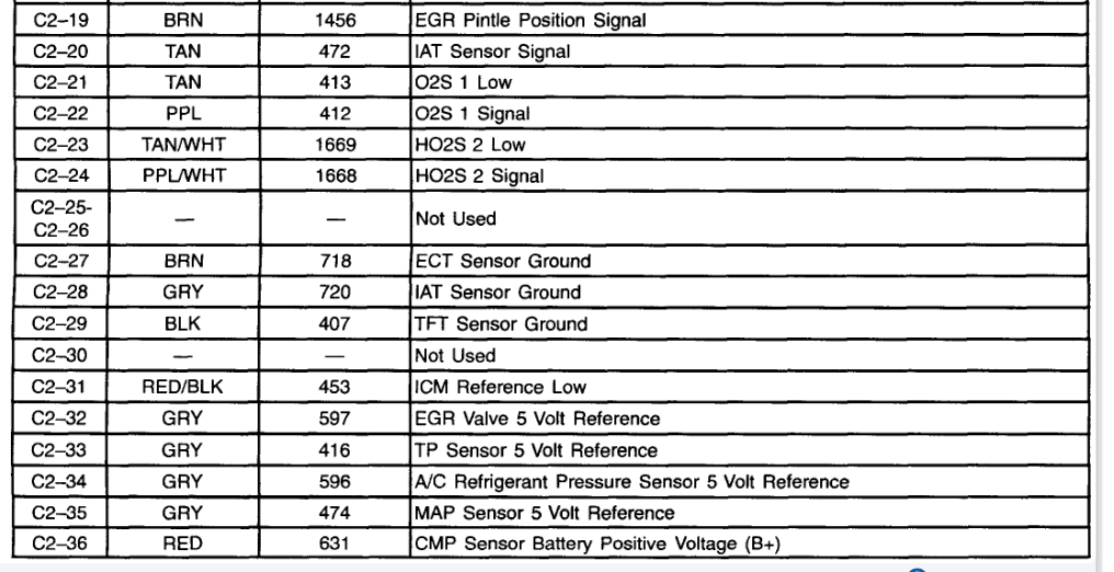

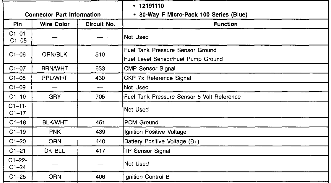

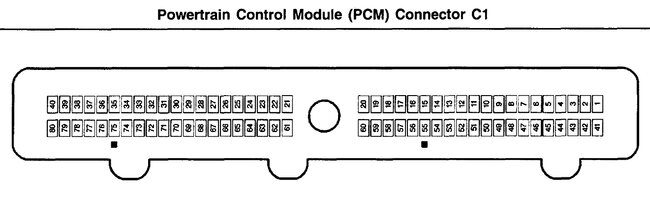

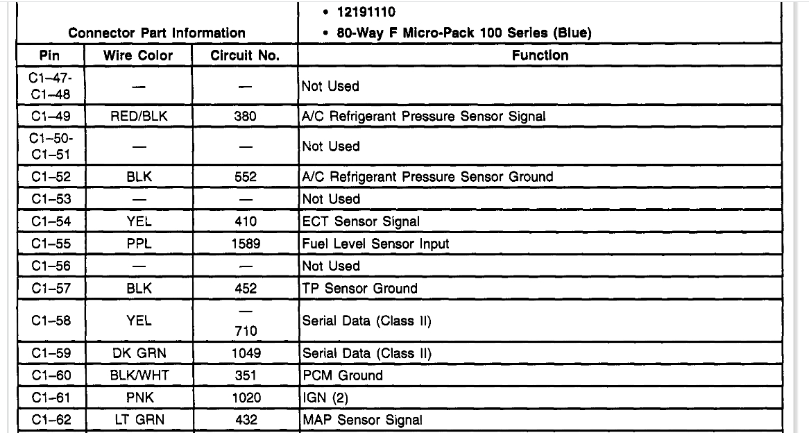

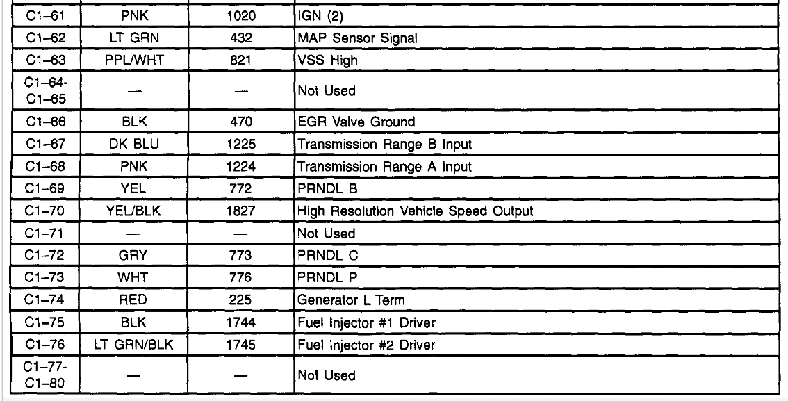

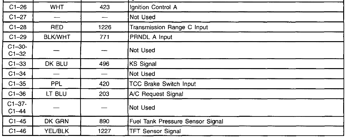

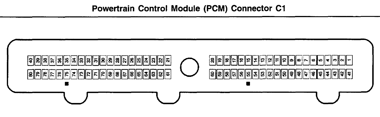

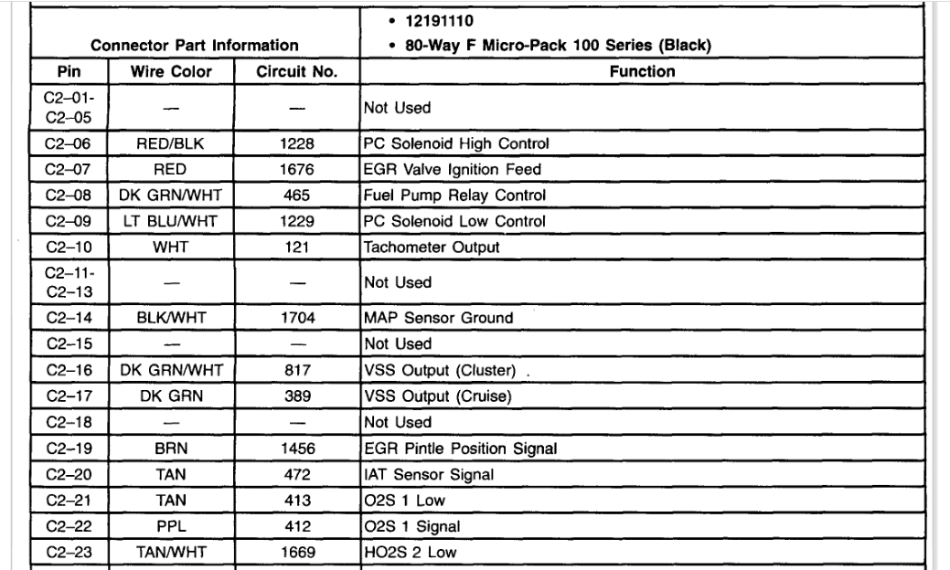

In need of pinouts for:
80-Pin PCM Connector C1Blue
80-Pin PCM Connector C2 Black
Apr 13, 2023 at 9:22 AM
Experienced Mechanic
110,248 POSTS
I attached the pin-out below for both connectors. The first five are specific to C1 and the remaining pics are C2.
To make everything readable, I had to cut the pages and enlarge them. So, the legends are a few pages long.
Images (Click to enlarge)
