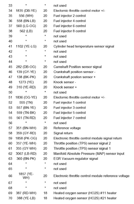

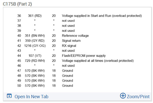

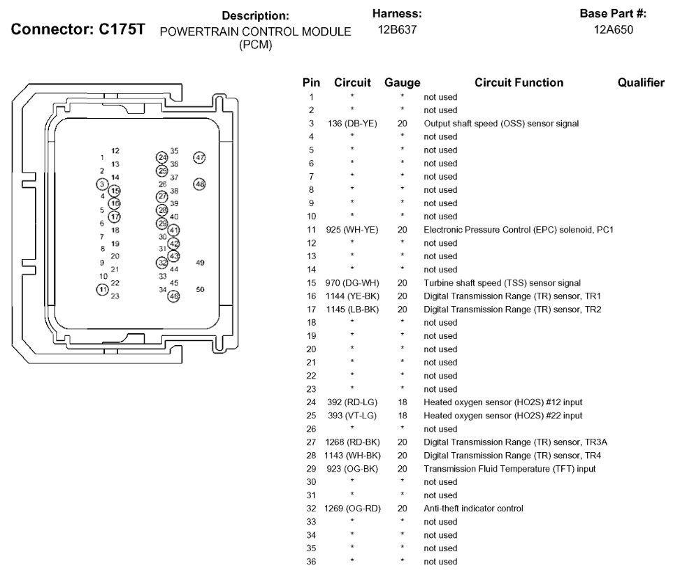

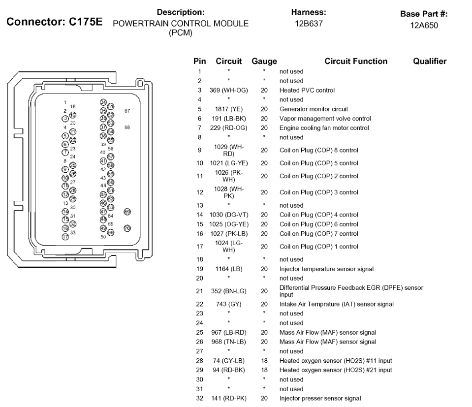

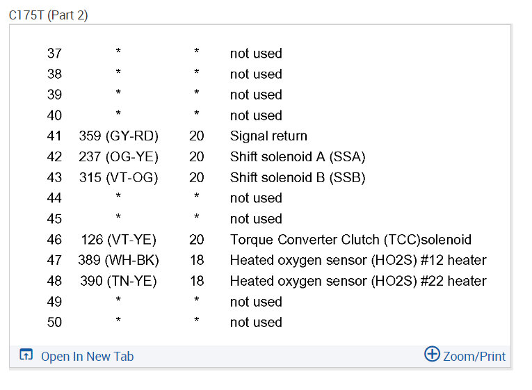

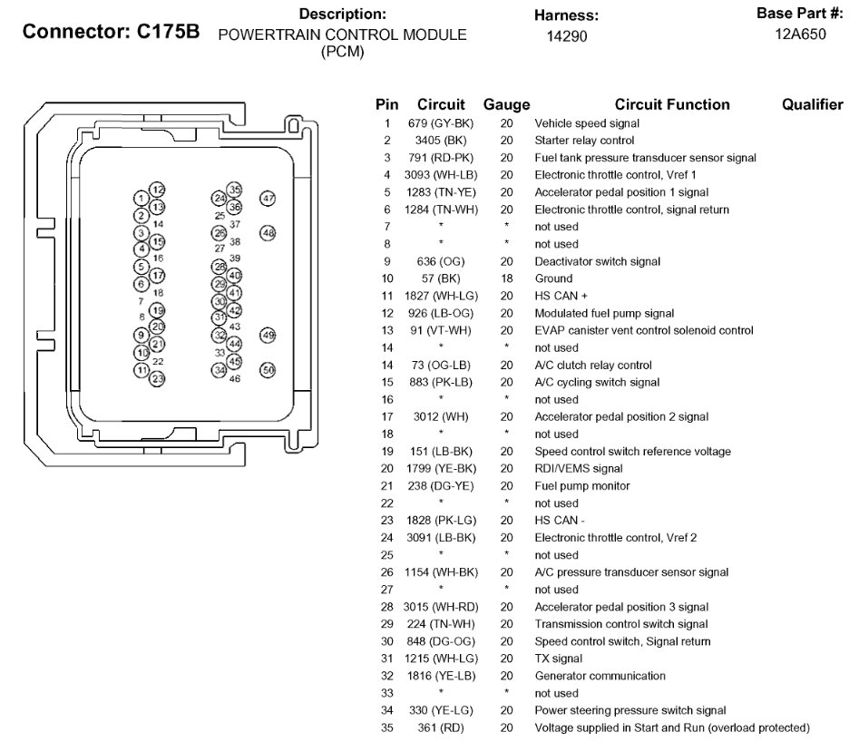

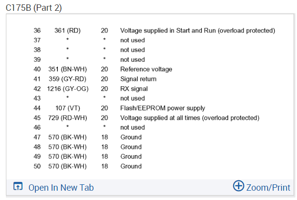

I am looking for PCM pinout for the car listed above, FFV.
Apr 15, 2024 at 10:31 AM
Experienced Mechanic
55,500 POSTS
Sure, here is the pin out for the PCM for your 2008 Grand Marquis. Check out the images (below). Let us know if you need anything else.
