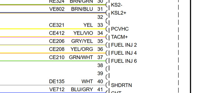

I need a PCM Pinout for my fuel injector #2. It is a Green/Yellow in slot #35. I have three plugs I don't know which one it is and the orientation of the plug to start my count...

I attached the connector views for all three. If you look at pics 3, 4, and 5, you will see that cylinder 2 injector driver is number 35 in the pic.
Let me know if this helps or if you have questions.
