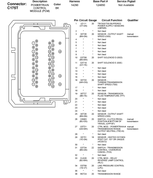

Code P0355, diagram for the PCM pinout needed?
2012 FORD ESCAPE
170,000 MILES • 3.0L • 6 CYL • 2WD • AUTOMATIC
JIMBO1256

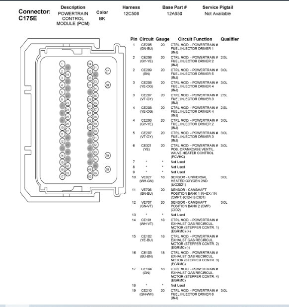

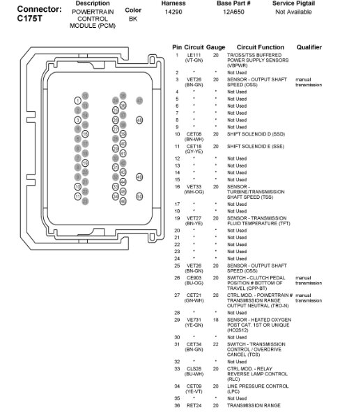

Where can i find a diagram for the PCM pinout on the vehicle listed above? I'm getting the code P0355, and I've changed the coil out 4 times now. I replaced the PCM and it's still doing it. Also, my A/C went out about the 2nd or 3rd coil going out. It feels like it's missing and is low on power. At about 45 MPH or higher it feels like it's stuttering when you accelerate.
Oct 1, 2023 at 7:17 PM
  • 110,193 POSTS

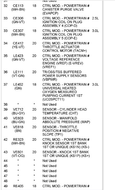

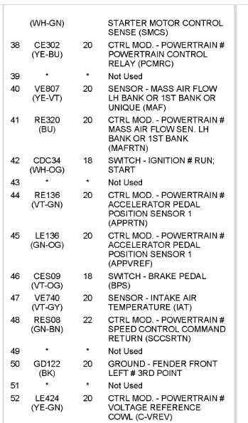

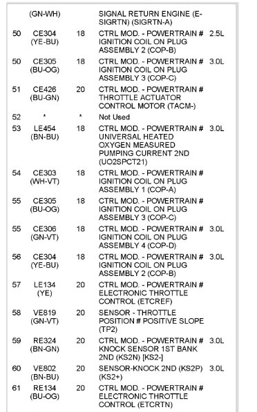

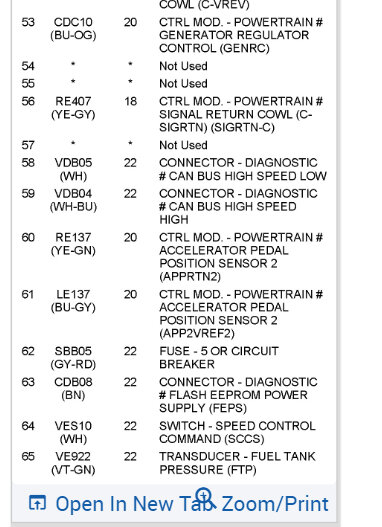

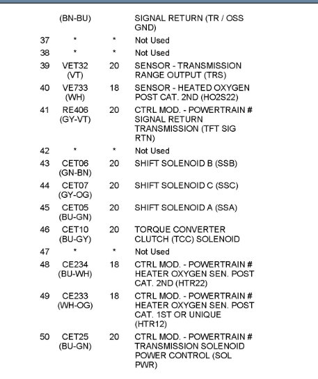

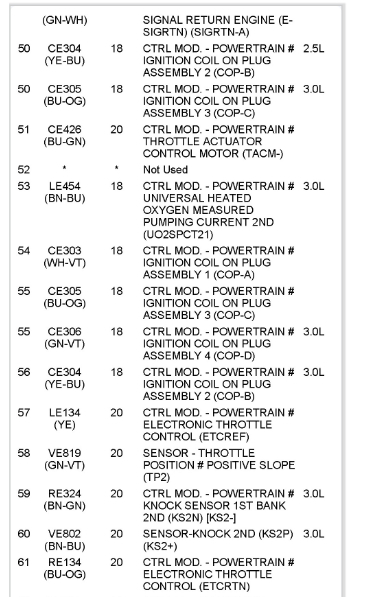

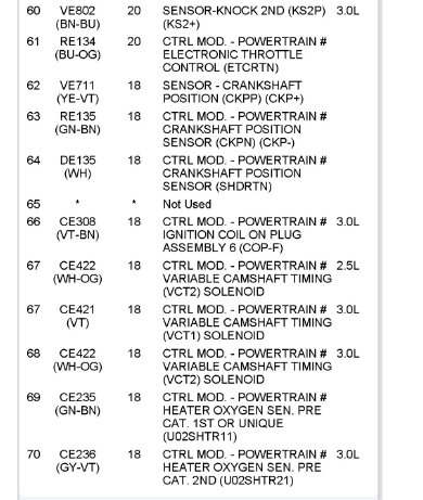

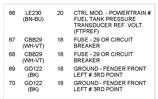

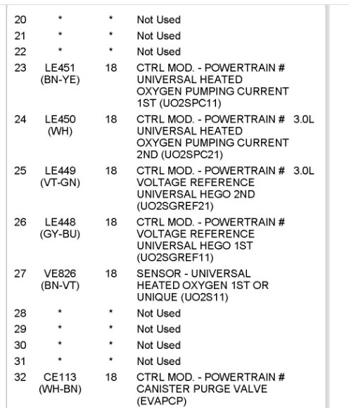

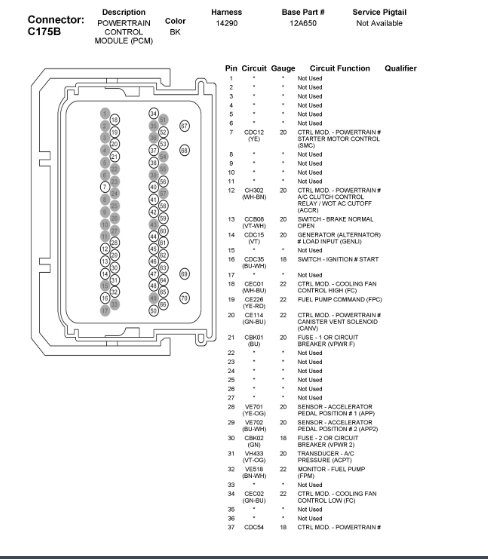

I attached the pinout for all of the connectors related to the PCM. Let me know if that is what you need or if you are looking for wiring.
As far as the pics below, there will be a picture with the connector followed by other pics. The other pics are the additional connector pin purpose beyond the first picture. There are a total of three connectors.
