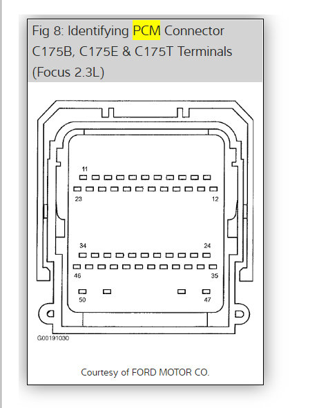

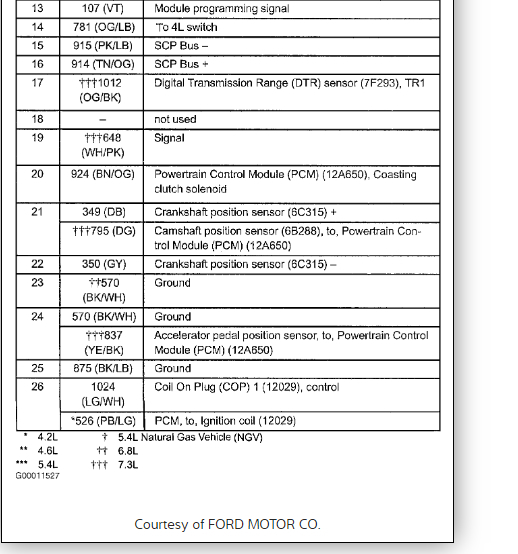

PCM pinout needed
BACKSTREETALLYCAT
  • 2003 FORD FOCUS
  • 2.3L
  • 4 CYL
  • 2WD
  • 5,000,000 MILES

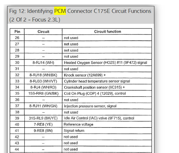

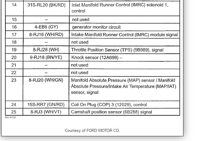

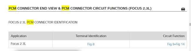

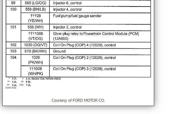

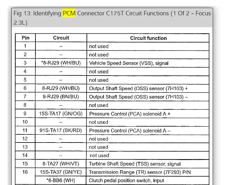

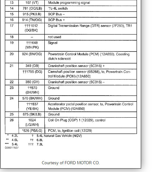

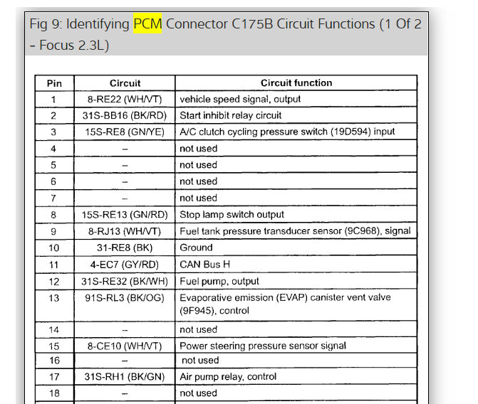

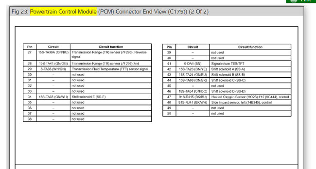

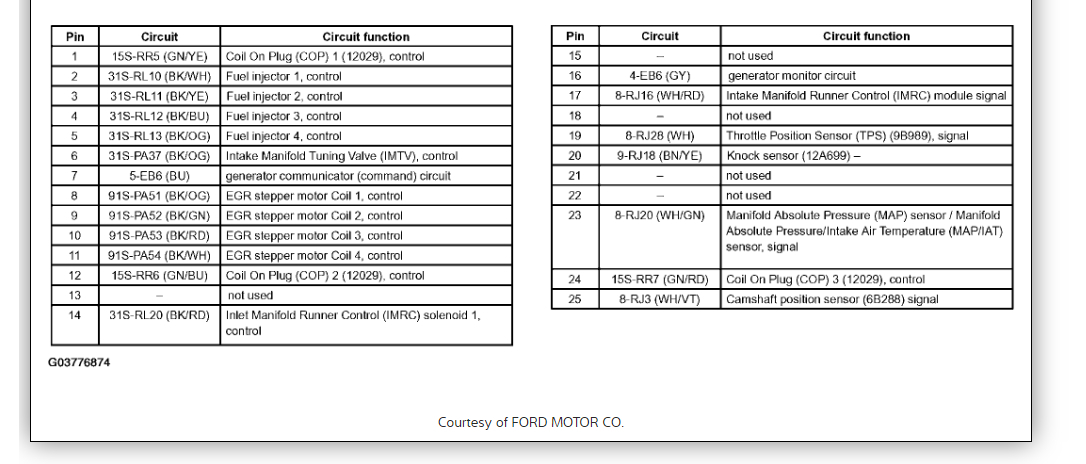

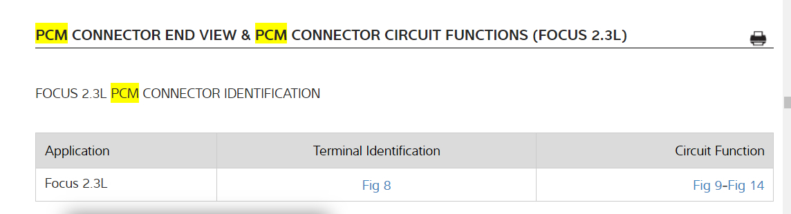

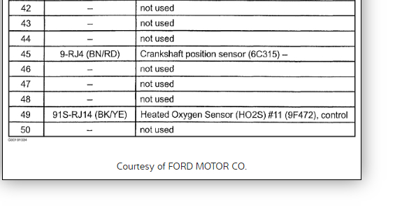

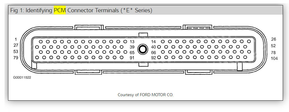

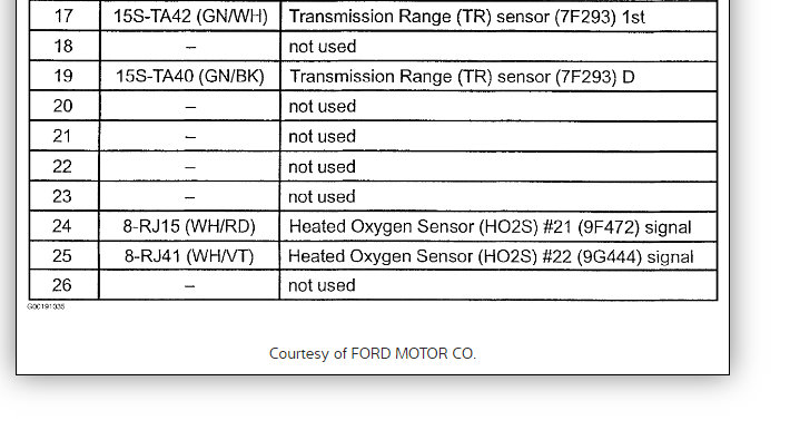

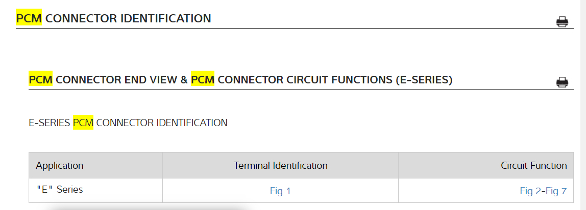

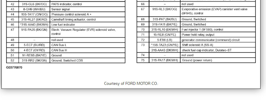

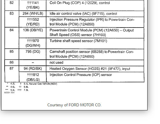

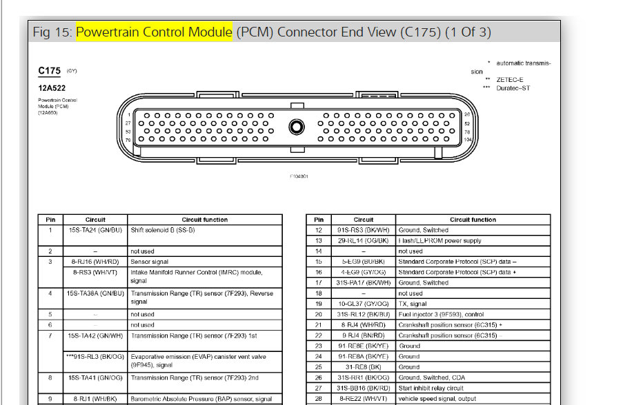

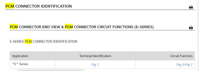

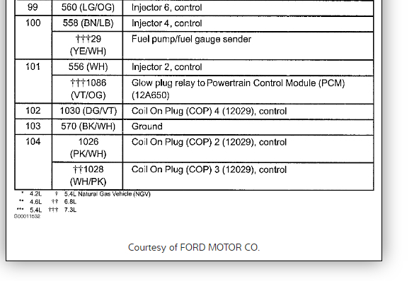

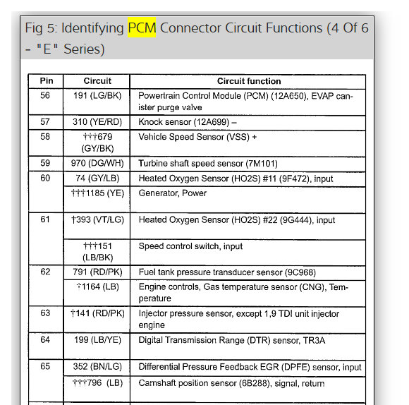

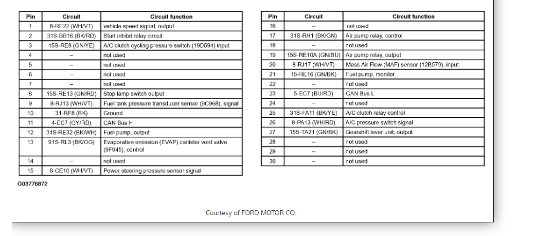

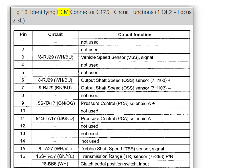

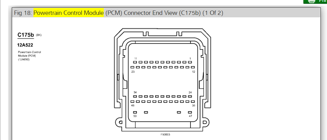

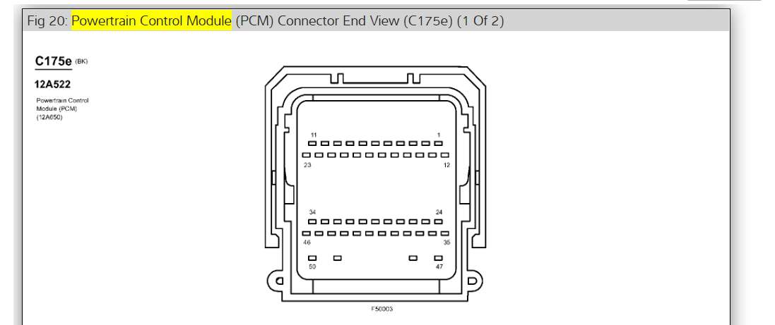

It has three plugs on it. I need to know which pin on which plug is for the camshaft position sensor.
Sunday, September 1st, 2019 AT 1:39 PM
SCGRANTURISMO
  • 4,897 POSTS

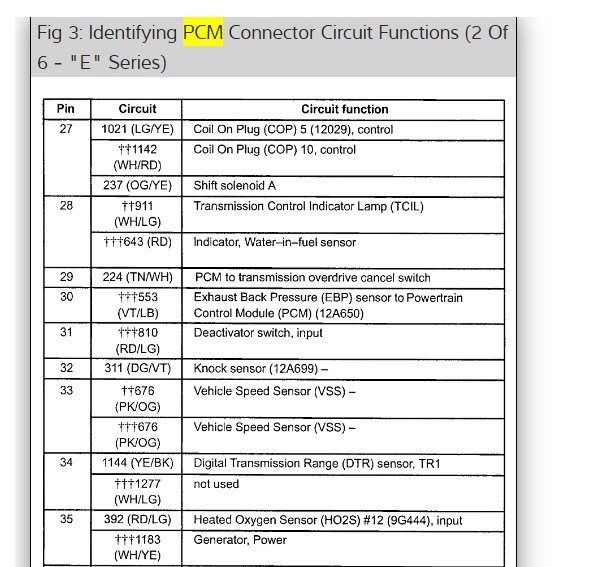

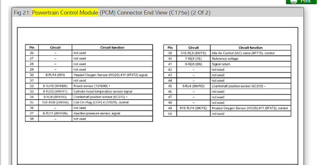

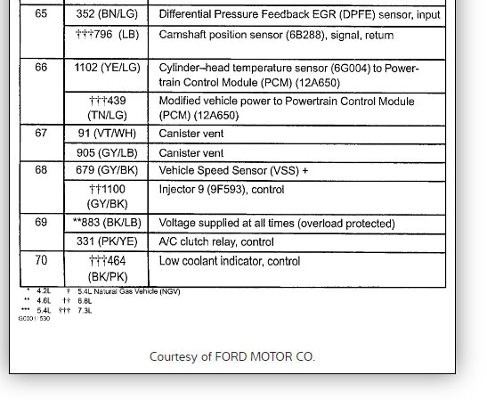

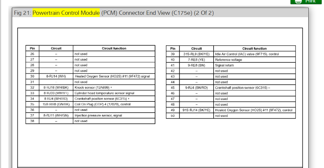

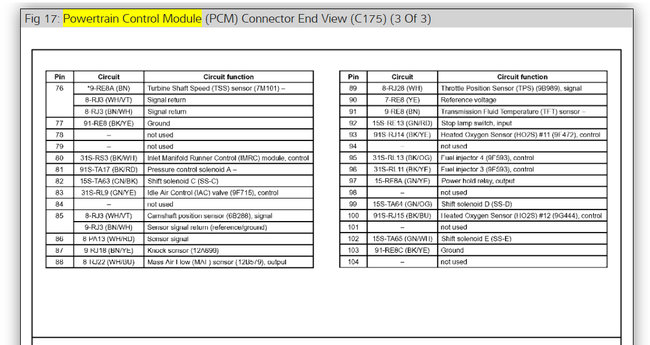

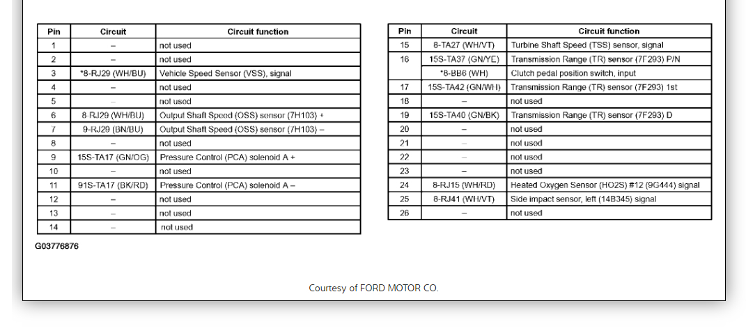

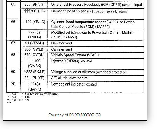

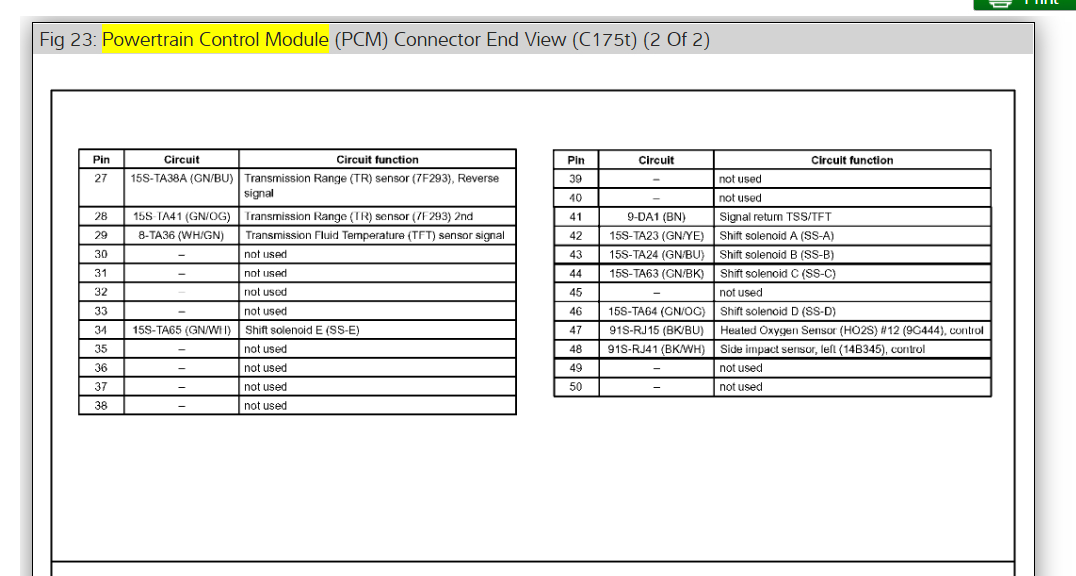

Okay, in the diagrams down below I have included all of the PCM Pinout diagrams for the Ford Focus. Please go through these diagrams and get back to us with how everything turns out.
Thanks,
Alex
