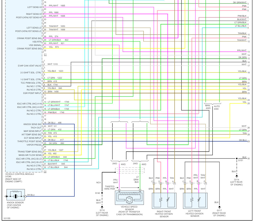

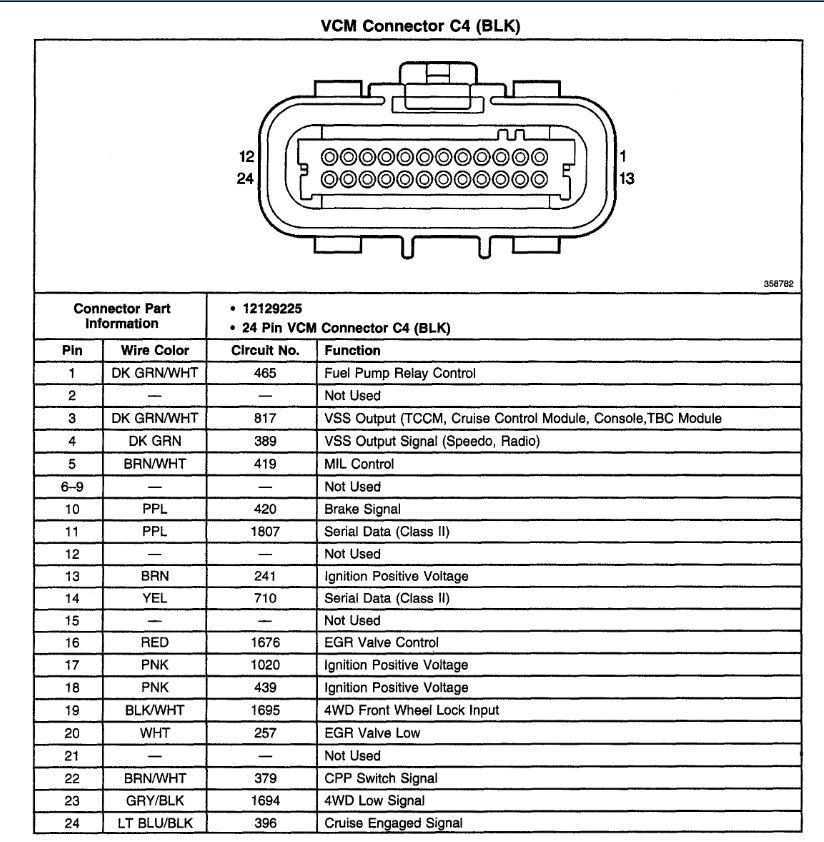

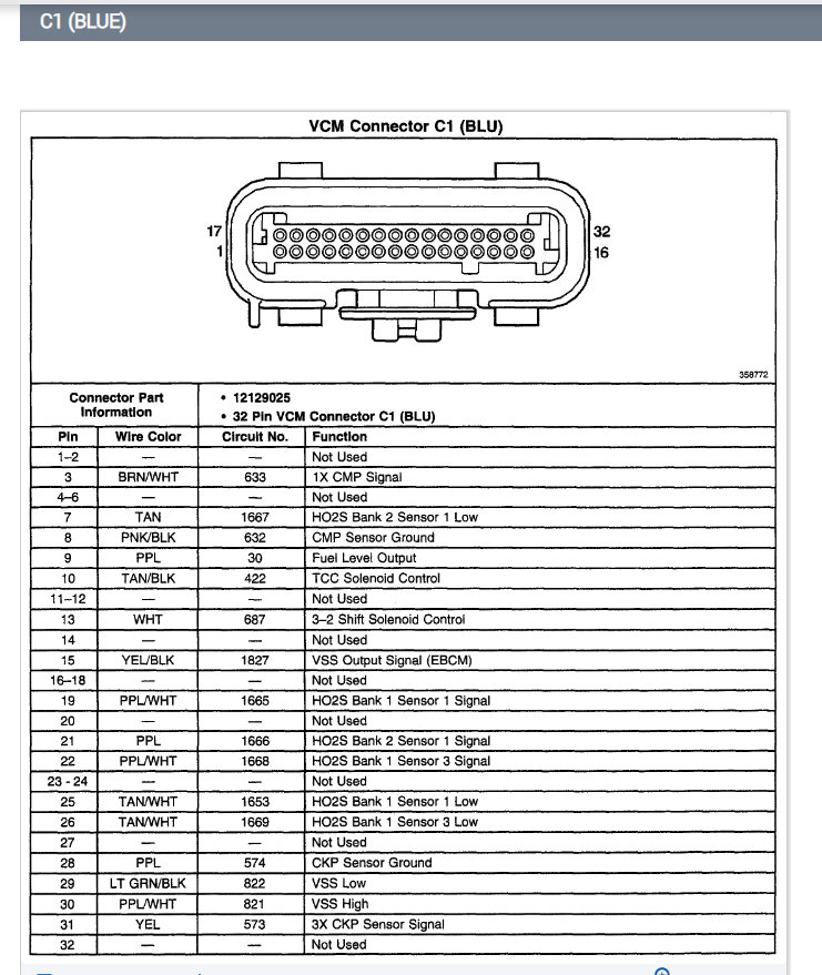

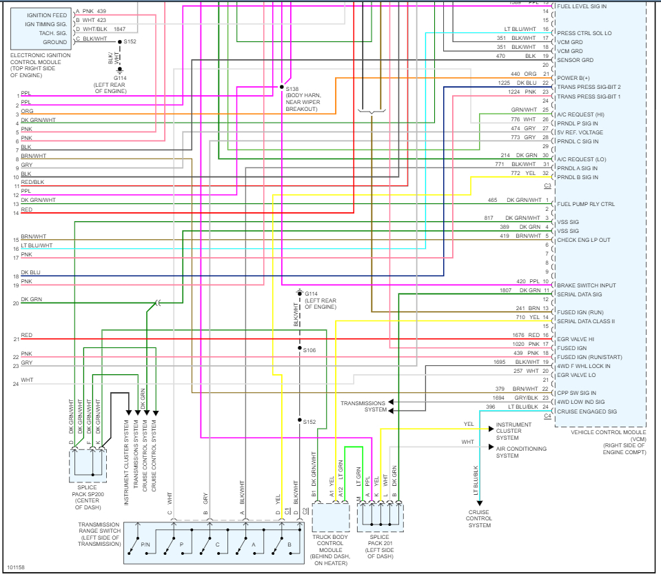

In need of pinouts for PCM connectors C1 blue and C2 black.
Thank you

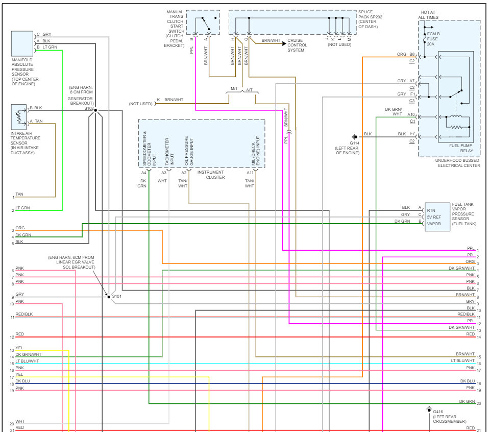

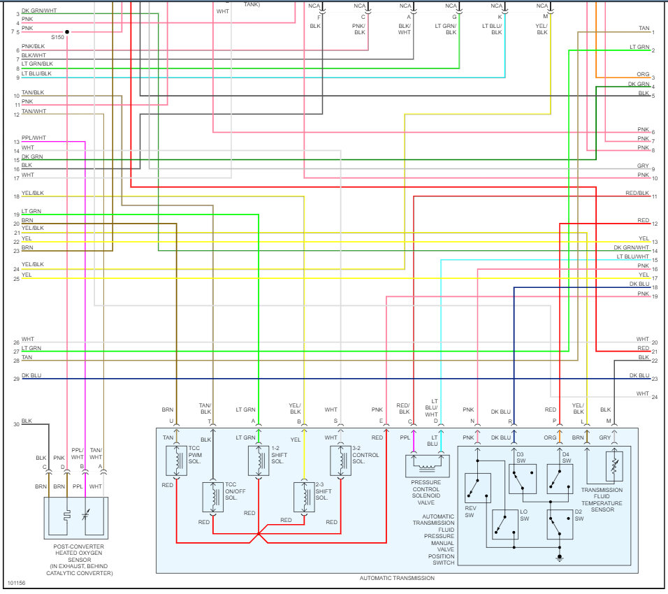

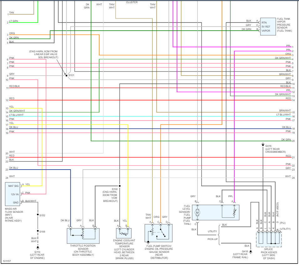

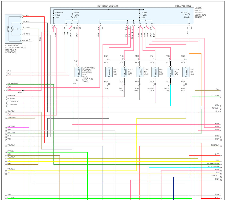

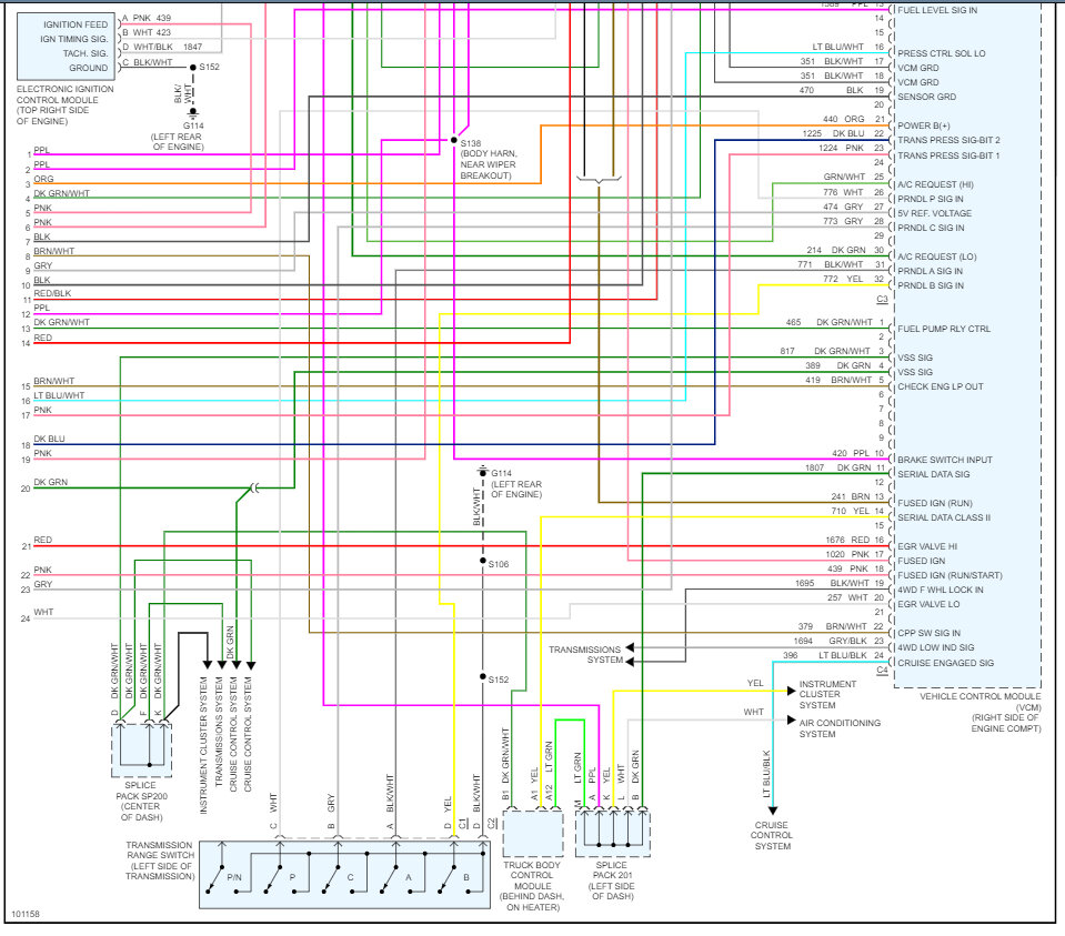

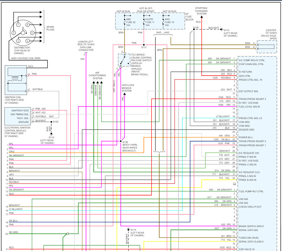

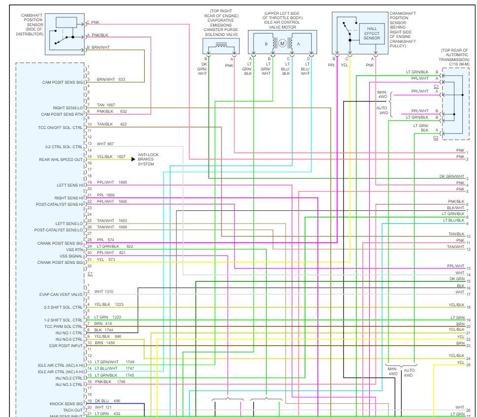

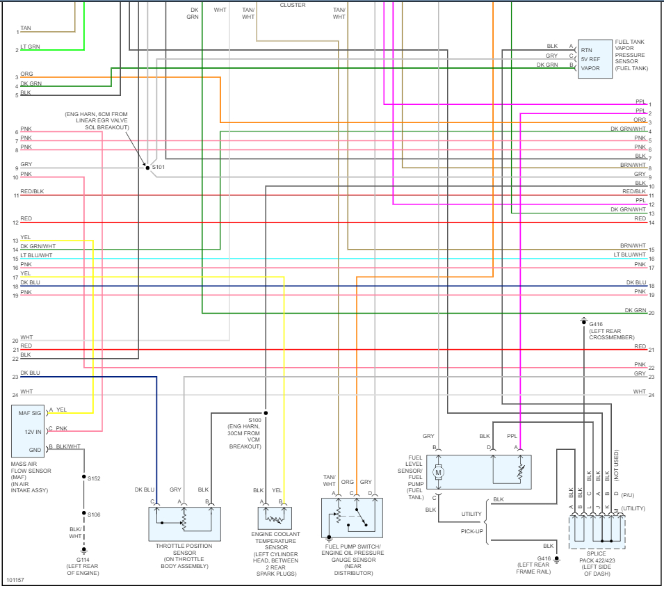

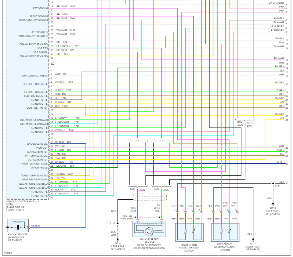

Here are the PCM wiring diagrams and the pinouts for the connectors you have requested. I have also included a guide to help you run some tests on the connections.
Check out the images (below). Please let us know if you need anything else to get the problem fixed.

Just looking for the 2 80-pin PCM connector pinouts. The VCM connectors provided do not match the connectors on the vehicle.

This is what they show. What is not right about them? Can you upload an image?
