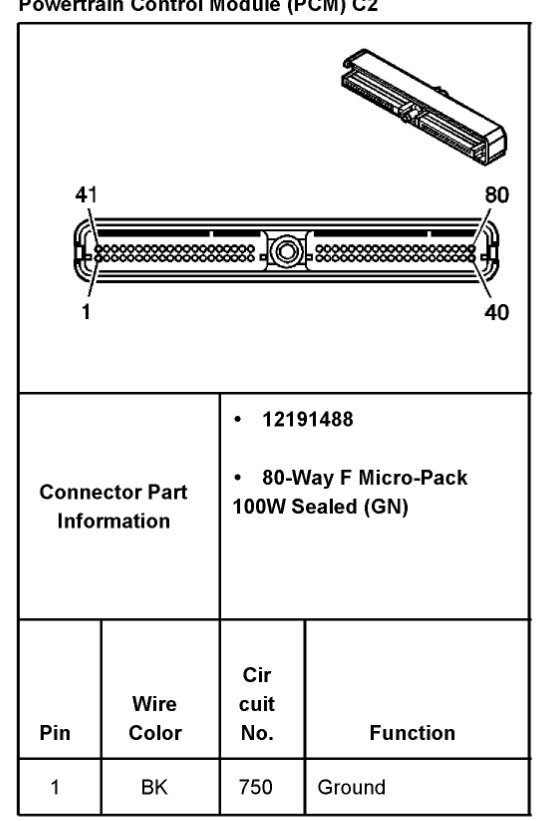

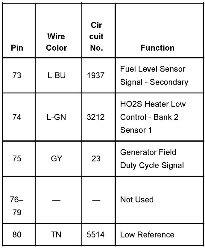

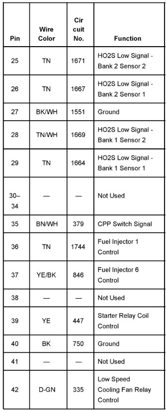

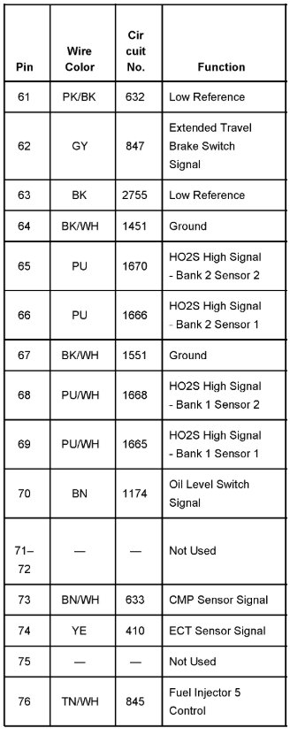

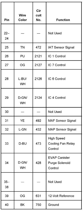

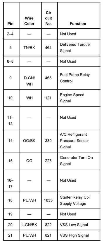

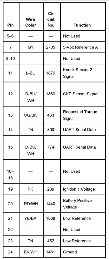

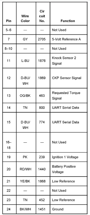

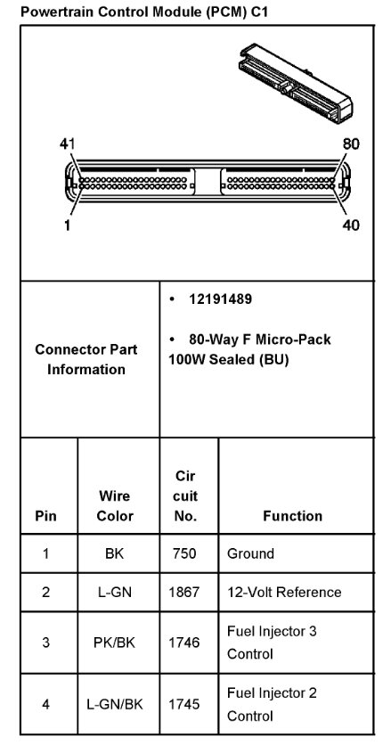

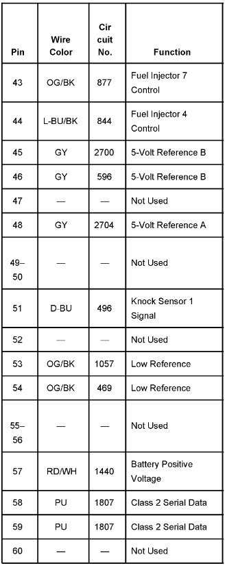

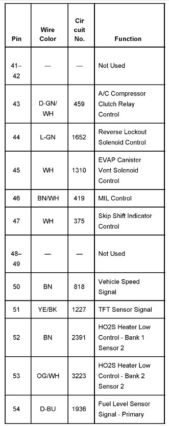

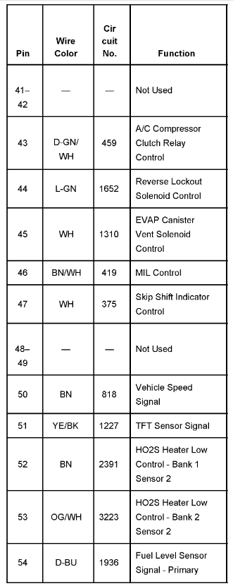

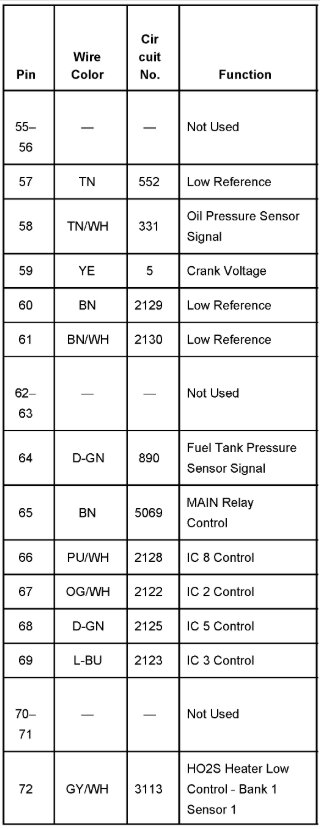

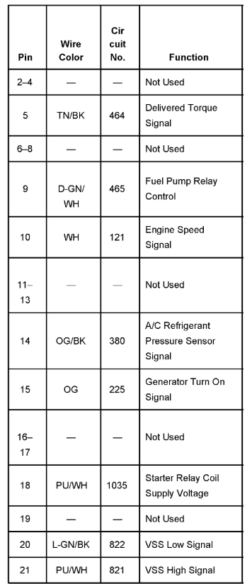

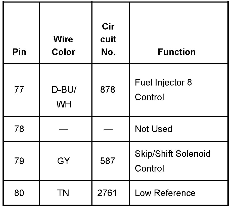

I'm looking for a PCM pinout for 2004 Cadillac CTS Northstar V8 cable drive vin 0

Hello, here are the pin outs for the PCM, Also this guide can help you test the connections if you need it.
Check out the images (below). Let us know if you need anything else.
