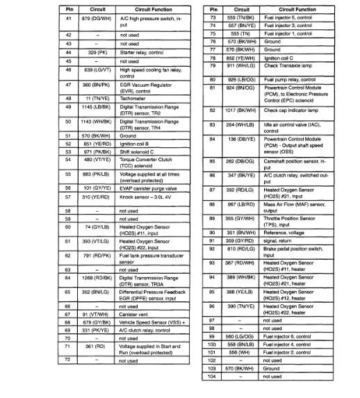

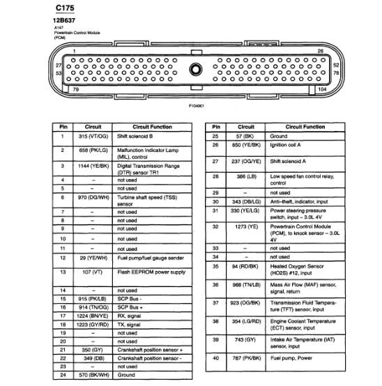

Hi, i just need the exact pinout of the PCM for my car. My car is the GS, it is the Vulcan with the ax4s transmission. Is it possible to get that harness diagram also that would be incredibly helpful? Thank you for your time.

I attached the pin out for the engine control module.
All the pins are marked and there function.
As far as the routing, there is no diagram for the harness routing.

Thank you, that is much appreciated. I don't need routing necessarily, just the circuits and how they're distributed.

The pin out will tell you the controls.

Okay. What wires are shared with what plug?
Jul 2, 2019 at 12:45 AM
As you can see there are over 100 wires.
What plugs? what wires?
