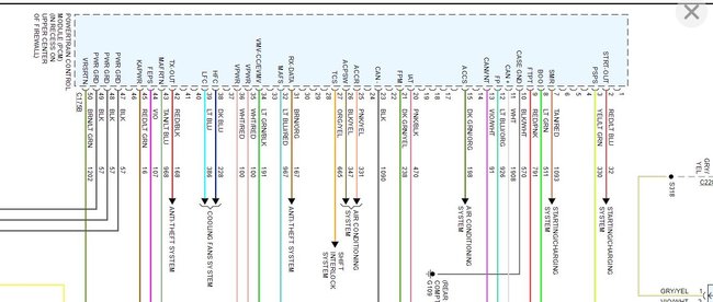

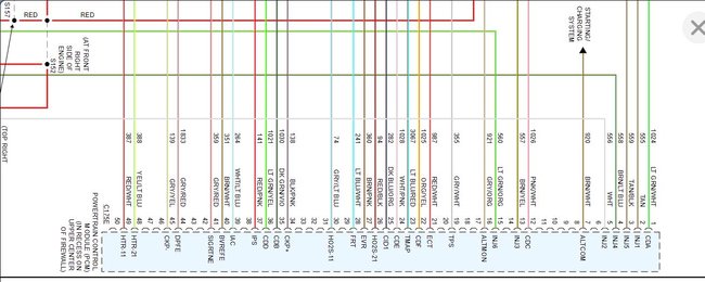

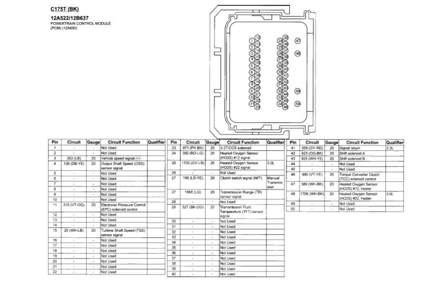

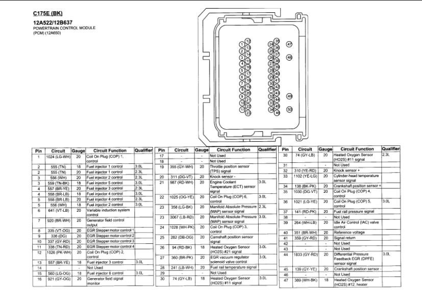

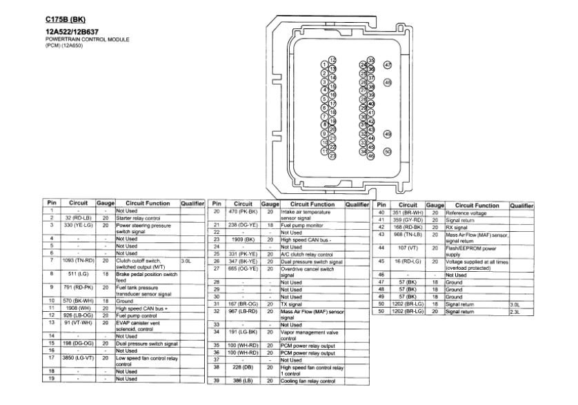

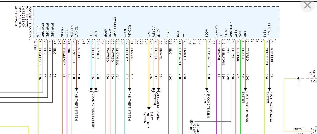

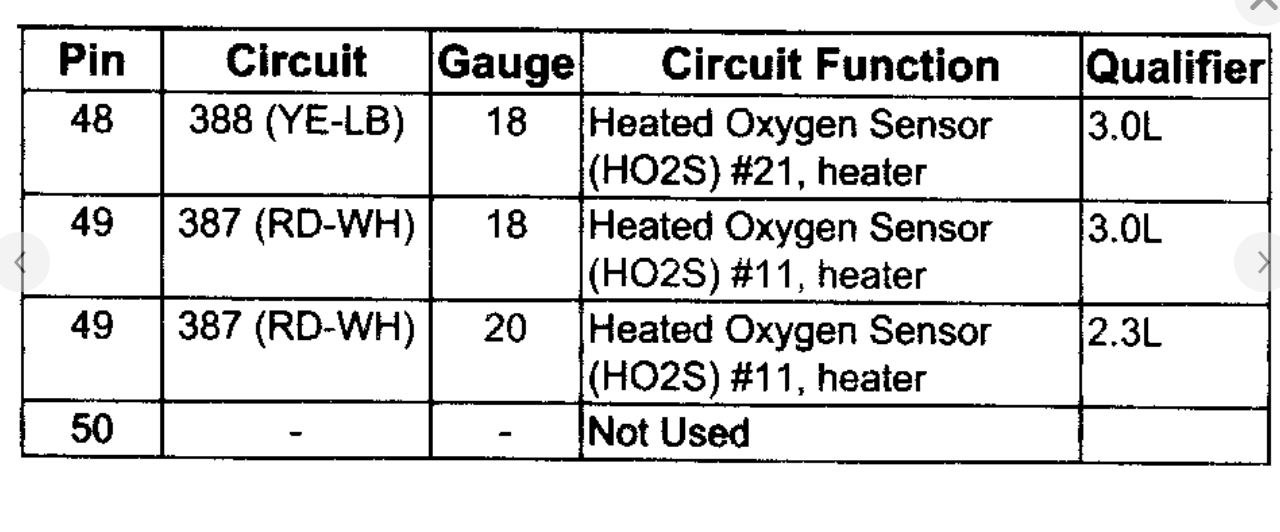

I am getting a P0511 code which is the IAVC Circuit. Could be a short in the wiring, so before I send the PCM off for repair, I'd like to use an Ohm Meter to trace the wiring from the connector to the PCM harness, but I have no clue which of the 3 harnesses it would be wired to nor the actual pin hole. Precision Tune charged me $75.00 after I had already told them that my OBD meter was showing a P0511 - Ughhh! Then they confirmed that the IAVC was "bad" and want $800.00 to replace it and clean the fuel injectors. I replaced the IAVC with a new one and have the same symptoms, so it's down to a wiring short or the PCM itself. The PCM has been repaired about 5 or 6 years ago for what I think was the same issue, but cannot remember, so before I send it off, I'd like to use an OHM meter to trace the wires back to the harness first but don't know which harness of the three nor the pin holes the IAVC would be wired to. Any help is most appreciated. I am not a professional, but I know enough, growing up with a certified mechanic.

I attached both the pins and the identification and the diagram of the ECM and the controls for you to view.
Let me know if you have any other questions.

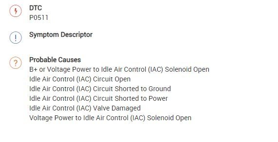

I also attached the flow chart for the 511 code for you as well.
