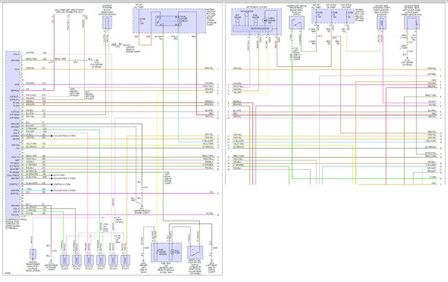

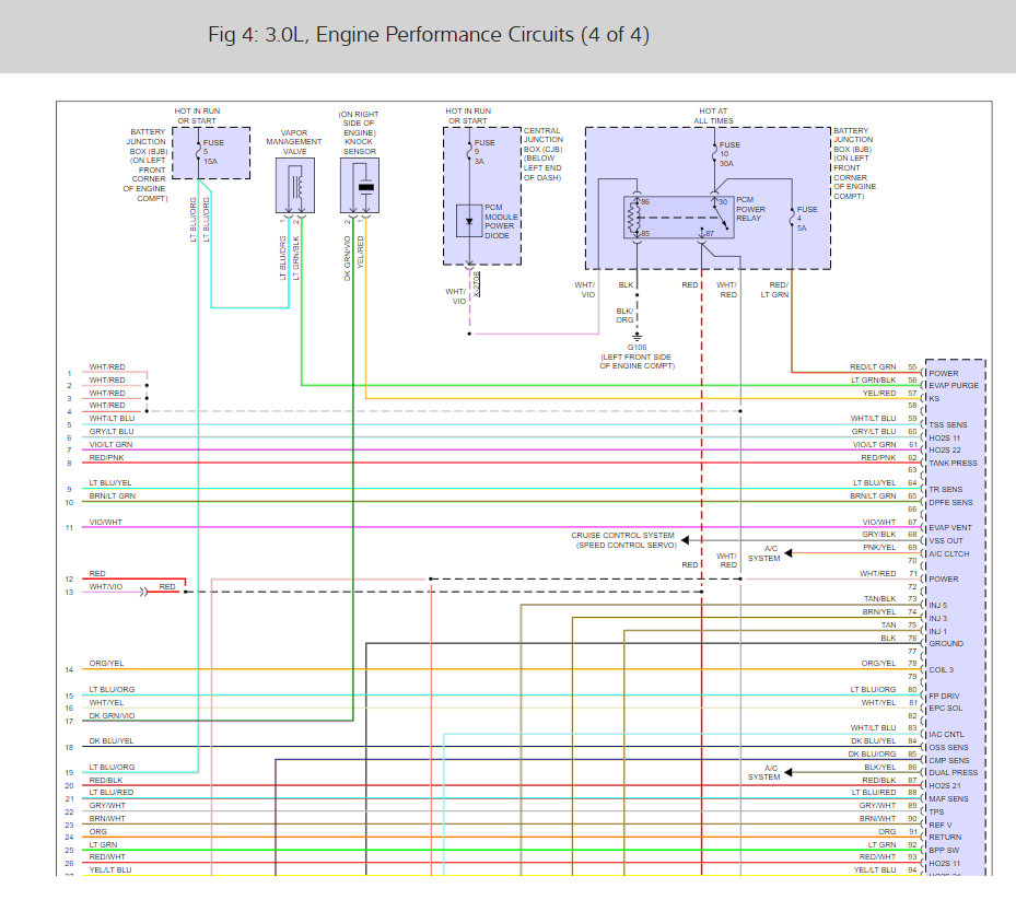

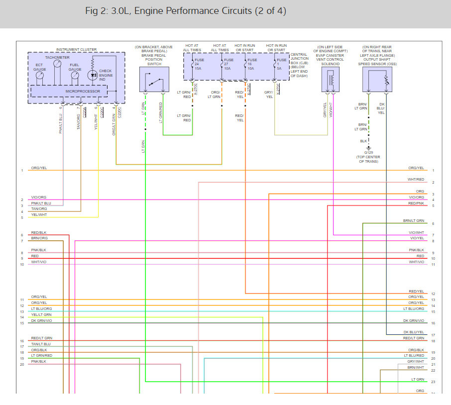

Was hoping you could provide me with some pin out information from a previous question you helped with.
https://www.2carpros.com/questions/ford-escape-2001-ford-escape-pcm-pin-out-diagram

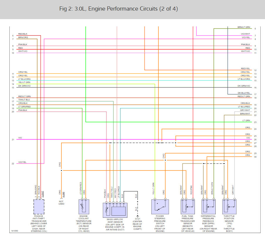

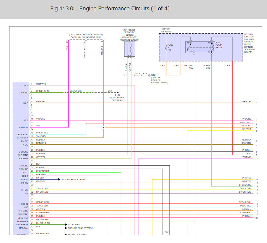

In that question e pin out pictures were hosted. I was able to find all but the second half of -> Fig 2: 3.0L, Engine Performance Circuits (2 of 4).
The previous owners of the 2001 Mazda Tribute have botched the cooling fan wiring and I am wanting to make it right.
Thank you for any help you can provide,
Jared

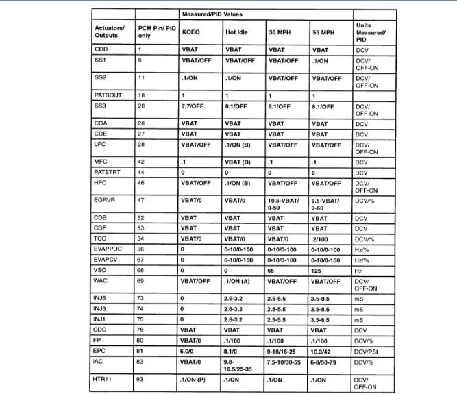

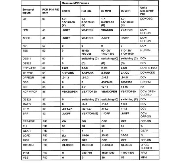

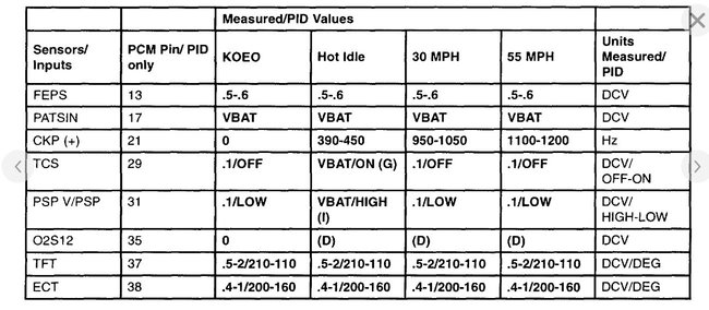

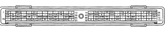

Attached are the pin outs. Let me know if you need anything else.

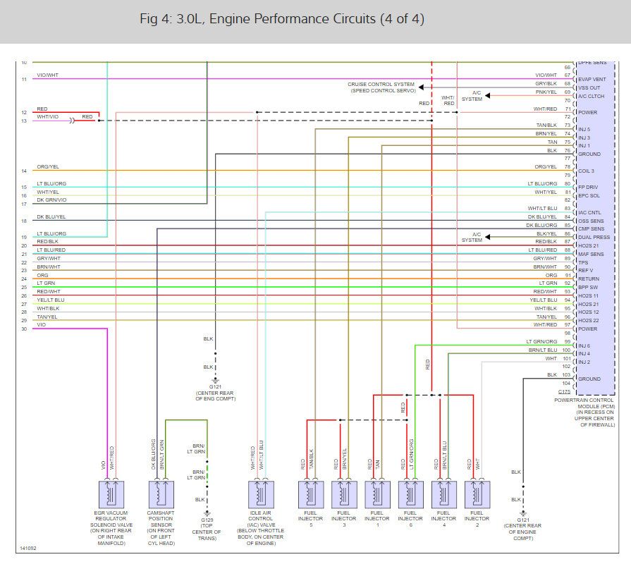

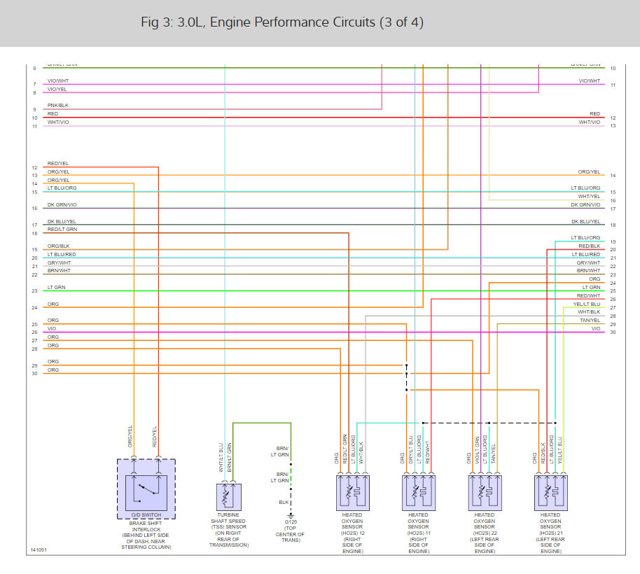

Thanks Roy, those are useful, but not exactly what I am looking for. In the included picture you can see the second half of the picture is missing everything below line 20. In my original post there is a link to a previous question where Ken was able to provide diagrams that were split in two, 4 diagrams in total but 8 pictures. Was able to combine them but the second half of the second diagram is missing. If a link can be provided to the source of these diagrams it would be supremely helpful.

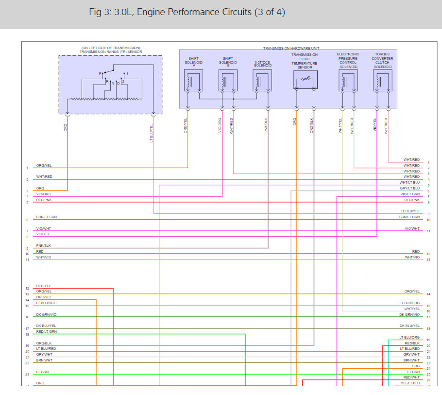

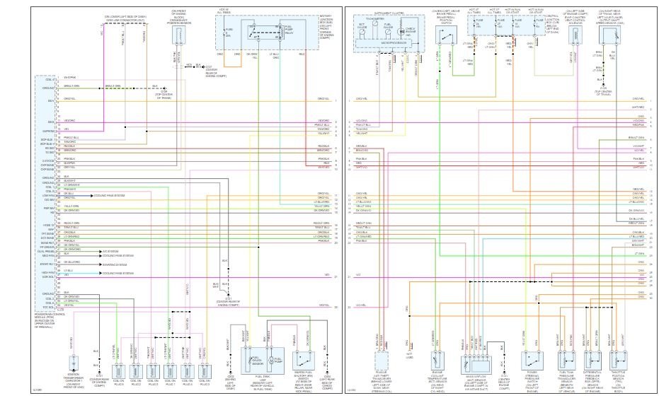

I found the engine wiring diagrams (below) you are looking for with a guide that shows you how to test the connections.
Sep 7, 2018 at 4:55 AM
I combined the diagrams together for you.
Sep 7, 2018 at 6:18 AM

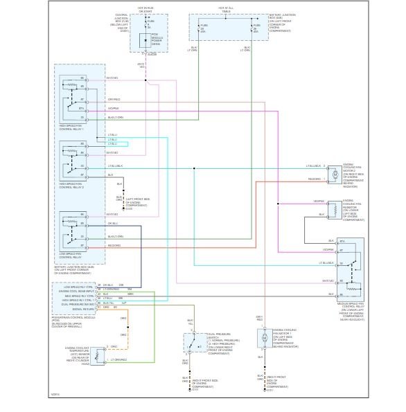

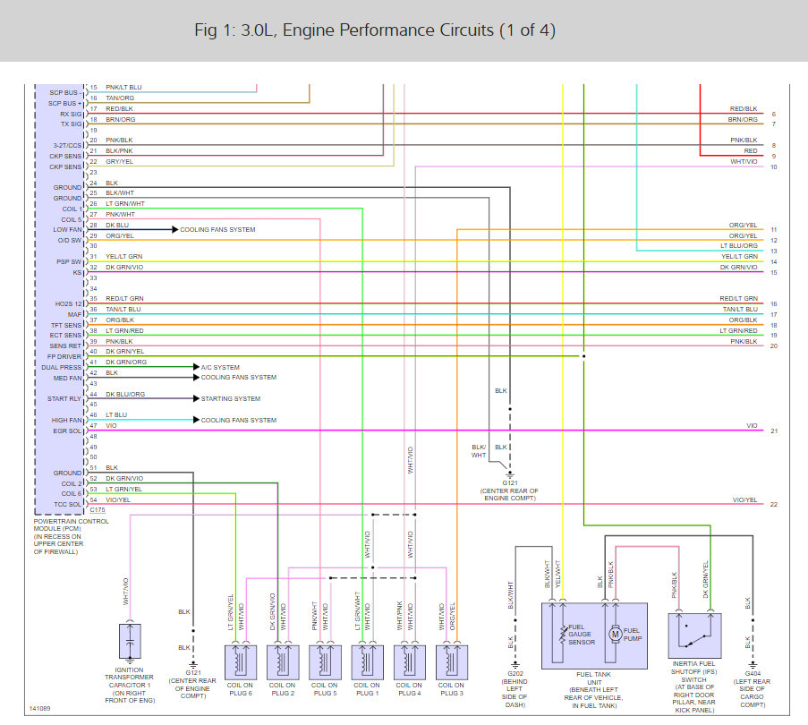

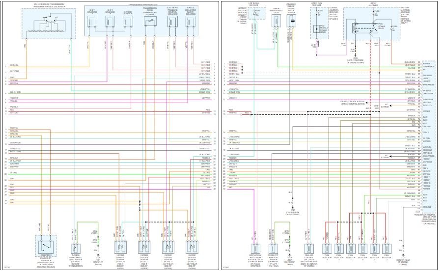

These are great! Are there any you can provide which include the cooling fan relays/motors/resistor? Unfortunately the Tribute has a four relay system, not the three relay of the Escape. Thank you, truly. Any chance you can provide the source of these diagrams? I am not opposed to paying for such great documentation.
Sep 7, 2018 at 6:33 AM
These diagrams come from Alldata. You can get a pass to the site on line by getting a subscription. They offer daily and weekly passes.
Attached is the diagram for the fans.
