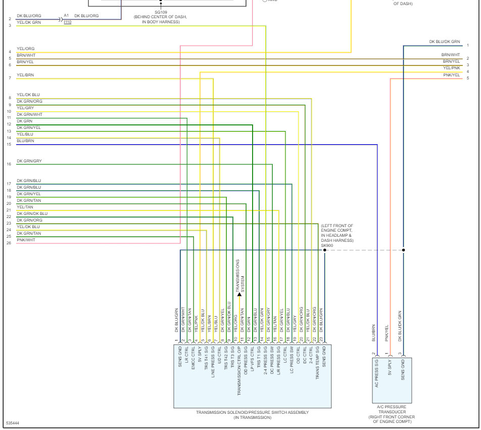

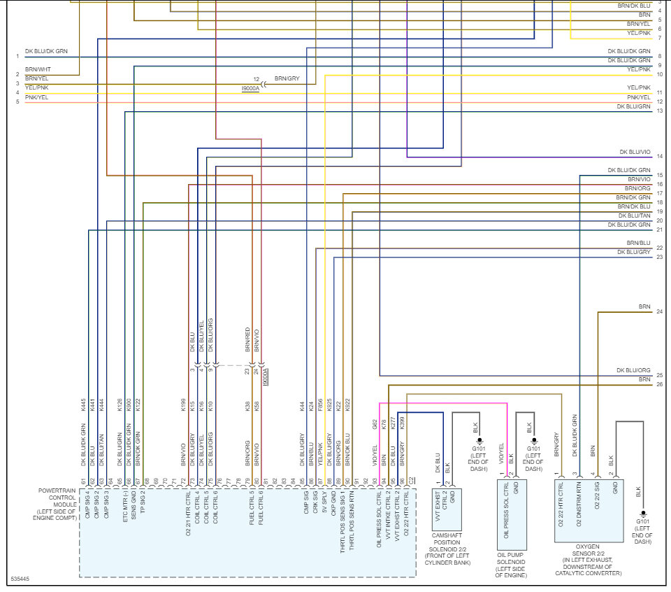

I need a PCM pinout for the vehicle listed above Crossroads 2WD. I have been fighting low voltage and have replaced the battery, alternator, wiring harness and still can't seem to maintain more than 11.7 Volts.

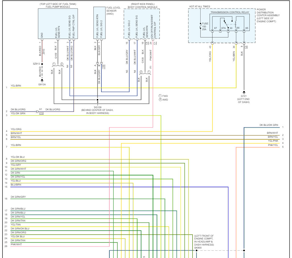

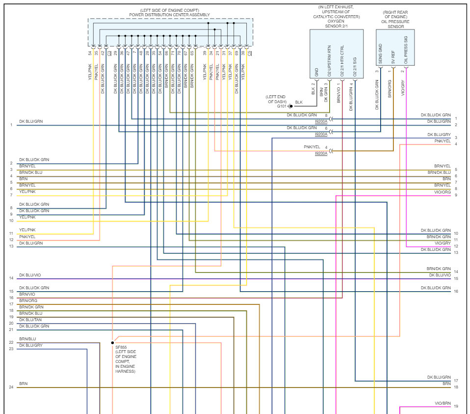

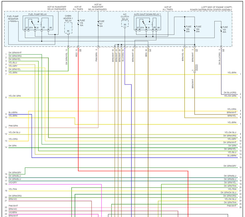

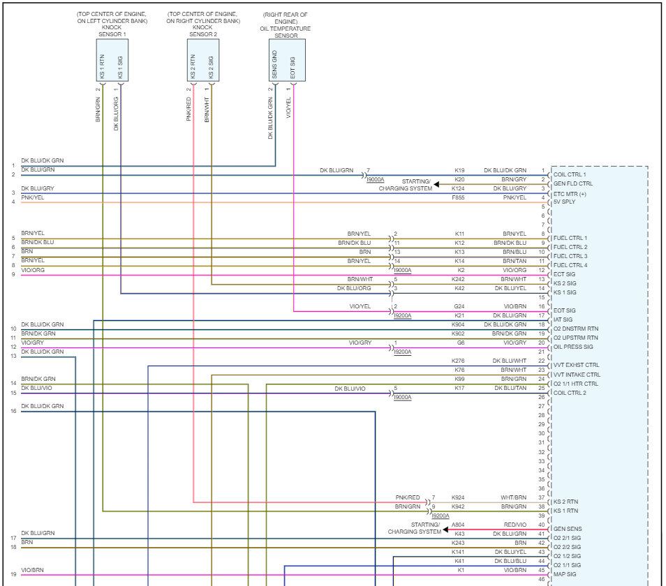

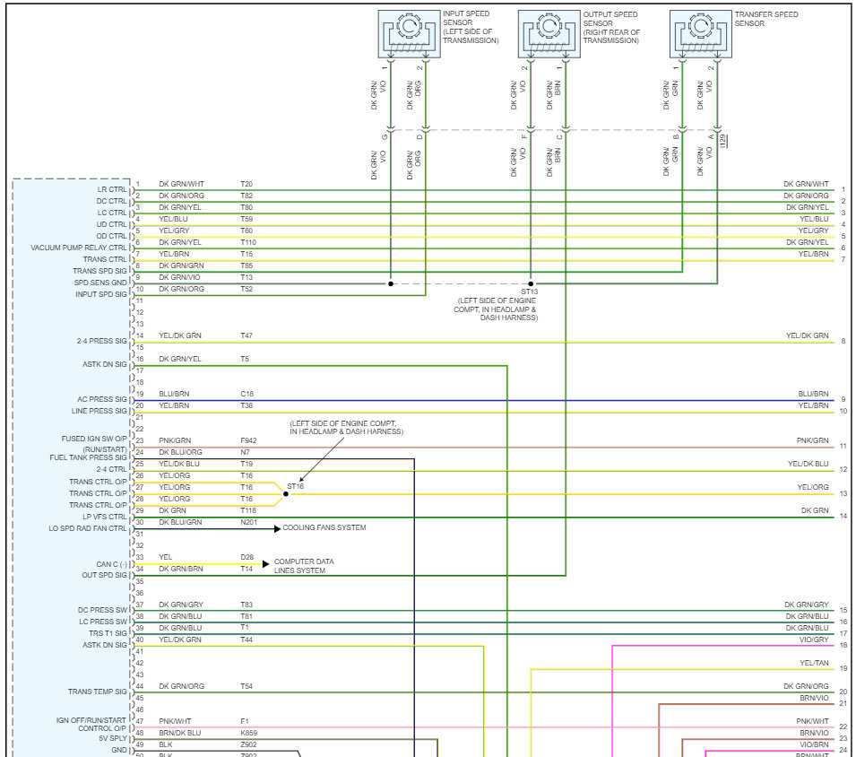

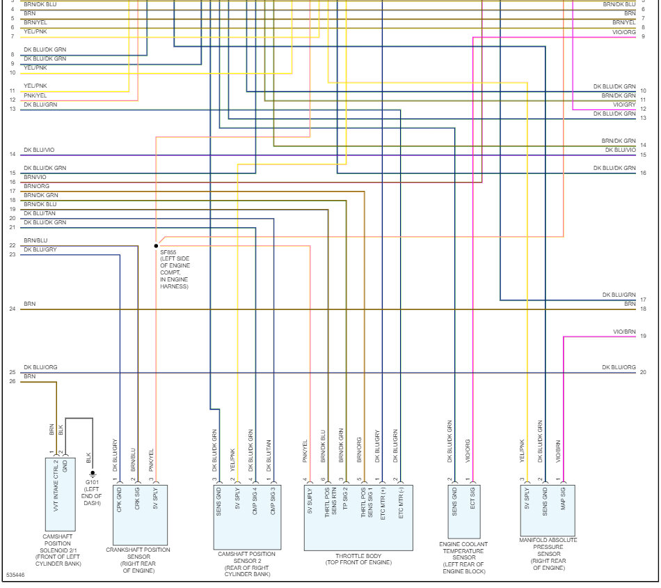

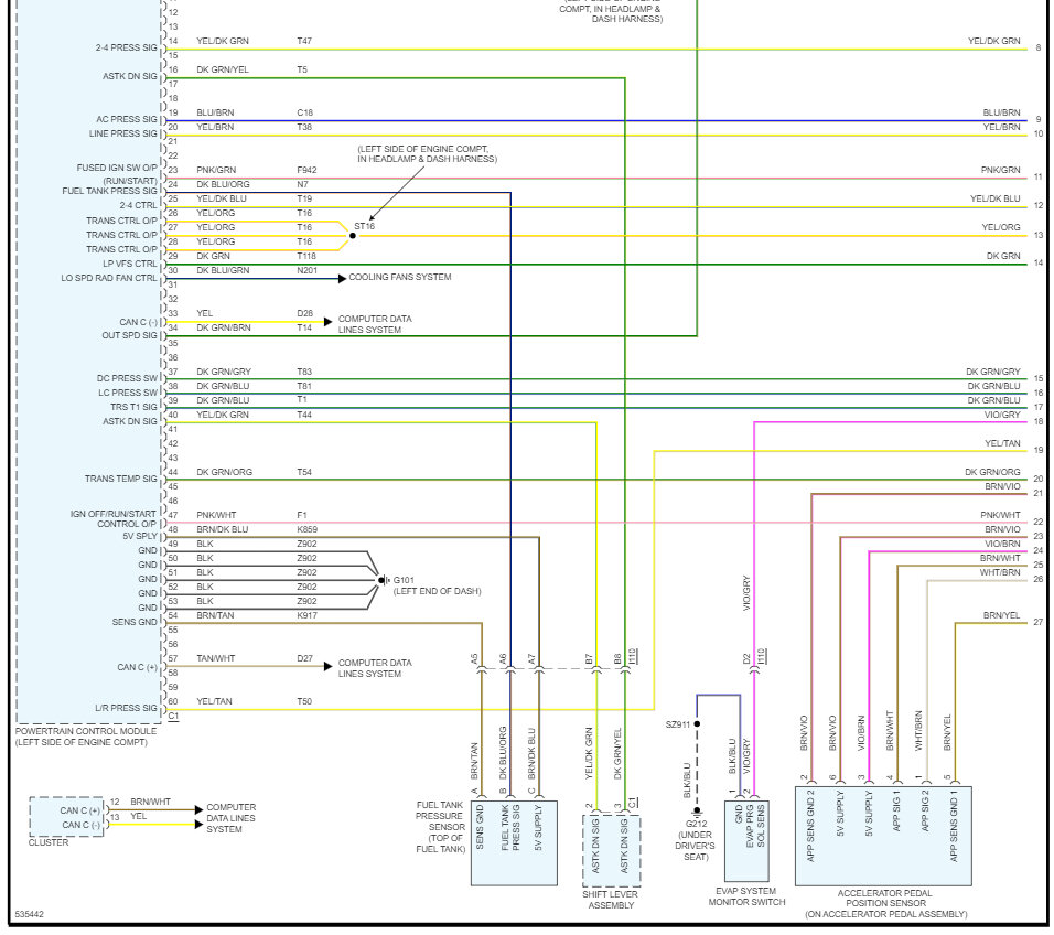

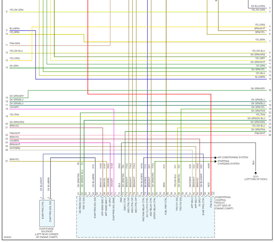

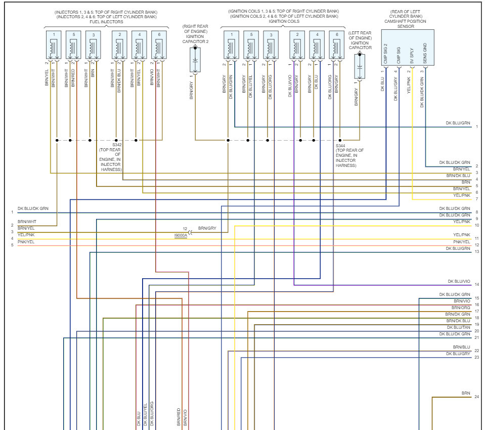

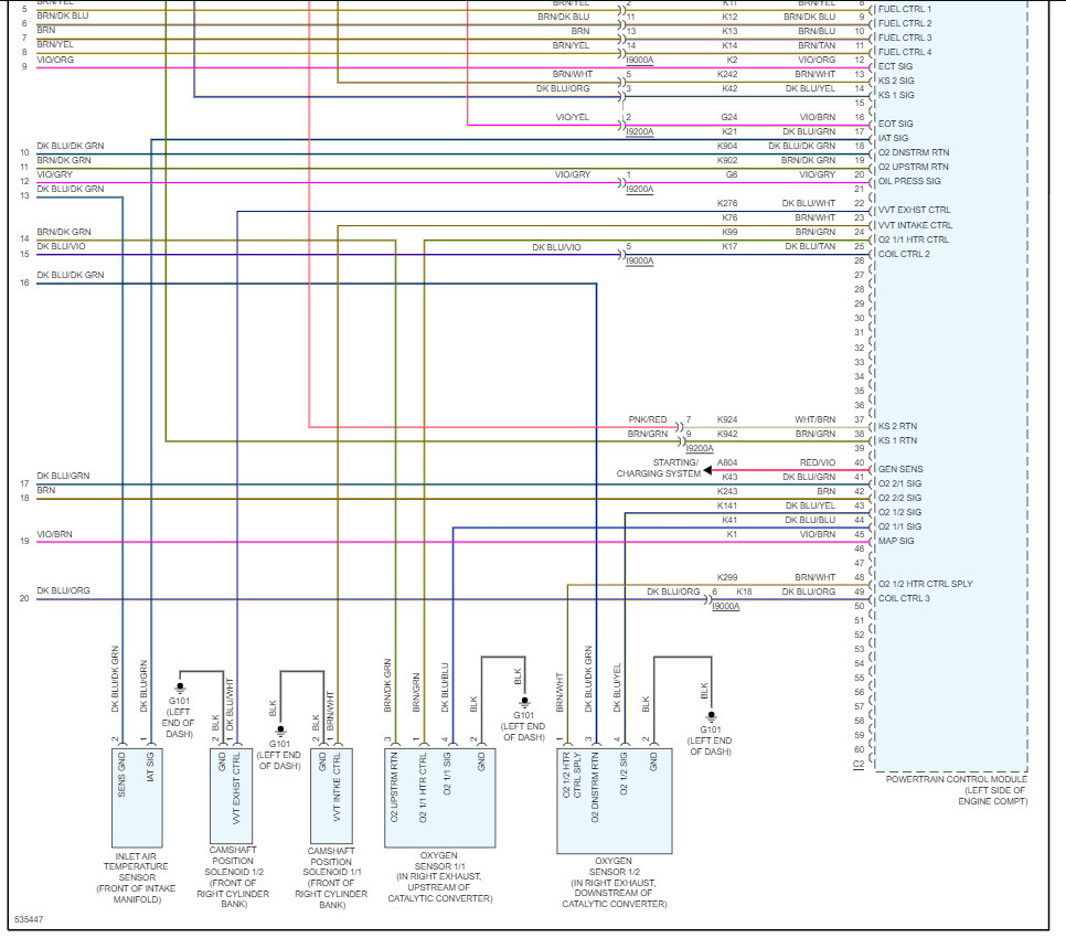

here is the PCM wiring diagrams as you have requested:
This guide can help you test the connections. Check out the images (below). Please let us know what you find.
