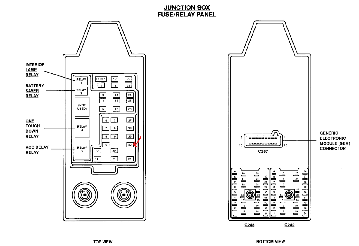

PCM is not powering up when I turn on the ignition switch. I replaced it with a new one but it still not working. At first, I thought it was the coil pack, so I replaced it still wouldn't start. Then replaced the crankshaft sensor and the cam sensor. Tracked it down to the no power to the PCM. Need help tracking down the problem.
Dec 25, 2024 at 10:24 AM
  • 55,433 POSTS

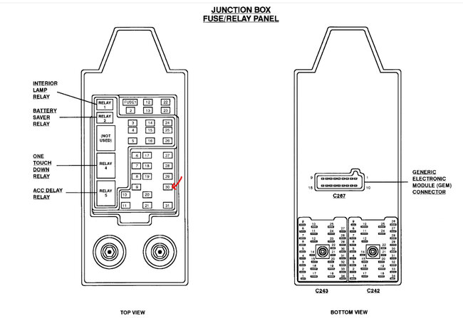

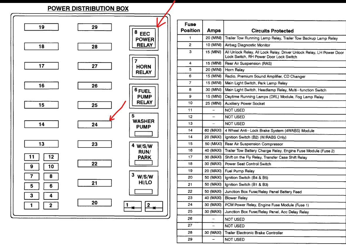

The first thing I would do is check the fuse # 24 in the fuse panel under the hood and if that is okay let's swap out the PCM power relay to see if the PCM gets power. here are the locations of the fuse and relay. Check out the images (below). Please let us know what happens.

I have already done that; the fuse and relay are getting power. I'm not getting power from the ignition switch to the under-dash fuses or the PCM. Can the ignition switch cause this problem?
Dec 26, 2024 at 9:50 AM
  • 55,433 POSTS
Does the EEC relay click when you turn the key on?

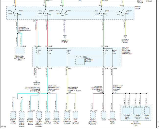

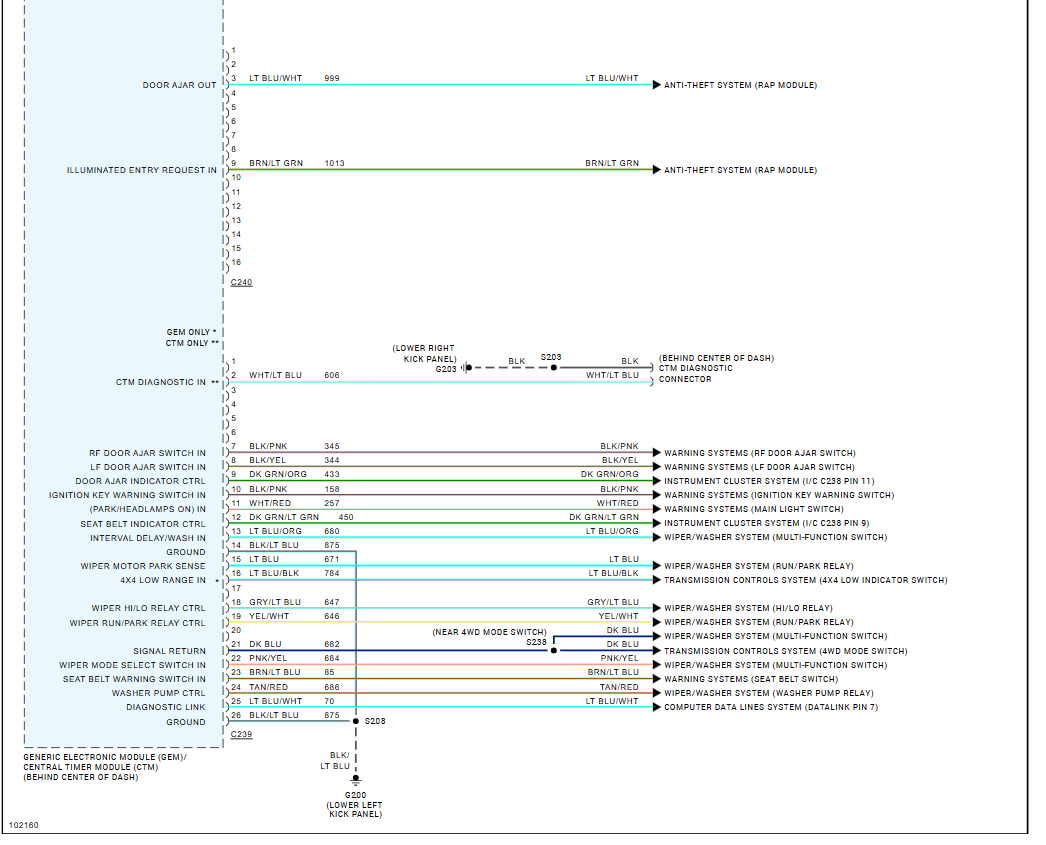

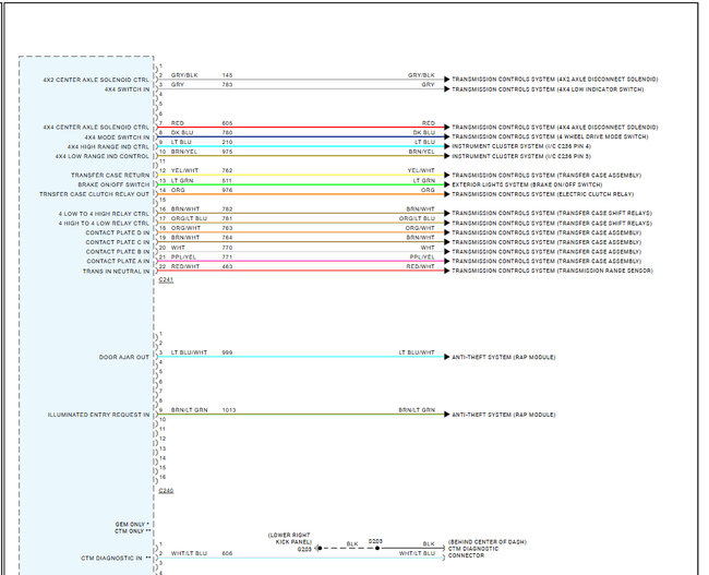

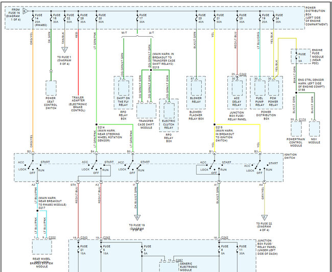

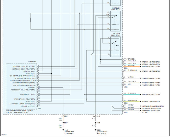

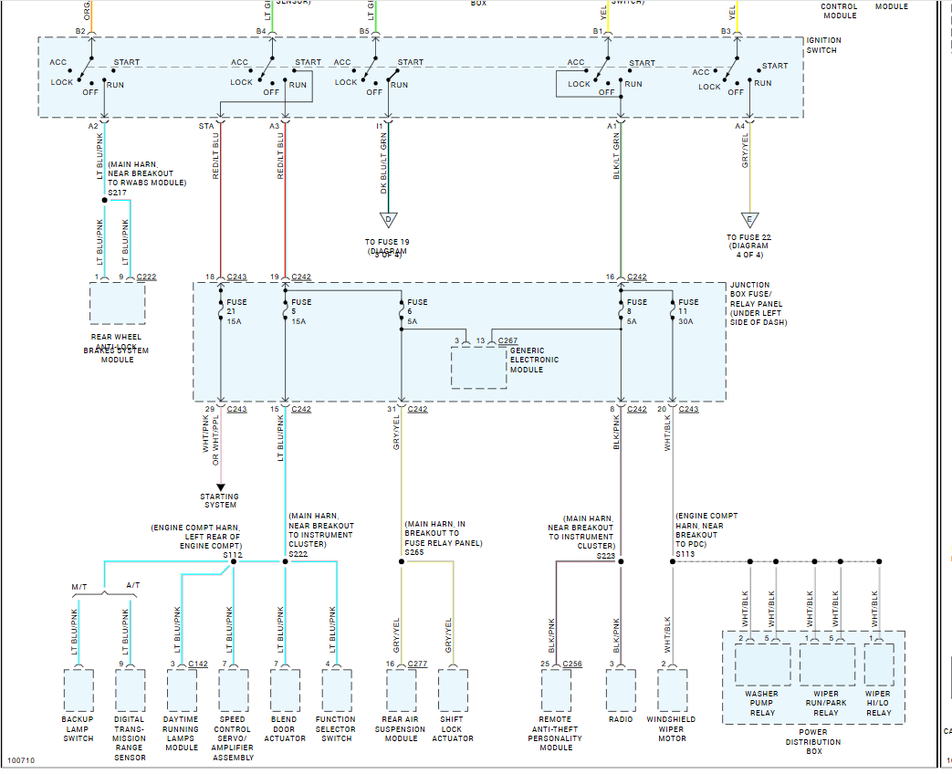

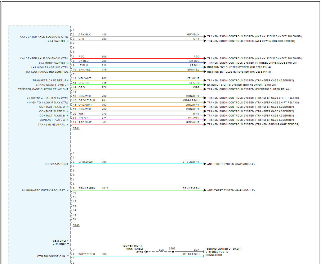

There are 3 main fuses that run the ignition switch which you can see from the wiring diagrams below. Also, I have seen the GEM go out and cause problems like this as well. Check out the images (below). Let us know how it goes.

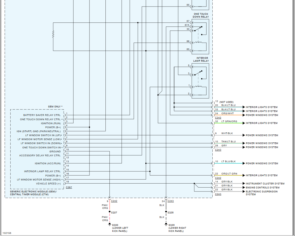

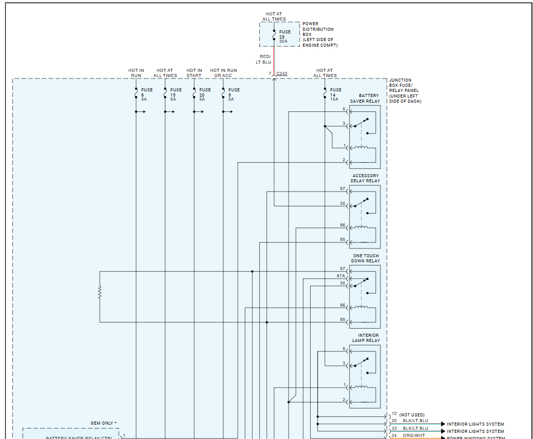

How do I tell if it's a bad gem ?
Dec 30, 2024 at 4:46 AM
  • 55,433 POSTS
You will need to test the inputs and outputs, here is a guide to help and I have included the wiring diagrams as well. Did you test through the ignition switch? The GEM should be under the dash.
Check out the images (below). Let us know what you find.

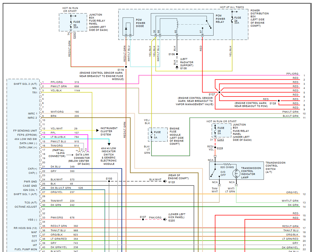

There are two main fuses and the PCM power relay that supply power to the computer, Fuse #f24 in the under hood fuse panel which should be hot at all times, and the fuse #f30 in the fuse panel inside the truck which should only have power when the key is on. I would swap out the PCM relay as well which is under the hood fuse panel as well. Please use this guide to check for power.

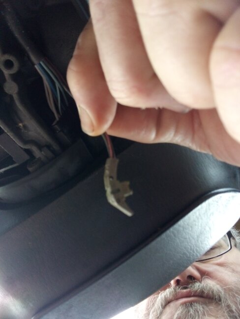

Sorry it took so long to get back to you. okay, tried switching the relays still not working, but I found this wire and don't know what it goes to, it had black tape around it.
Feb 26, 2025 at 4:59 AM
MARKD1977
  • 53 POSTS
It's black with an orange stripe.
Feb 26, 2025 at 5:00 AM
  • 55,433 POSTS
I don't know where that goes. I would go back over this post and the wiring diagrams to see where you are losing power to the PCM.

I tested the ignition switch wires , I. Getting voltage. But when I turn the key on to run I'm not getting any voltage to the PCM fuses in the interior fuse panel.
What could be causing this ?
Apr 25, 2025 at 2:24 AM
  • 55,433 POSTS
Is it fuse #f30 you are talking about? If so, this fuse gets its power from the ignition switch.
Apr 25, 2025 at 2:43 AM
MARKD1977
  • 53 POSTS
Its fuse #20 and fuse #12.
Fuse number 30 is fine.
Apr 25, 2025 at 3:07 AM

I have several times, you said that a bad gem module could cause this problem. Would it still allow everything to work? ?
But I have noticed that the driver's window won't go down, it just clicks. Does the gem control the window?
Apr 28, 2025 at 4:20 AM
MARKD1977
  • 53 POSTS
Can you please tell me what the symptoms of a bad gem module would be?
