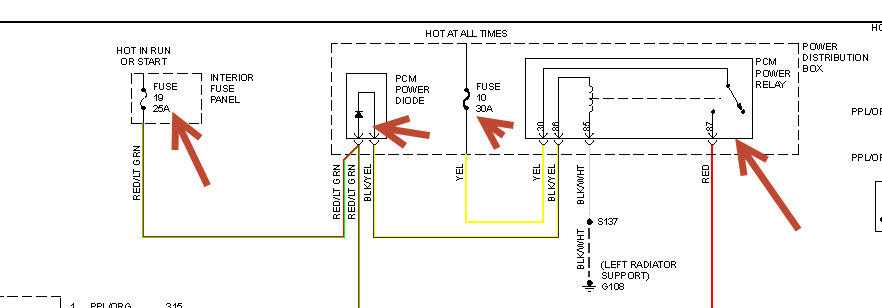

PCM loses memory overnight but is fine during the day.
1998 FORD EXPLORER
213,000 MILES
SCOTTHILLSPA
My 98 explorer has a problem of not being ready for the emissions test.
Every morning when I start it, it's acting as if it's re-learning the engine all over again, rough idle etc.
I checked the fuses in the power distribution box and their all good.
It's fine all day long, but if it sits more than 8 hours then it's back to square one again, the morning routine of letting the pcm learn the engine all over again.
I checked for any loose connections, and found nothing.
any ideas on troubleshooting the core problem? is it the pcm?
I'm running out of time on the emissions test grace period. I'm a student and I cant afford for this truck to be down...or any major repair costs...

Jul 25, 2013 at 3:44 PM
HMAC300
  • 48,601 POSTS
have the battery tested for condition and load test, not it's good cause it cranks in morning.ok what engine is in this and check the tings in pic that I have pointed out
Jul 25, 2013 at 5:37 PM
SCOTTHILLSPA
Ok, I have had the battery tested, and I also have checked all of the fuses inline.
Finally received a trouble code stating an o2 sensor was slow, could that be the cause of this problem? also it still forgets the engine over a 5 hour period on not being run.
Aug 12, 2013 at 11:44 AM
HMAC300
  • 48,601 POSTS
the O2 sensor wouldn't cause it to lose memory it may be an ecm problem if the battery and connections check ok or conections to the ecm
