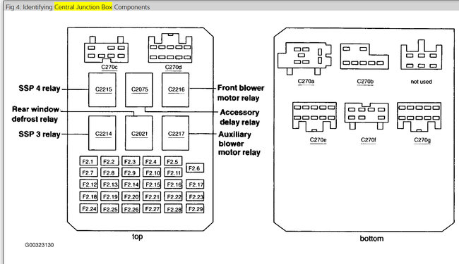

pcm is not giving any information it seems it is not connected car dose missing and shakes
Feb 6, 2016 at 8:06 AM
WRENCHTECH
  • 20,761 POSTS

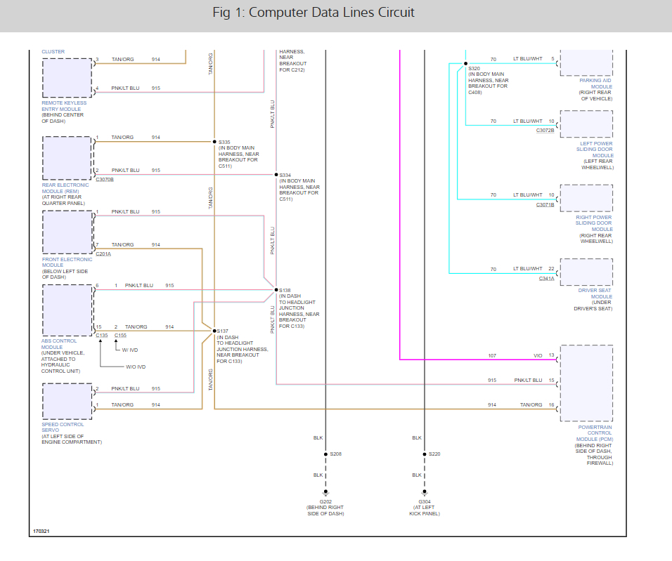

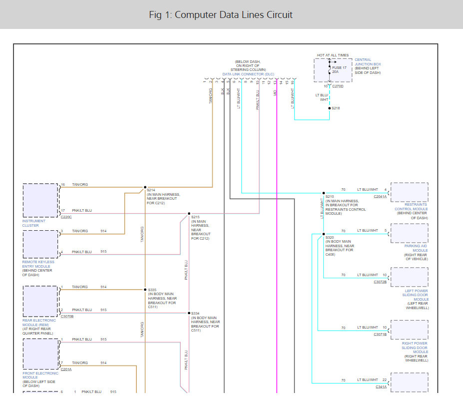

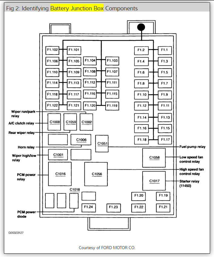

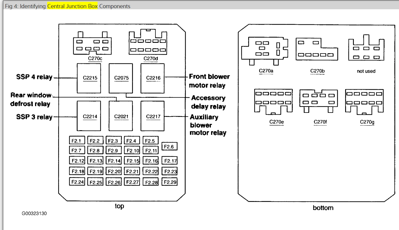

Have you checked all your fuses with a test light? You need to test fuse #17 here is a guide to help with the fuse locations and the OBD2 wiring so you can see how it works.
Check out the diagrams (Below). Please run this test and get back to us.
Jun 19, 2018 at 10:57 AM
ZAHOORQURESHI
Thank you very much for helping me. The fuse was bad all fixed thank you.
