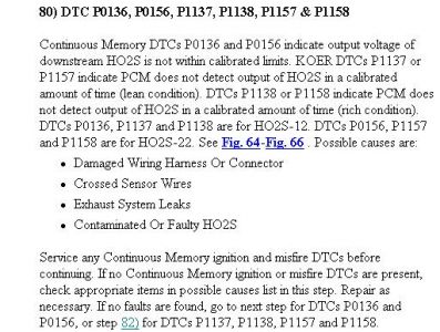

I got trouble code po136 downstream heated O2 sensor fault(Bank 1) hand it replaced and one month latter my check engin light is back on and i checked andit reads PO136. what would be the problem?
Mar 3, 2009 at 10:59 PM
ZACKMAN
  • CAR REPAIR CONTRIBUTOR
  • 4,202 POSTS
P0136 deals with the circuit, not necessarily the sensor itself.
https://images.2carpros.com/forum/automotive_pictures/55316_01windstarp0136_1.jpg
