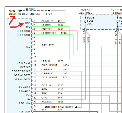

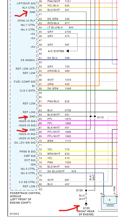

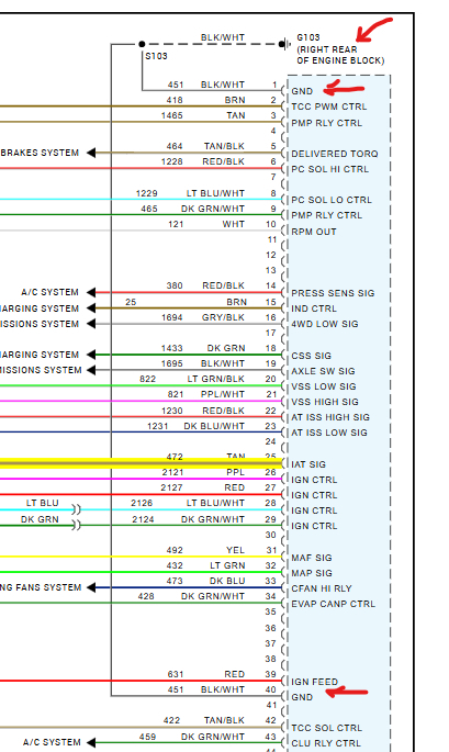

What kind of issue are you having? Also here are the PCM ground locations for the PCM and their location in the car as well. There are several grounds all looks like they are at the right rear of the engine block. Check out the images (below). Let us know how it goes
