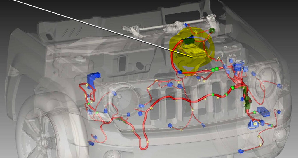

I am attempting to replace my PCM/ECM/ECU myself and I am having difficulty with the location of the module. Any idea where I can find it? I can supply the VIN if that helps.
Aug 21, 2023 at 10:04 AM
  • 110,244 POSTS
The PCM is located on the air filter housing. See pic 1.

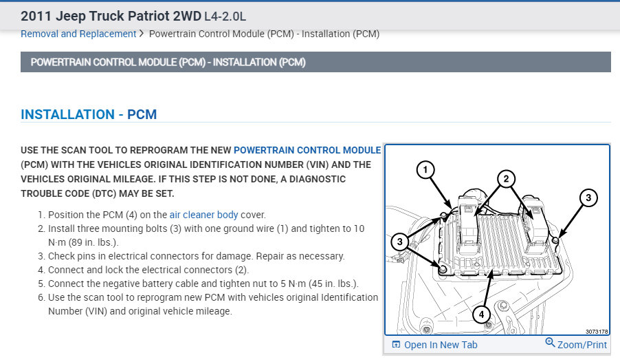

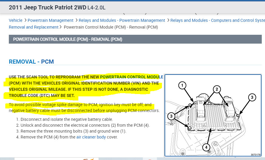

The remaining pictures are for the removal and replacement of the component. Note that this needs to be programmed for your vehicle. It will require a scan tool with the proper software to do this.
