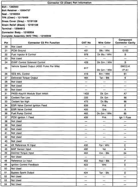

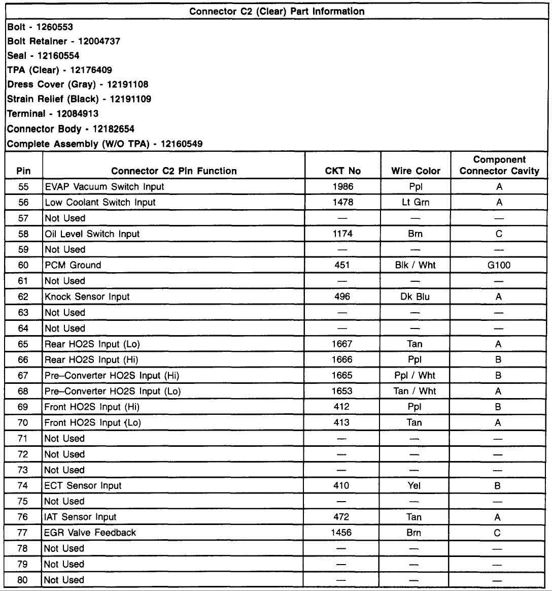

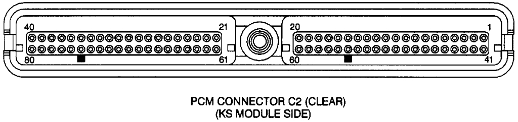

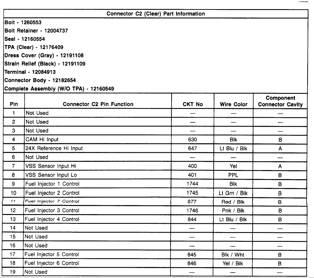

Hi, I have the c1 connector diagram you have posted. Can you supply me with the c2 connector diagram? Thanks, mikebida

Here are the pin outs. Hope they help.

Yes it is exactly what I am was looking for. Thank you
