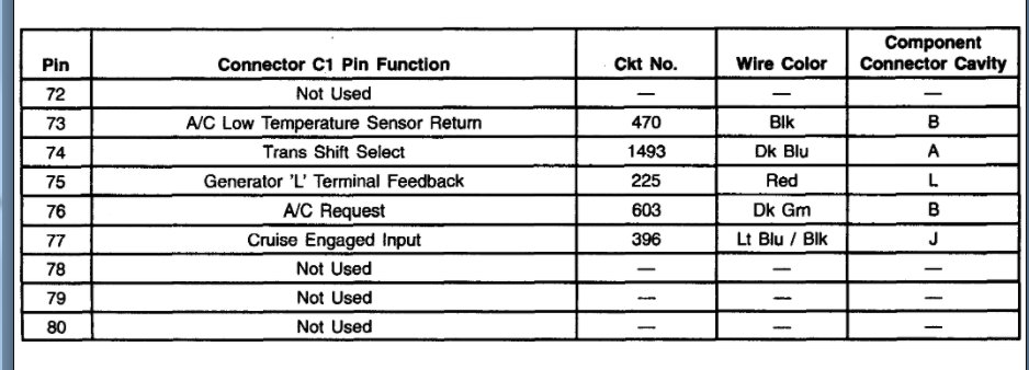

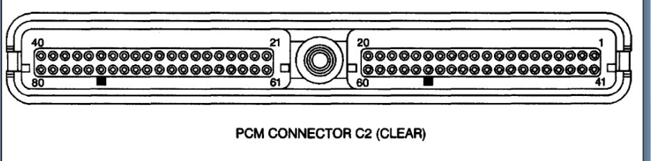

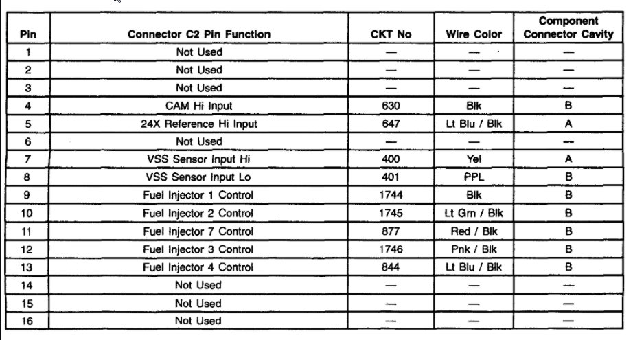

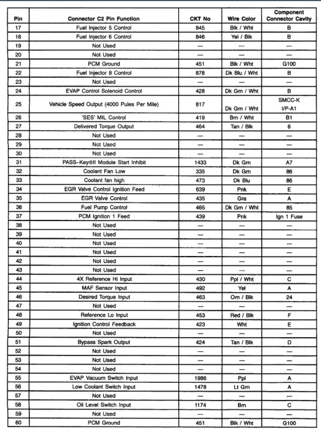

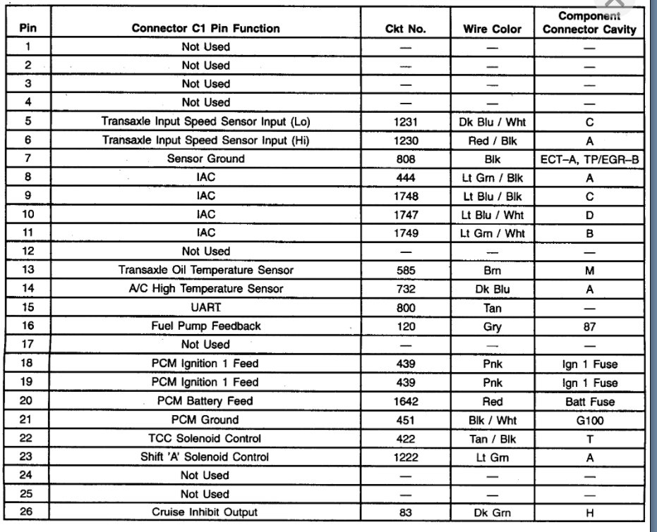

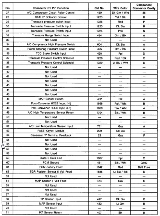

I need the pcm pinout diagram for both sides..
Nov 7, 2020 at 10:57 AM
Attached are the pinouts for the PCM. Let us know if you need more info. Thanks
