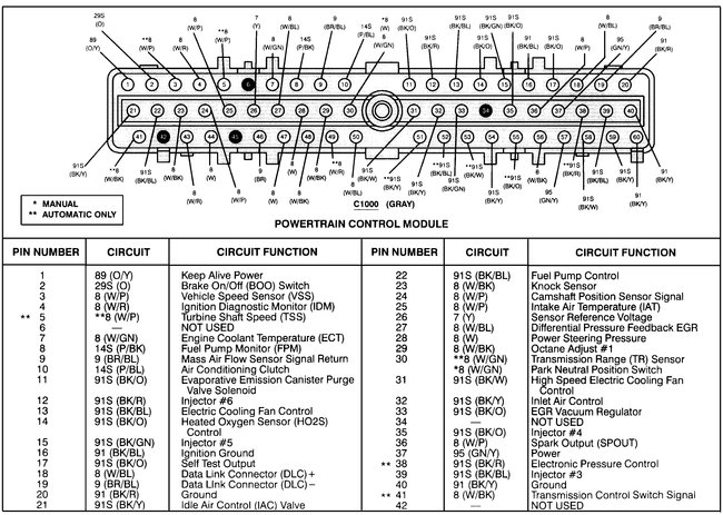

I need a picture of the PCM/ECM connector with a list of what terminal does what or goes where.

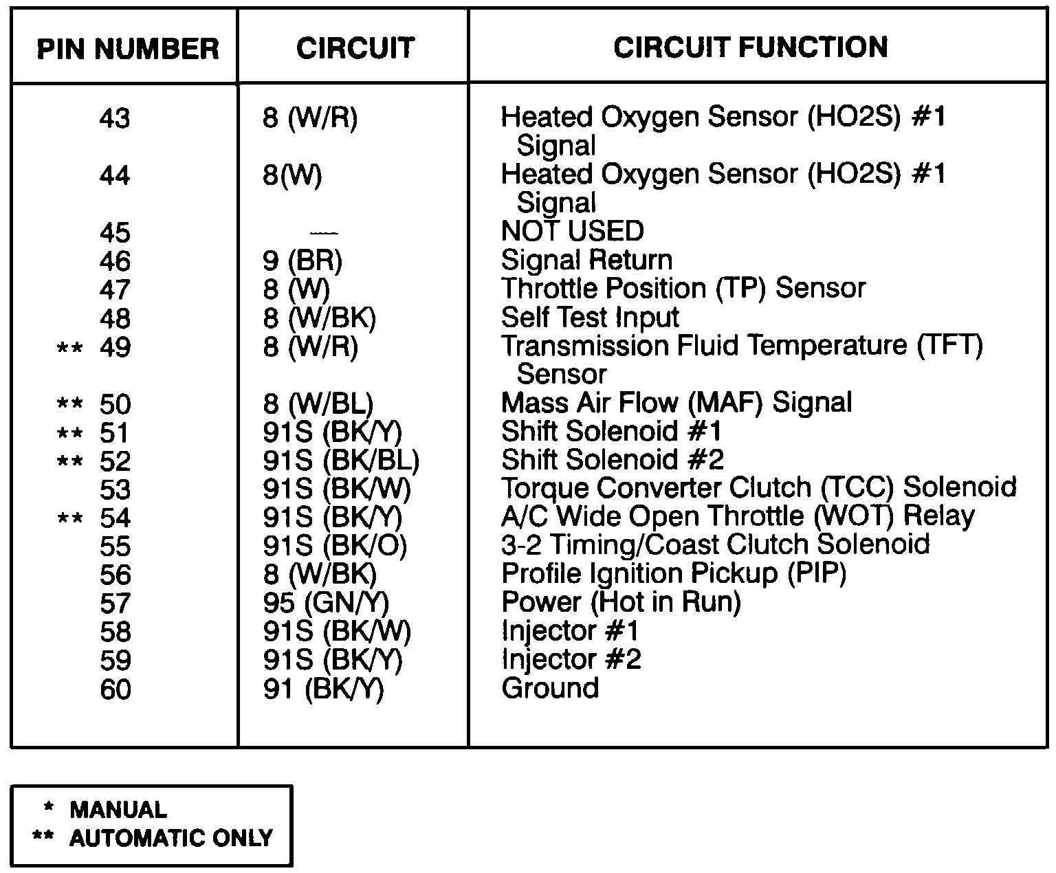

Hello, I'm Harry. I'm attaching the images that you need. They are directly from AllData, so the information should be good. Out of curiosity, what are you troubleshooting?

I'm actually working on a Mystique but it's the same thing. In the winter, I'm in Florida and I have a 1995 that I had to rewire the whole drive train due to insulation turning to dust. Last January I got the engine running but the transmission doesn't shift right so the wiring or the PCM is not correct. I bought the car in 1997 and it ran well until a heavy rain stopped it a couple of years ago. That's when I discovered the bad wiring.
I'm now in NH for the summer and I have a newer connector but from a 2.0 4 cylinder Contour. So I want to get it ready by opening up the extra contact holes to accommodate the 6 cylinder. I tried to find the proper used connector with pigtails but so far no luck.

No, the car is at my home in Florida and I am now in New Hampshire until this coming December. However, I'm still looking for a used PCM harness connector with pigtails.

My suggestion would be to go to the local "u pull it" place and see if you can find one.
Or maybe try www.car-part.com. Find a yard with the PCM and call them. Tell them you'll buy it if they'll send the harness too. Might work.
