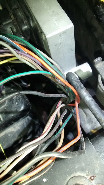

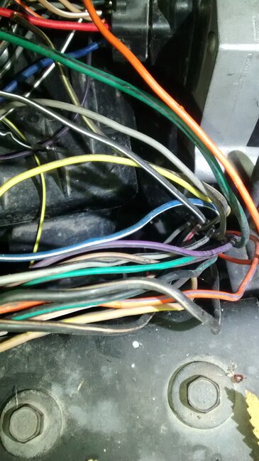

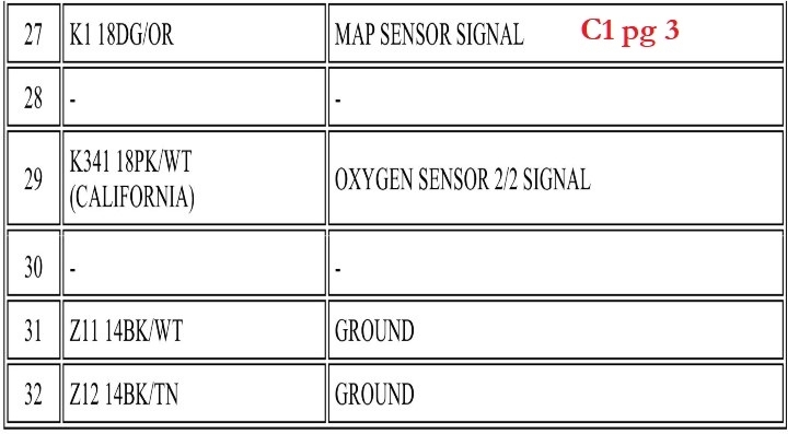

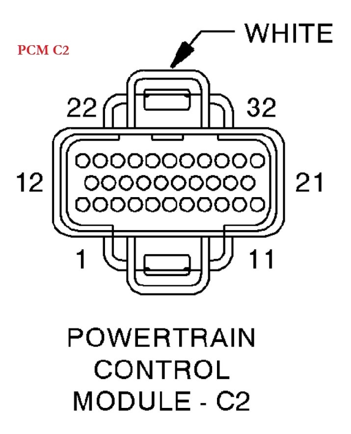

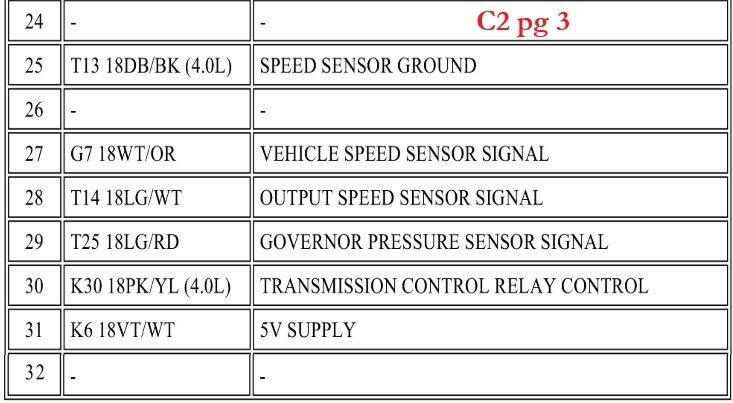

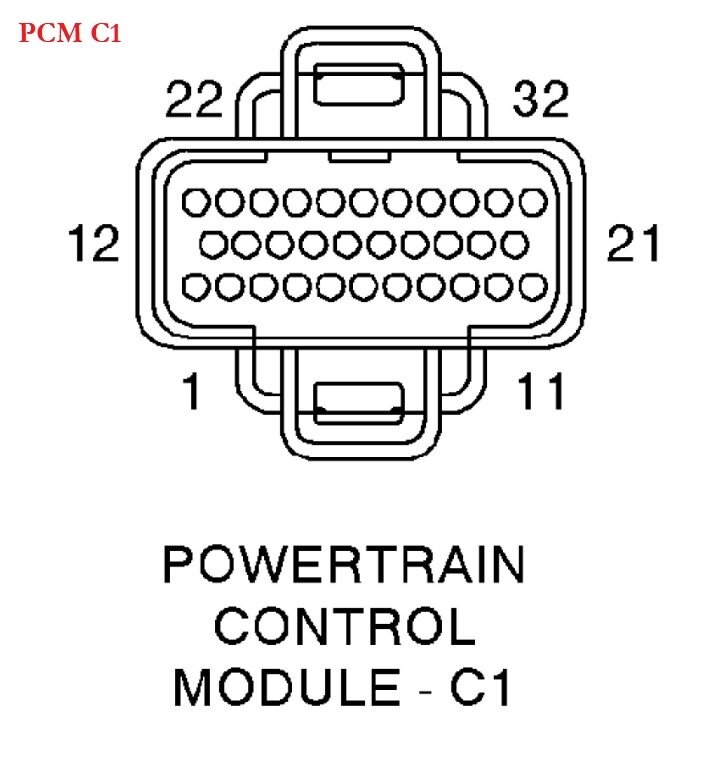

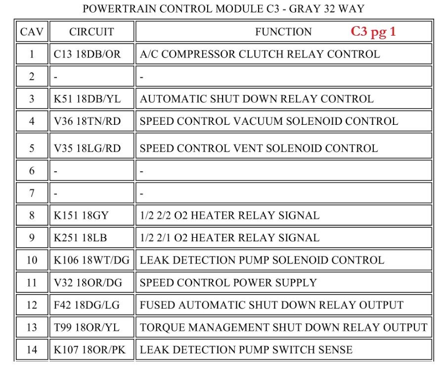

I have a 1999 jeep Cherokee sport 4x4 4.0. Someone cut my wife's wire harness and took I think c3 plug I can't find out what wire goes on each pin. She can't go to work.

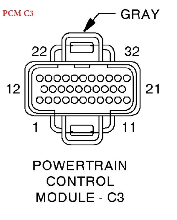

Hello, Im so sorry to hear someone would do that to her vehicle. So getting right to it, the C3 looks to be a Grey color connector, and we have the pinout with the wire colors Ill post here in a few minutes for you. You have a replacement connector I assume already?

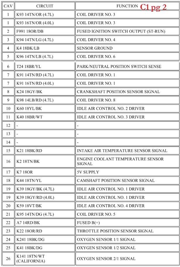

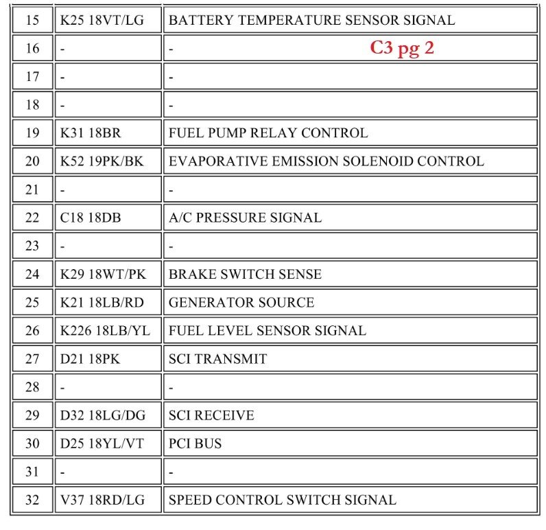

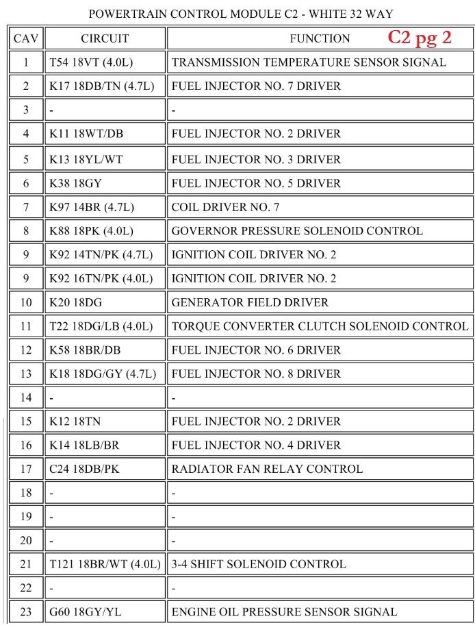

These are the PCM connector pinout diagrams, I included them all in case you need to verify wire coloring on one of the other connectors. I will post the PCM wiring diagrams next,

Its the black connector if needed I can send the Vin on the PCM

Ok sent the PCM connector diagrams, let me know you get them.

I found what looks to be the correct PCM connector, I sent the diagrams and PCM wiring diagrams. I would compare the other 2 connector wiring colors to be sure they are correct. Im not sure why this vin is the same, but the connectors and wiring colors are different
