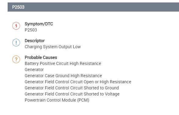

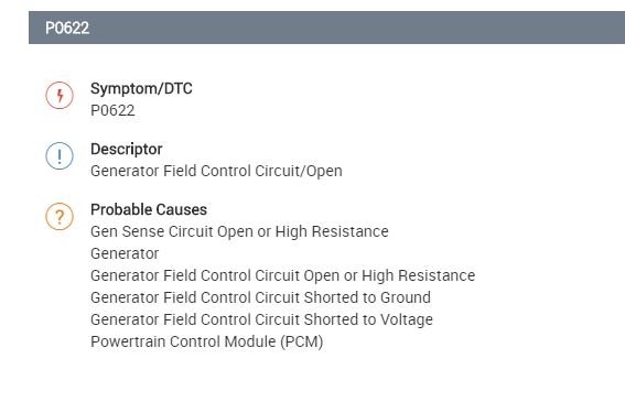

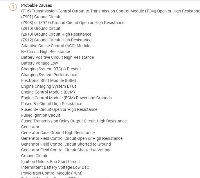

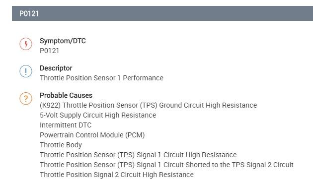

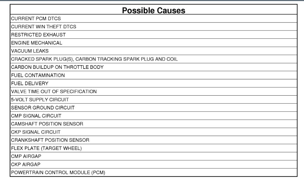

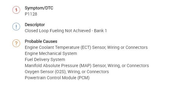

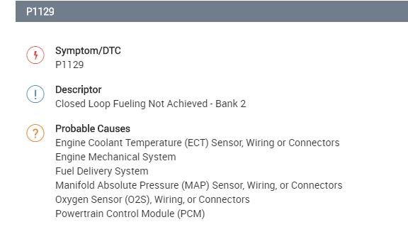

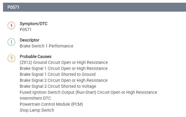

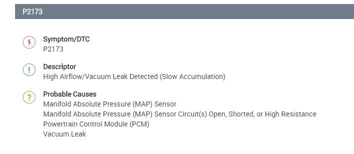

Okay, that is a lot of codes.
Try this. Clear all the codes as see what returns first.
The PCM is common to most of them but needs to be confirmed. You will need an advanced scan tool to monitor all these systems t see if they are being controlled by the PCM.
110 does not show up. Can you confirm that code?
I attached possible issues for all the codes below.

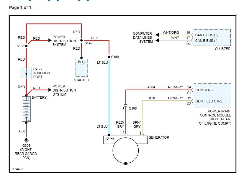

Okay. I just tested the alternator. The voltage off was 11.8. Engine running and accessories on it dropped to 11.4. I also could be the problem. I went to to test the alternator the old way and unhook the negative terminal while car was running. I read that if done on newer cars that it could short out the PCM.
Feb 3, 2020 at 12:13 AM
Okay, that never was and never will be a test for the alternator. You cannot remove the cable with the engine running. You will damage electronics with that move.
The alternators require battery voltage to operate. By removing the cable, it will never work.

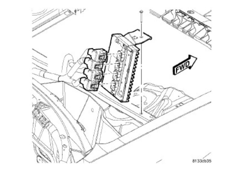

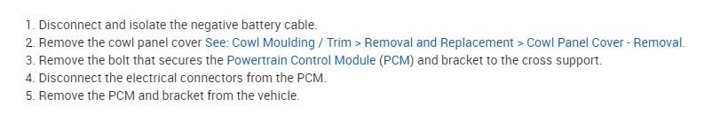

So would you say the alternator or PCM?
Feb 3, 2020 at 2:37 AM
With all the issues you have, I would say the PCM.
