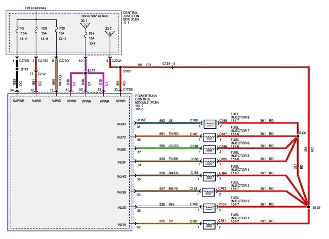

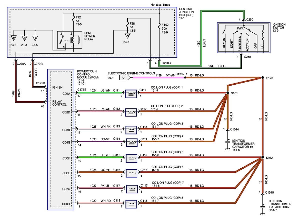

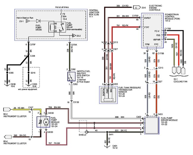

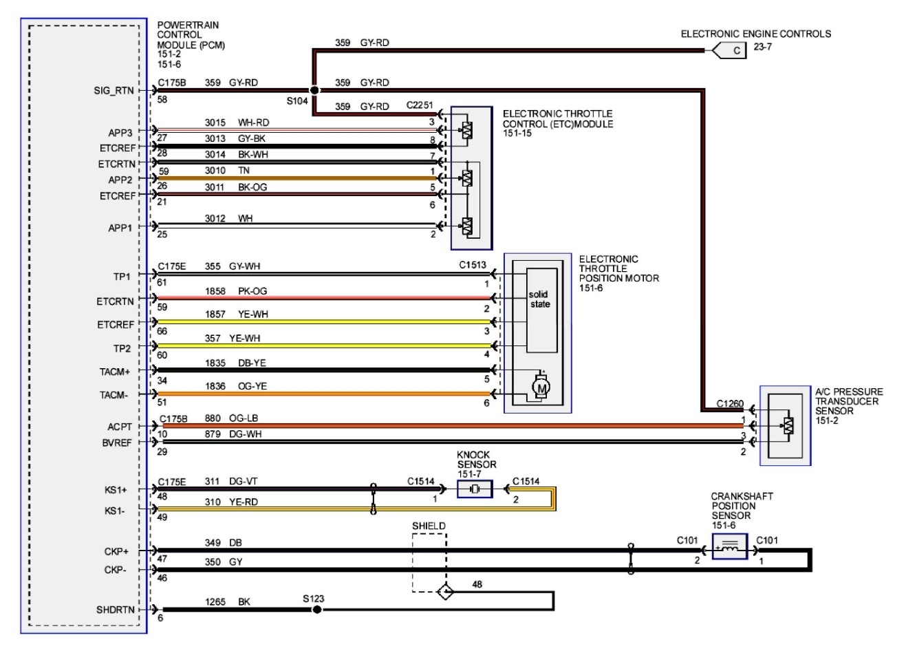

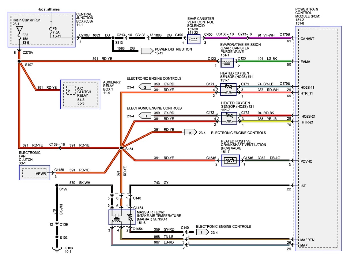

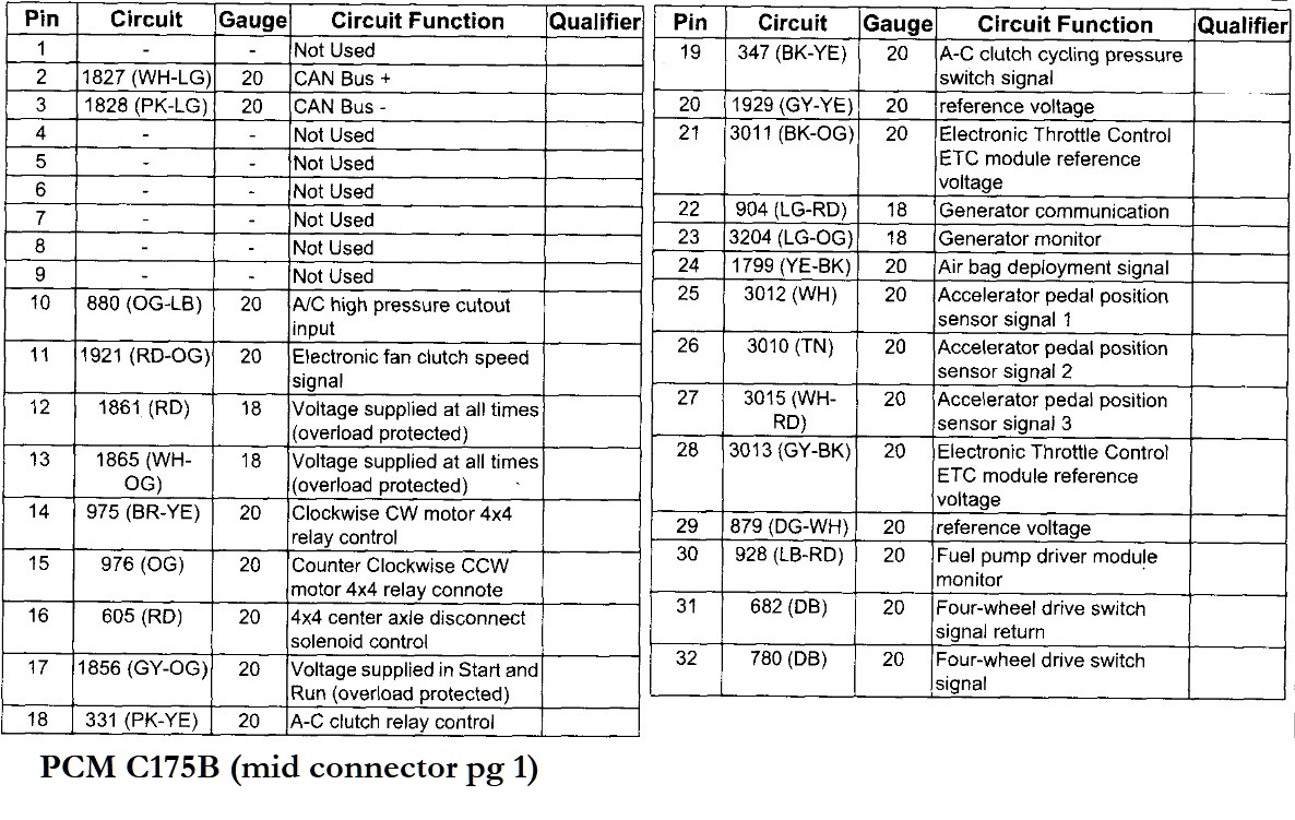

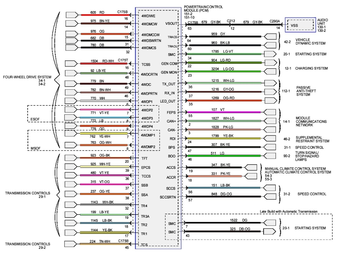

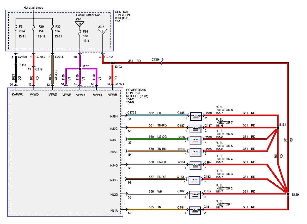

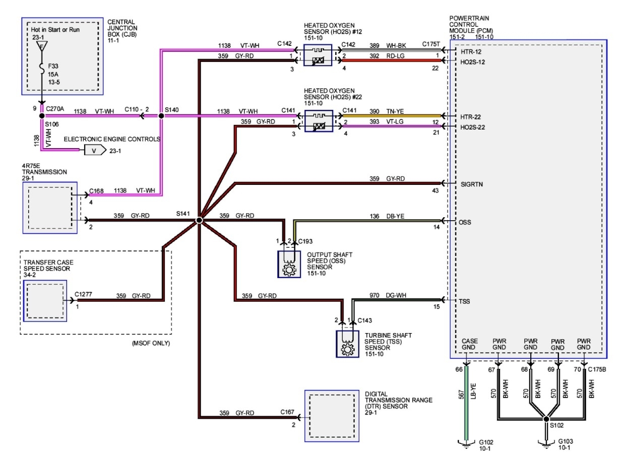

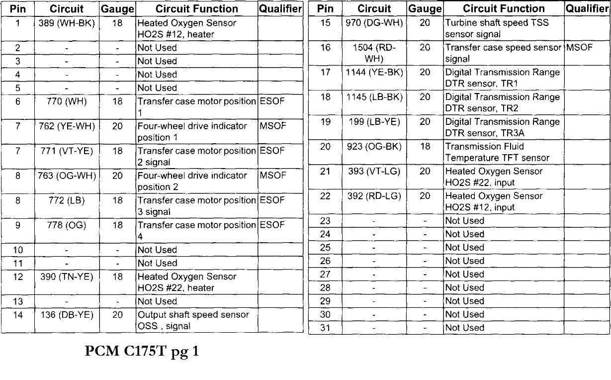

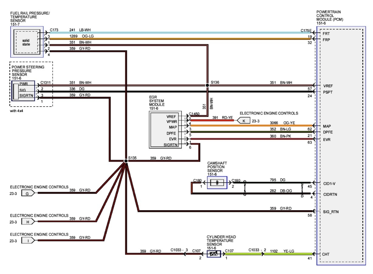

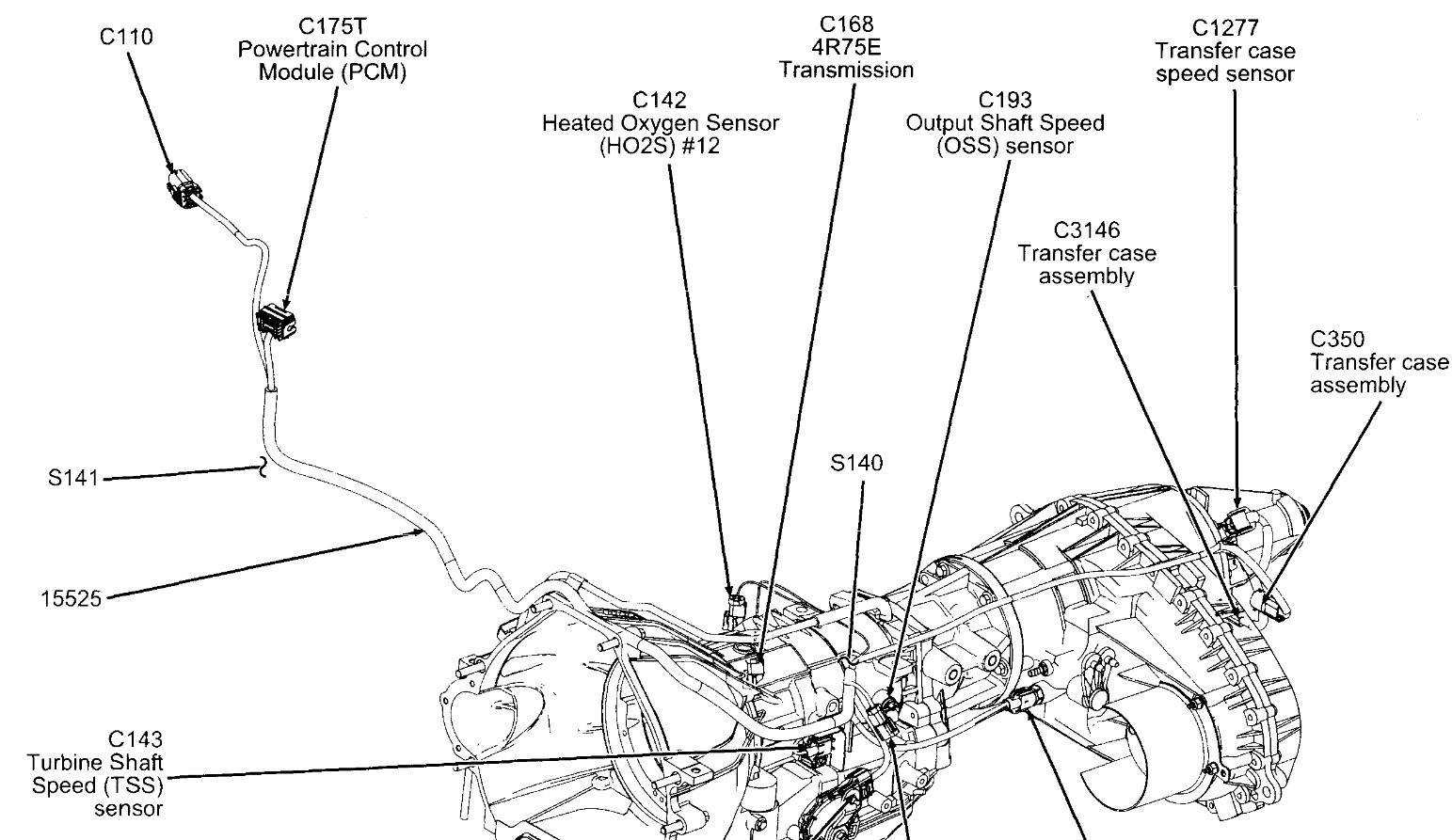

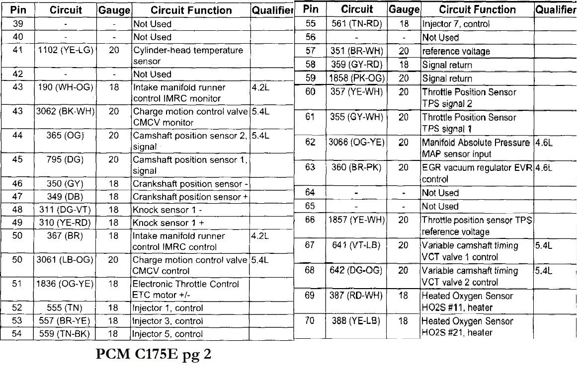

Could I get a diagram of the PCM wiring out to the engine sensors?
2007 FORD F-150
260,000 MILES • 4.6L • V8 • 2WD • AUTOMATIC
DANIELR
  • 26 POSTS
IE; MAF, fuel rail pressure sensor, etc.
Oct 24, 2024 at 12:43 PM
AL514
  • 5,639 POSTS
Hello, yes, we can get that ready for you in a few minutes.
Oct 24, 2024 at 11:17 PM
AL514
  • 5,639 POSTS

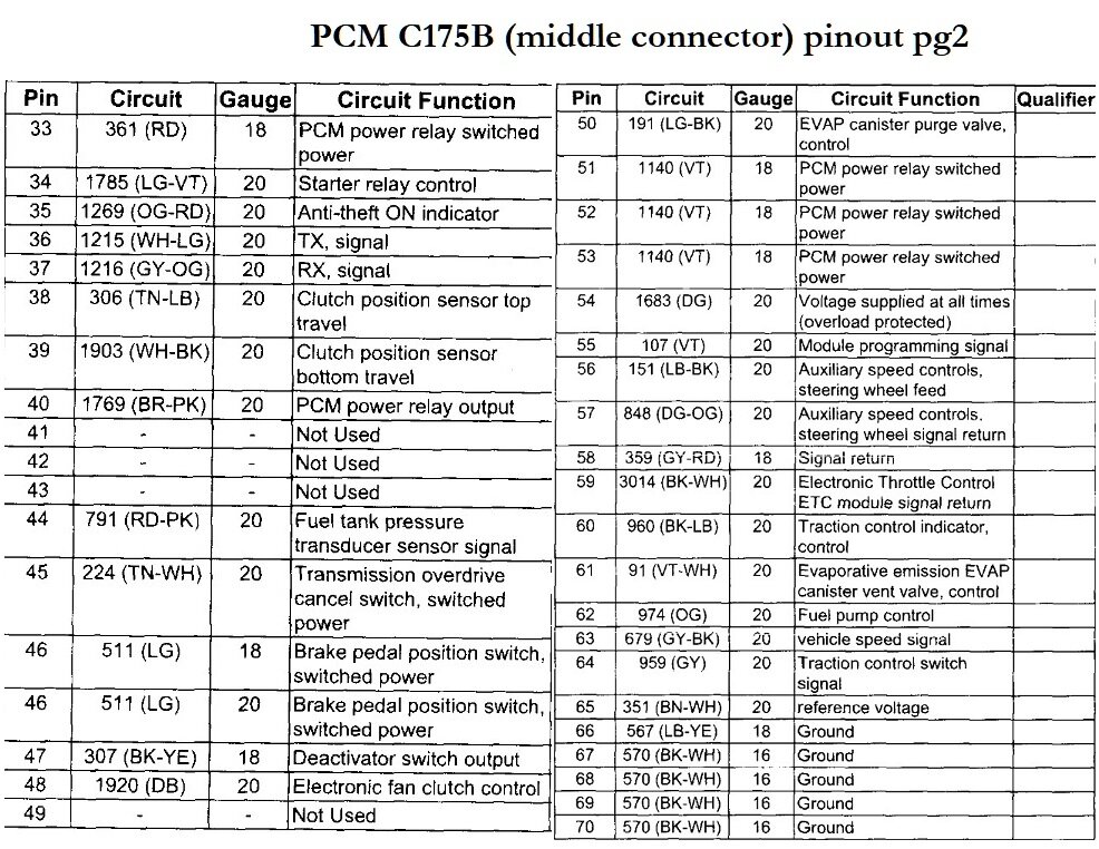

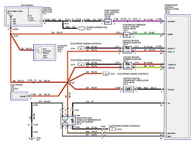

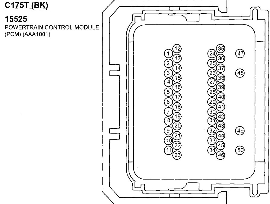

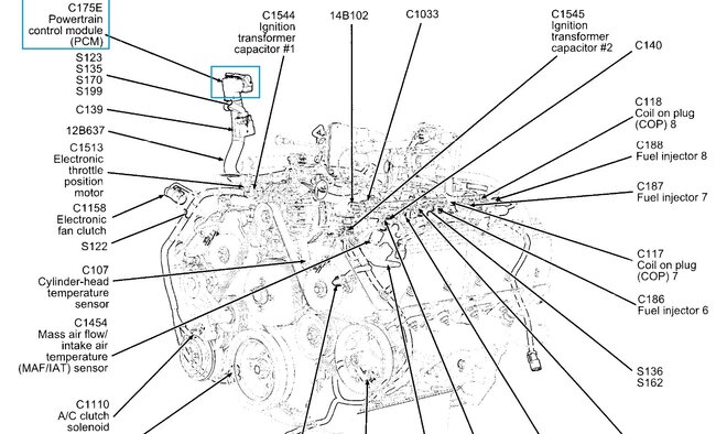

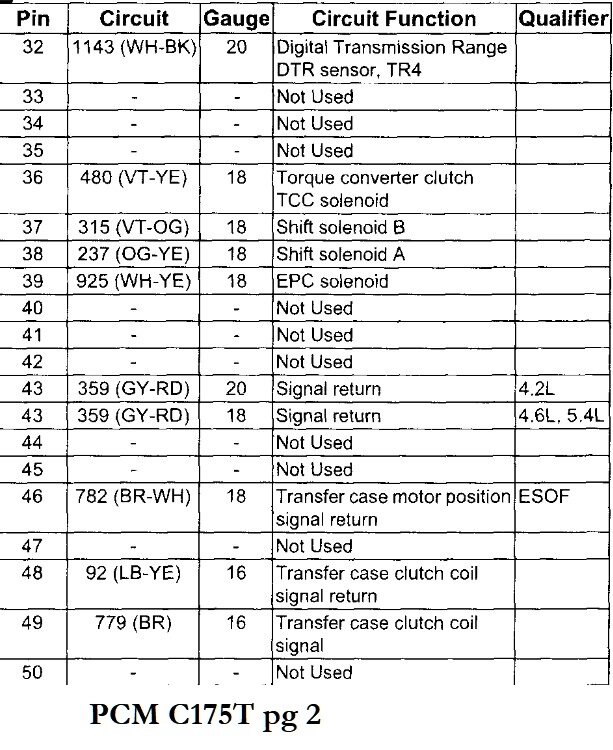

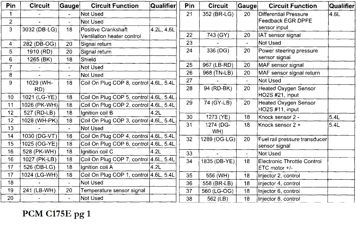

These are the OEM Ford PCM diagrams, do you need the PCM connector pinout diagrams to go along with this?
Oct 24, 2024 at 11:26 PM
AL514
  • 5,639 POSTS

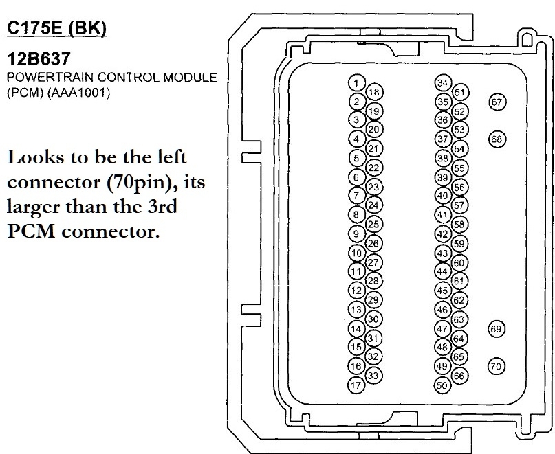

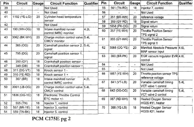

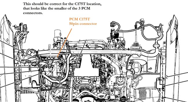

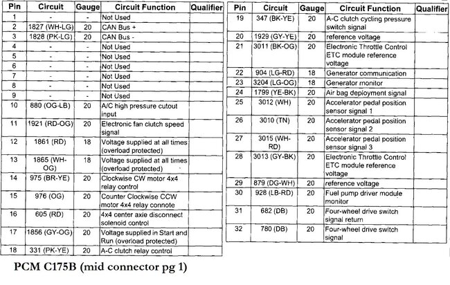

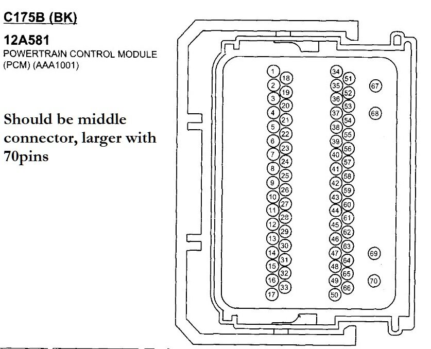

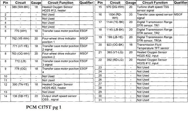

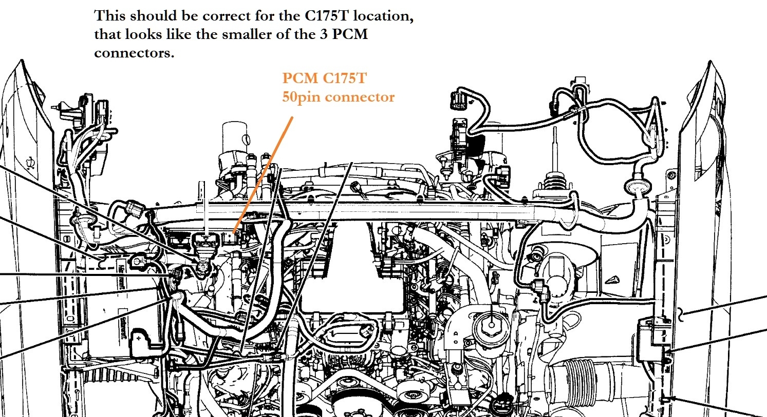

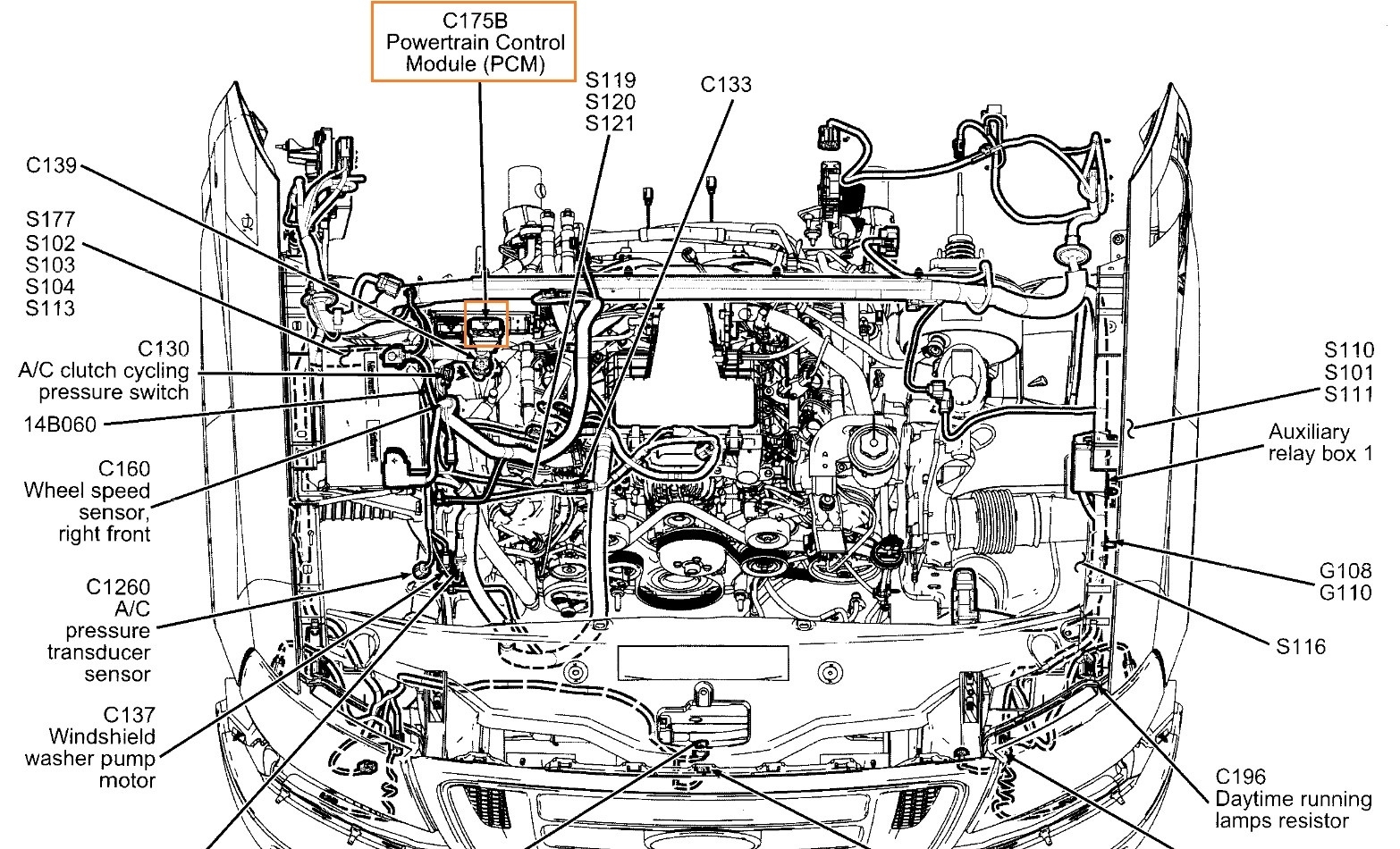

These are all 3 PCM connector pinouts and hopefully the correct location on the PCM as well if needed. But try to go by wire color and location in each connector to be sure.
