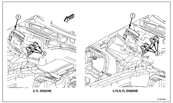

I'm trying to figure out where the PCM is located so I can change it out.

What kind of problem are you trying to solve? If you need to read the diagnostic fault codes, that has to be done before you remove memory power by disconnecting the battery or unplugging the computer. Once that is done, that valuable information will be lost.
The computer is just in front of the right hood hinge.
