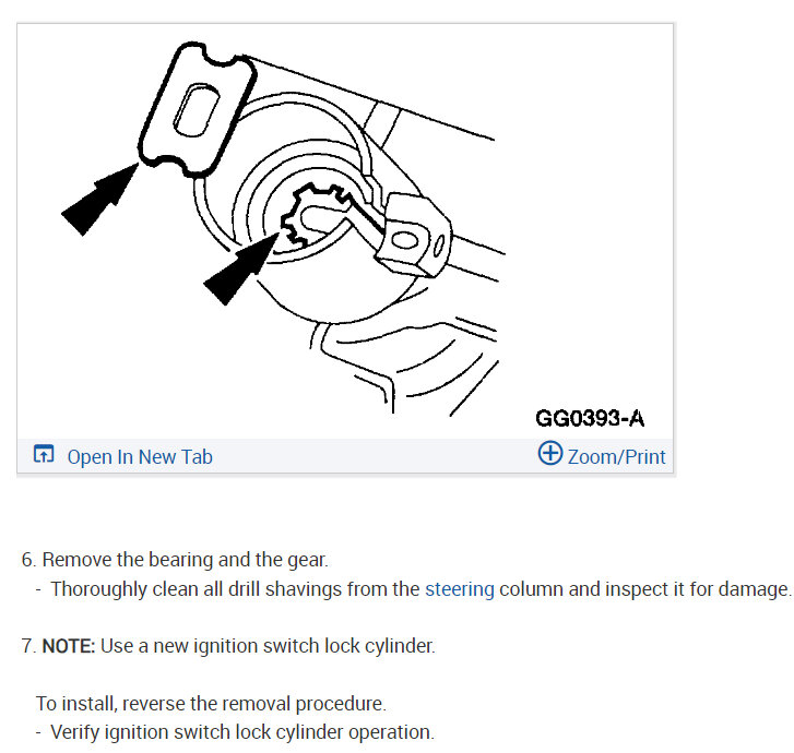

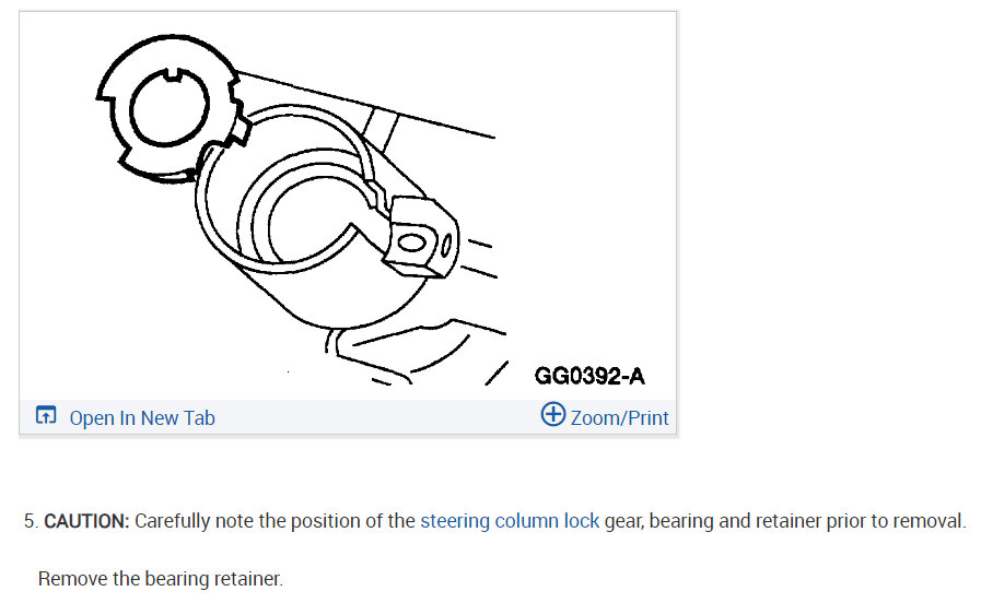

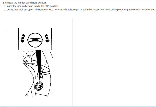

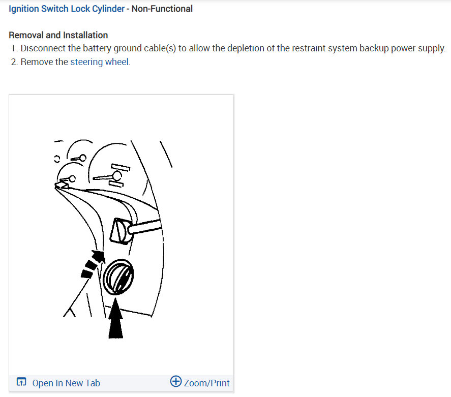

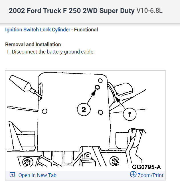

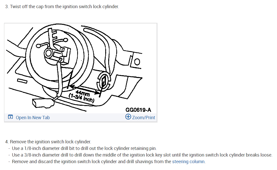

Unfortunately, the Ford Passive Anti-Theft System (PATS) is quite robust and simply replacing the key cylinder with new keys will not resolve the issue. You can have a mobile locksmith come out to do the job/program the ignition key it should cost about $250.00. Here is how to replace the lock cylinder correctly for both functional and nonfunctional situations. Check out the images (below). Please let us know what happens.
