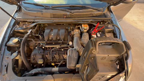

Bought a 14 Taurus a few months ago that’s given me nothing but problems. Finally broke down and bought an entire new motor after continuous problems making the car non operational. Just got the new motor in and now the car is showing codes for the PATS system. A mobile key service came out to reprogram keys and said the user interface with there software keeps stopping the program instead of completing the process. They’ve said the PCM and BCM need resynced and the car will deny essentially anything other than a Ford technician. Related lights on the dash are “start system error” however the starter will jump across and turn the car. With the keys being out of program the car will not start instead just goes in too theft mode. How do i get past this

The description sounds like the battery was disconnected long enough that one of the modules "went stupid" and it lost the coding that they use to verify the security protocol. The dealership can access it and reprogram the VIN into the modules and then add the keys back in. OR if you plan to keep it a while and maybe have other Ford or Mazda vehicles you may want to look into FORScan and the dongle they recommend, it is software that you run on a windows computer that in the licensed version gives you the ability to do more than the dealer machines will do and coding is something it will do. Pricewise it is VERY reasonable for a DIYer, the downside is that it only works with Ford and Mazda and systems based on their control modules. However it makes pretty much every other scan tool look bad on the makes it covers.

At this time we already utilize FORScan. Unfortunately it seems as though we have to have basically forscan premium to be able to code and program keys. As of yet we have not been able to do it with the software we’re using and the upgraded forscan software is close to $2000 from what I’ve seen. I’m assuming the best option them would be to just send it to a dealership?

Took the car too the shop that passes my “less than legal” vehicles for a state inspection. One of the fellas there has the full version of FORScan and was able to resync the PCM and BCM. After that he was able to reprogram the keys from FORScan. I went to crank the car with high hopes and it’s now having starter issues. Starter would crank and quickly kill the car. Put a new starter and battery in the and now the starter won’t even crank. Sounds like I have more gremlins and I’ll be chasing wire.

You did hear that engine run prior to install? What did the engine come out of? If it turns over that hard with a good battery and a jump pack I would verify the wiring to the starter and battery first, a bad cable could be causing a loss of amperage, Might try using jumper cables from the block to battery negative as a test of the ground side. I would also check the accessories by taking the drive belt off. Maybe something is bound up and causing a drag. You say it had problems before, what was it doing then?
