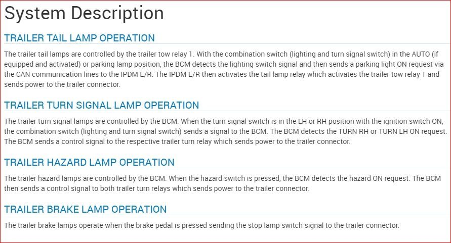

I installed a trailer hitch and bought an OEM wiring kit which I installed as instructed. The tester I've used on it shows that it is working, but the car now sometimes won't respond to giving it gas or it over revs from a complete stop. Wondering if there is electronics being used when applying gas that could somehow be affected by wiring of the hitch.
Apr 29, 2019 at 4:08 AM
Hi Jim,

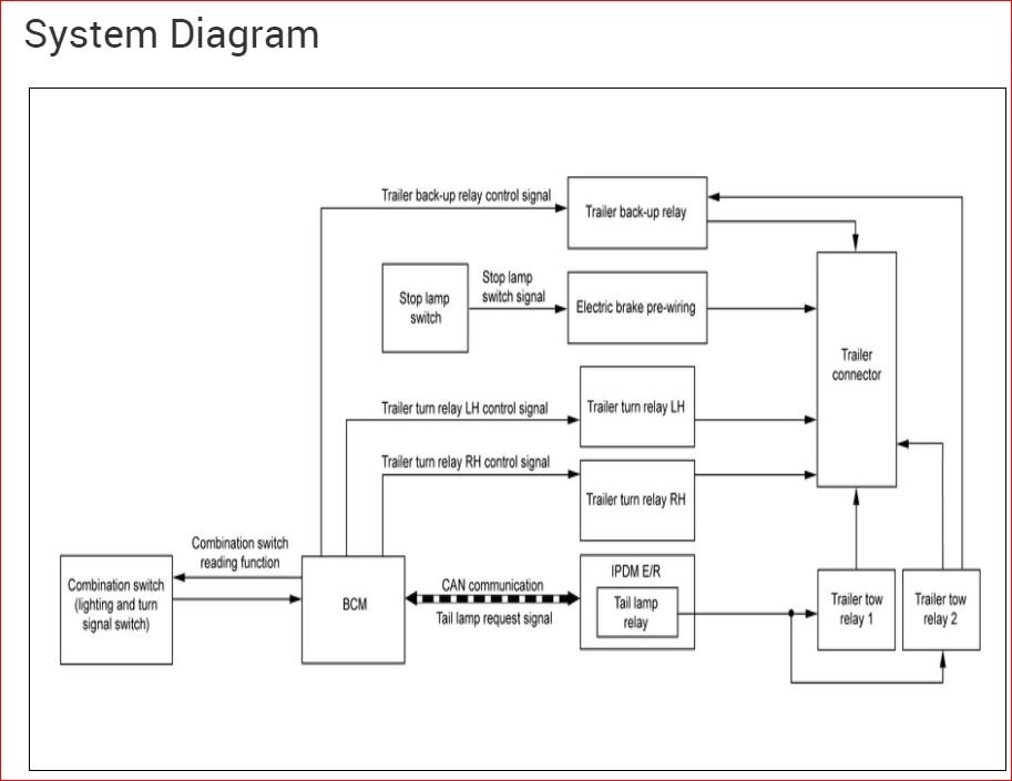

I included the description and operation of the OEM trailer tow which is basically what you have because the hitch is just a hitch but the wiring is what is important. Does this issue happen when towing, not towing, both?
As you will see this is purely just lighting circuits and they don't tie into any operation of the accelerator. This ties into the body controller which is like the brains of the vehicle so I guess it could be possible but I would highly doubt it.
Something you could do is, just unhook the connectors that you installed and not remove the wiring harness completely, just unhook it so that it is not operational any more and see if the issue goes away. This is not conclusive but at least it will give you a variable that you are changing.
