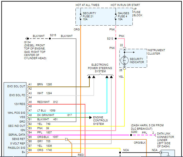

I'm just wanting to remove the whole system from my vehicle. I need to know how to do that because dealing with the dealership is a joke when they tell me the prices they are wanting to charge me for a vehicle that is 22 years old with no retaining value. So is this possible? I am a mediocre mechanic with basic to intermittent electrical skills and work for a company that's main focus is electrical. just need to know what is integrated into it and if i can just completely remove the system or if I'm going to have to rewire the whole system. Thank you

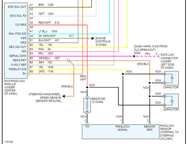

I've attached the anti-theft wiring diagram you asked about. I've cut the picture in half so you can view larger and attached below. Hope this helps and let me know if you have any further questions on this issue. Thanks for using 2CarPros.
