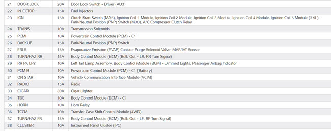

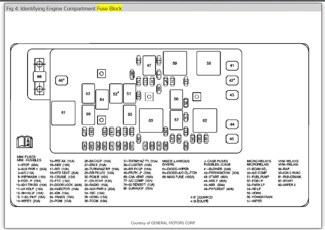

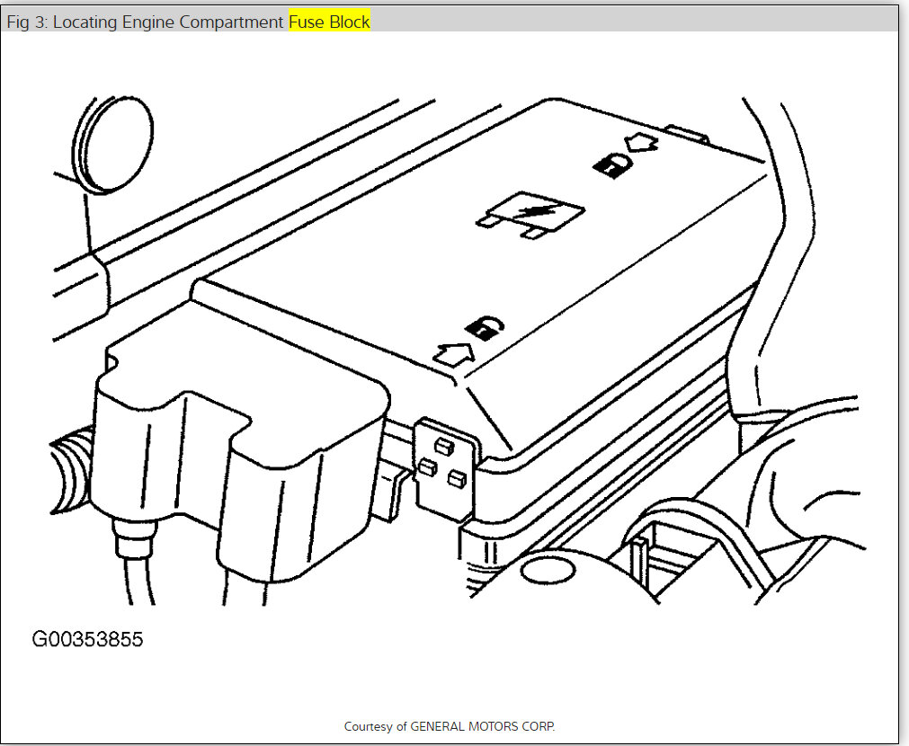

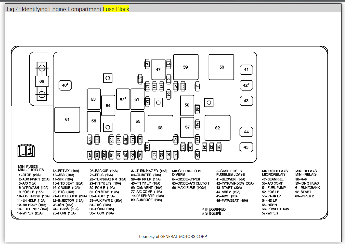

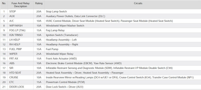

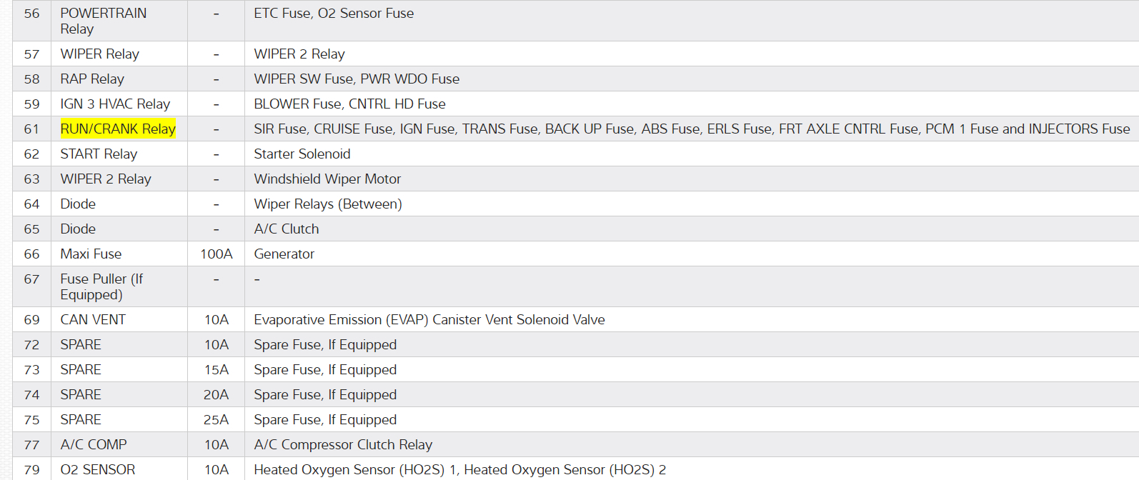

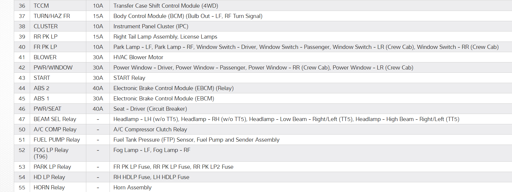

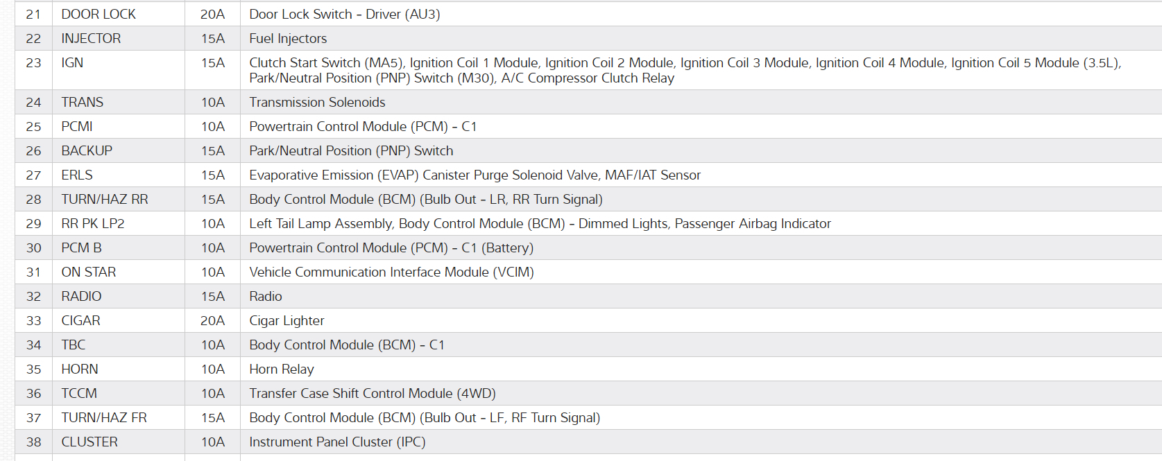

I need to see a photo of a fuse box so I can see which way the relays are positioned in the box, also I have a Pass Lock on my dash, and it won't even crank over. Please help me!
Apr 14, 2023 at 8:18 AM
  • 55,721 POSTS
Sure, here are the relay and fuse ID in the images below and I have included guides to help you test the relays and fuses.
and
Check out the images (below). Please let us know what happens. Also, this guide can help reset the pass lock.
https://www.2carpros.com/articles/how-to-reset-a-security-system
