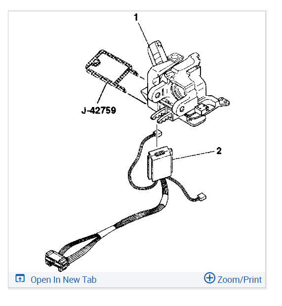

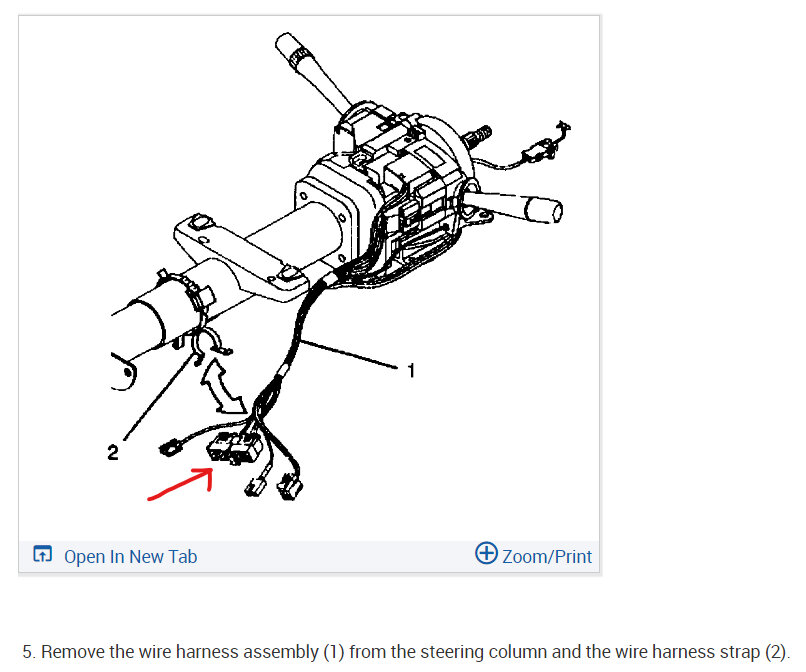

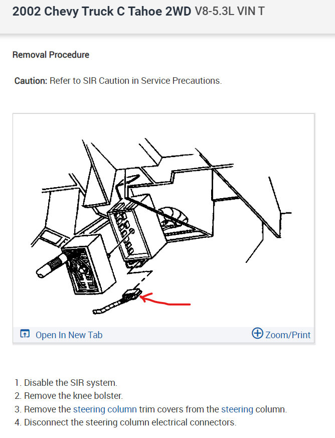

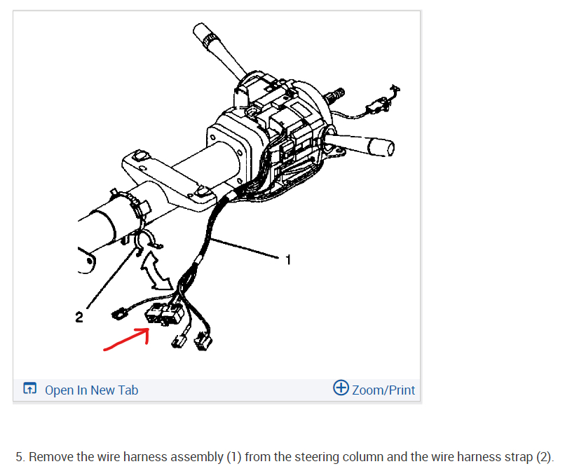

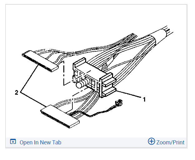

My boyfriend replaced the turn signal switch on steering column. Now it won't start.
Mar 27, 2024 at 12:38 AM
  • 55,673 POSTS
Can I ask if the security light is flashing when you try to crank the engine over? If not, then the pass lock has not been activated. If so, you can try a hard system reboot which will clear the systems and allow them to reboot.
Here are two guides that can help:
https://www.2carpros.com/articles/step-by-step-guide-performing-a-hard-system-reboot-for-your-vehicles-electronics-systems
and
https://www.2carpros.com/articles/how-to-reset-a-security-system
Also, I would make sure the ignition switch is still plugged in, which can sometimes come undone when doing the turn signal switch. Check out the images (below). Please let us know what happens.
