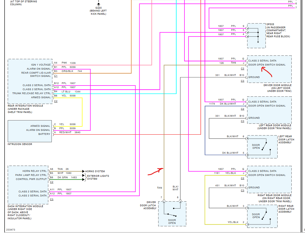

Passlock 3 tan wire cut on the immobilizer?
2006 CADILLAC CTS
3.6L • AUTOMATIC
MICHAEL7492
MEMBER
2 POSTS
Have a tan wire cut on the immobilizer and a red/white from harness cut. Need to know where they go
Jul 21, 2026 at 11:36 AM
Experienced Mechanic
55,743 POSTS
I have marked the tan wire from the Passlock system for you. Check out the images (below). Let me know if you need anything.
