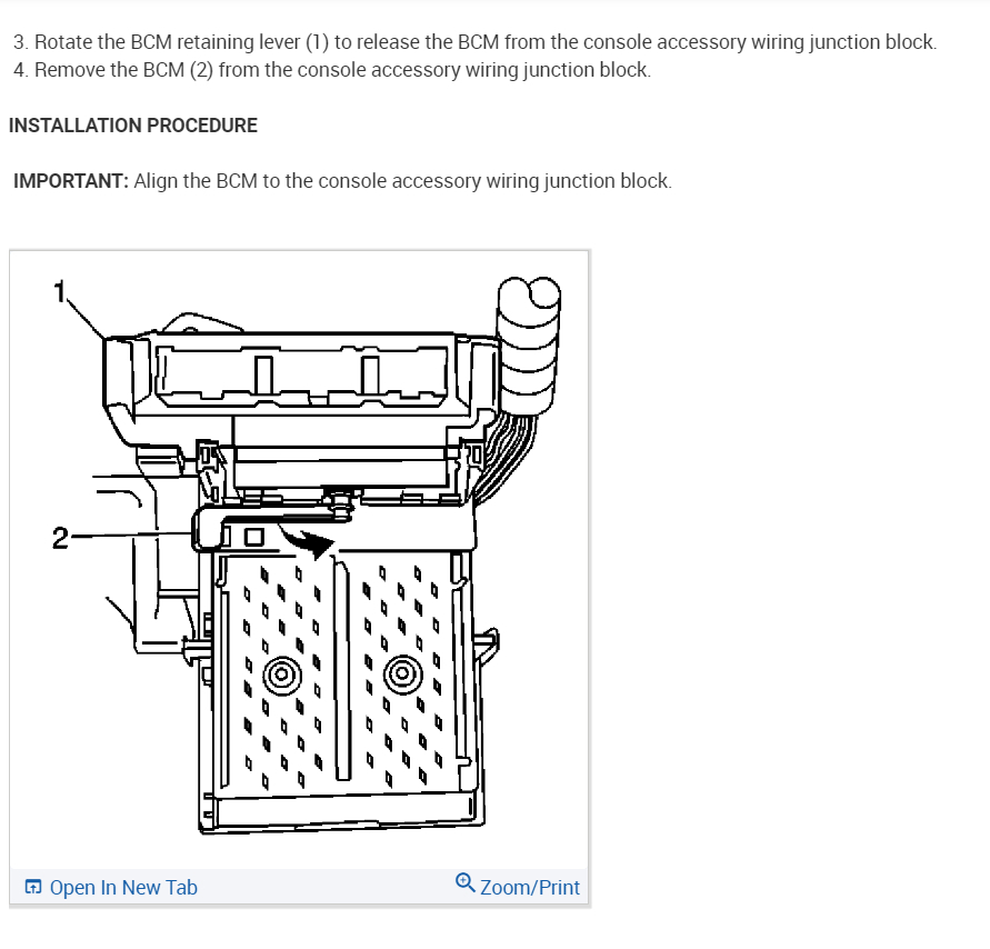

Has anyone found a solution on how to disable the GM Passkey-III (3) Anti-theft system, which uses a transponder inside the head of the ignition key? This system is annoying, and prone to failure. Has anyone figured out a way to troubleshoot it, or to Hack a Body control module, or the Anti-theft system in a GM car, like a 2004 Buick Rendezvous. Thanks. Any information is helpful.

Yes, I know, but it's also prone to Failure... I've had my car disabled, when it wouldn't recognize my key. I had to pull the battery, let the car die for 2 days, and reinstall the battery to get the damn car working again. I even tried replacing the Passkey sensor around the ignition key core. It's a pain in the rear. It's Built in Obsolescence. that's what the darn system is. And it's a poorly ass designed system.

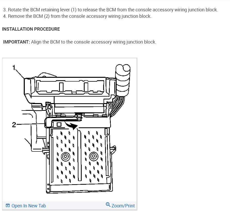

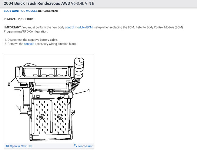

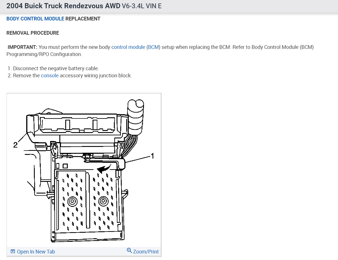

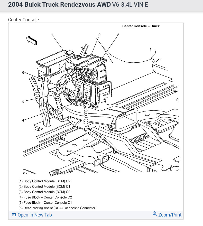

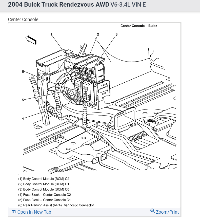

That is true, it sounds like the BCM is at fault though, have you tried a CAN scan to see what codes if any? You can get a CAN scanner (Controller Area Network) which will work on most cars from Amazon.
https://youtu.be/u-4syLc-ifQ
and
Here is one for about $99.00 if you need it:
https://amzn.to/3ZixY4v
Here is how to replace the BCM in case you need it. You can get a preprogrammed unit by searching Google or Ebay. Check out the images (below). Let us know what happens and please upload pictures or videos of the problem so we can see what's going on.
