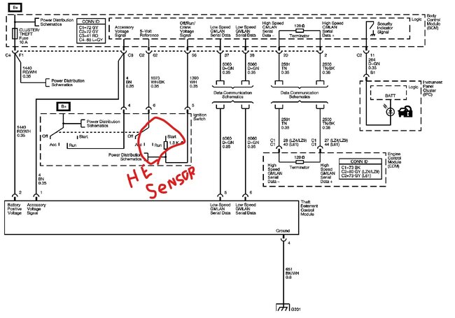

Passkey is faulty car will start with a toggle but not the key then it shuts right back off I have been told u can bypass the system with a resistor I have the resistor but can't seem to find a diagram for a 5 pin plug what wire is my data and my ground the colors area red with white stripe brown white and white with black stripe.
Sep 14, 2024 at 2:51 AM
STEVE W.
  • 15,420 POSTS

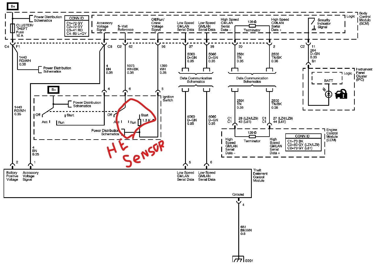

The resistor bypass only worked on the Passkey I VATS that have a resistance pellet in the key itself. The last vehicle built with it was in 2003. The Passlock VATS that your car uses has a magnet on the lock cylinder that rotates and activates a hall effect circuit that sends a signal to the ECU through the security module that tells it you have the correct key. That signal however isn't a simple resistance, instead the hall effect works like a switch and the circuit generates a specific frequency based on the resonator circuit in the hall effect. The programming steps let the system learn what "note" the sensor in your hall effect device "sings" at. When it sees that "note" on the wires it says the proper key is in use and starts the engine. However, that signal isn't always on, it is only active in the start position of the key, then in run it shuts off. The only resistor is a 1.3K that acts to lower current through the sensor. They system basically works like this - Key goes into lock, that triggers the key in lock switch that causes the chimes if the door is open and tells the ECU that there is a key. You turn the key to start and as it passes the ON/RUN position it simply wakes up the other parts of the VATS. Once you get to the START position the magnet triggers the hall effect and the signal goes through the system to the antitheft system, which confirms the signal is correct and the ECU can activate the fuel system so the engine can start. You release the key back to the ON/RUN position and the signal from the hall effect stops. This tells the security system that it is a valid key and not a false signal and the engine continues to run.
This system though has a lot more failures than the earlier system. One of the most common is for the hall effect module to fail. They can fail on or off but the result is the same, the engine will start, run a few seconds then shut off.
There are companies that sell "bypass modules" but the catch is that most don't work properly because of the way the factory system turns the signal on/off with the magnet. It isn't just the signal frequency that counts but also the time between the magnet turning the HES on and when it returns to run the amount of time between the magnetic field turning off the sensor and the switch moving into the run position. That can change depending on the sensors construction and the strength of the magnet.
Now all of that said there really isn't a simple resistor bypass with them. Instead you replace the part of the system that failed. The toggle only triggers the prime circuit which turns the pump on for 3 seconds to fill the lines, then it turns the starter which starts the engine. Without the signal from the immobilizer the pump stays off and the engine shuts off as soon as that initial prime pressure is gone.

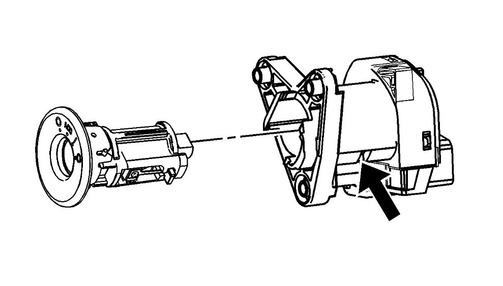

The easiest way to repair them is to replace the ignition lock cylinder housing. If you have a working key this is much easier as you won't end up with multiple keys. You would get the new lock housing, remove your existing one, use the key to release the current ignition cylinder and remove it, then swap it into the new housing. Install the new housing, do the relearn and you would be done.
I generally recommend getting a new switch from GM, there are some aftermarket ones out there but most are very poor quality electrically. You can use a used one but it's harder to program them.

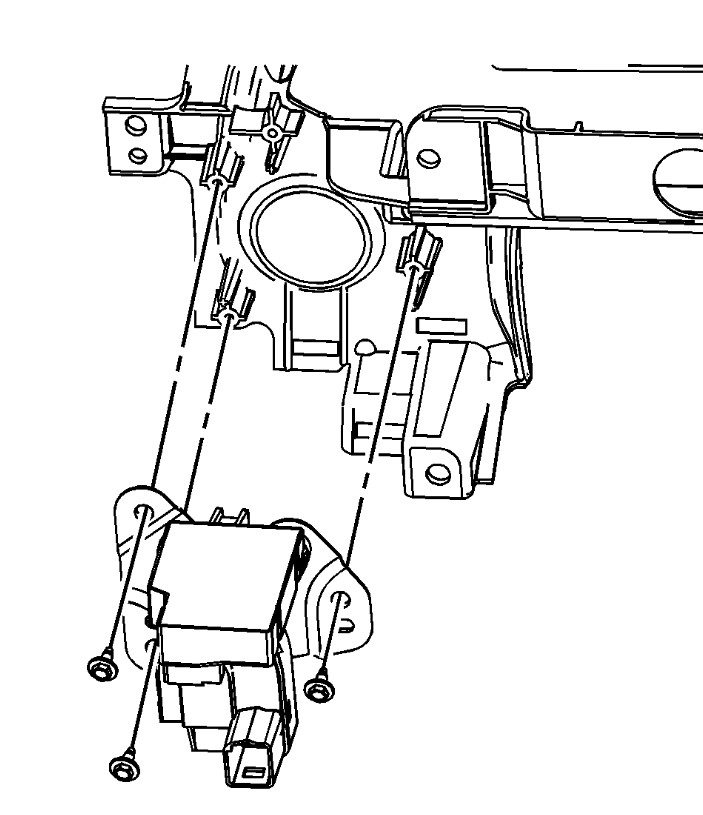

Replacing the switch itself isn't difficult it's just time. You remove the knee bolster trim under the dash, then the instrument cluster and you can get to the three bolts that hold the switch in place. Disconnect the electrical connector and remove the 3 bolts. Remove the switch.
Now with a working key, insert the key into the lock, turn it to ON/RUN and push the release tab. Remove the lock cylinder. Now repeat that process on the other cylinder. If you get a used switch with no key you can take it to a locksmith and they can remove the cylinder without damaging the housing. Now you install your cylinder in the replacement switch and bolt that switch in and connect it.
