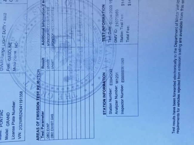

So I recently replace my battery and I need to pass smog. How long do i need to drive the car to cycle it?

I have obd evap and obd exhaust gas monitor not completed.
Feb 24, 2020 at 9:21 AM
Gas monitor? Can you post a picture of what you see? There is no gas monitor.
Feb 24, 2020 at 9:24 AM
ALEXTTT
  • 59 POSTS
Here's the photo:
Feb 24, 2020 at 9:43 AM
Okay, do the drive cycle I suggested. That should set the catalytic converter monitor.
The evap monitor will run after an 8-hour sit overnight. Start in the morning and drive it for about 5 miles and then recheck the monitor.
