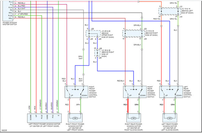

I was able to successfully replace the actuator that controls the buttons on the vehicle and remote to open the passenger sliding door.
When rolling down the passenger window, there is a funny sound when it gets to the bottom. Would you have a schematic of the door panel to determine what the problem could be? It might have gotten off track.
Apr 10, 2020 at 12:55 AM
  • 110,248 POSTS
Are you looking for a wiring schematic or something different? You referred to it as a schematic of the door panel.

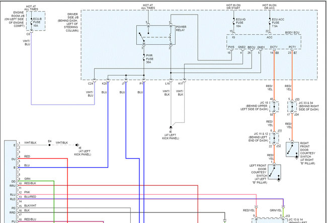

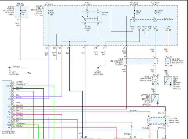

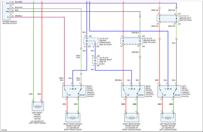

I am attaching the wiring schematic for the windows. The first two pics are for the systems with jam protection. Pictures 3 and 4 are without jam protection.
Let me know if that is what you wanted or if it is something different.
