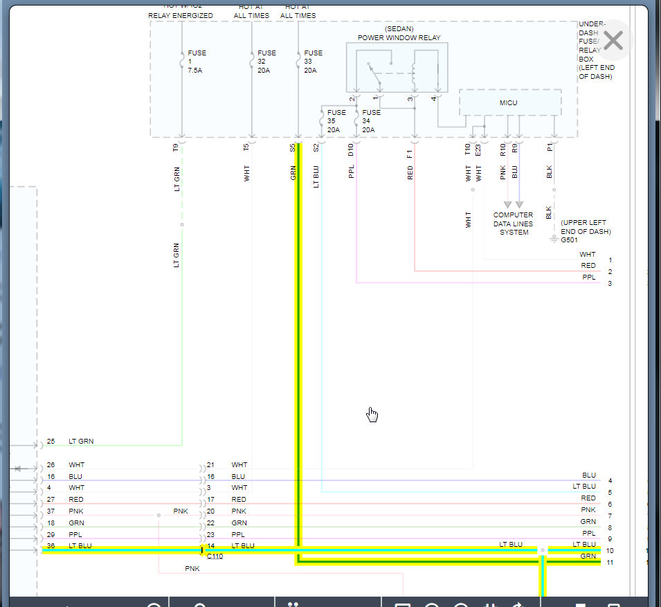

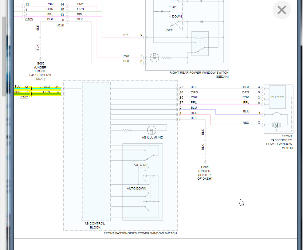

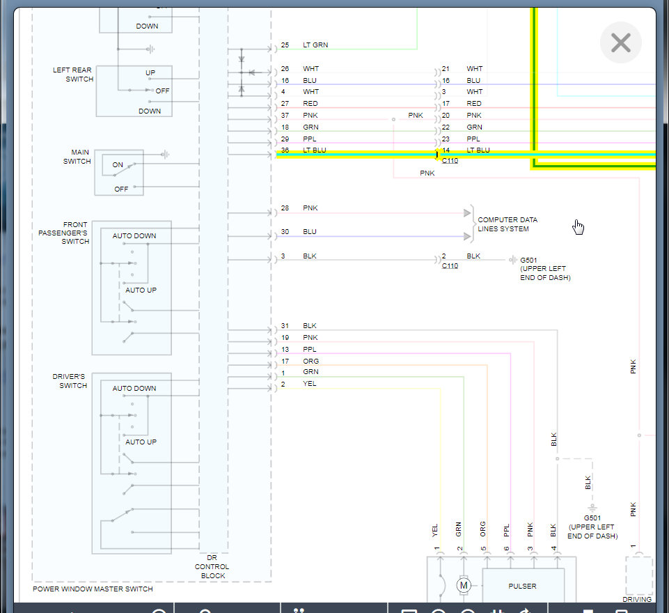

Car listed above is a Coupe. Changed both window switches (new, OEM) as well as the passenger motor/regulator assembly. Window only works from the passenger switch. No response from the driver switch (although the driver window works fine). I checked wires in the door loom, seem okay. Any thoughts?
Jan 21, 2021 at 9:53 PM
Just to be clear, the passenger window only works from the passenger switch? So the issue is the driver switch will operate the driver window just not the passenger?
If this is the case then we need to start with going to the passenger switch and operate the driver switch and check voltage on the high lighted wiring. Basically this passenger switch is a pass through for the driver switch but when you power this with the master switch the control block will operate the window using the wiring from the switch to the passenger motor.
So we need to find out if we even have power coming from the driver switch and go from there.
Let us know and we can go from there. Thanks
